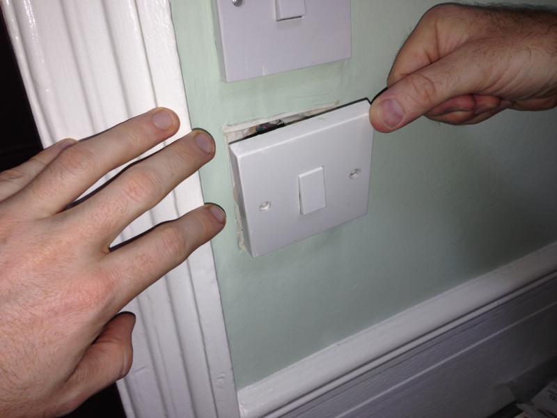

I wonder if someone could help me out this one? I'm trying to replace a damaged light switch on the landing.
The switch operates a bulb in the hallway and a bulb on the landing. There is a further switch in the hallway which operates the same bulbs

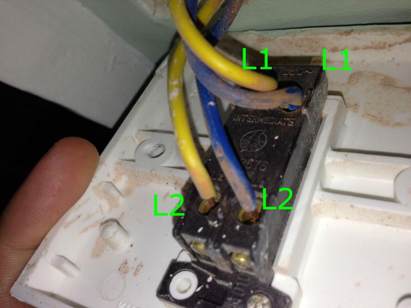

Here's the problem! The existing switch has 4 connectors marked L1, L1, L2, and L2. The replacement switch I've purchased has connectors marked L1, L2, L3 and L4. It's an "intermediate" type which I hope is correct.

Existing switch (connections are marked L1, L1, L2, L2):
New switch just purchased (connections are marked L1, L2, L3, L4):
They do use some funny markings on switches.
You will notice each WIRE emerges from CABLES.
On one cable, put one yellow in L1 and it's corresponding blue in L2
On the other cable, put the yellow in L3 and it's corresponding blue in L4.
Plan B - use your multimeter to identify which terminals are connected to which when the switches are operated.
