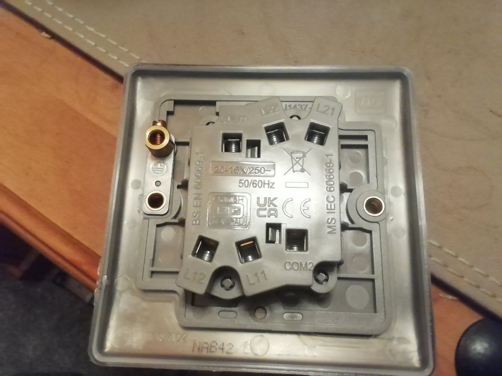

I am changing my white plastic light switches to antique brass. I took one off, ensuring everything was labelled. On the old switch both com terminals were at the top, L1 and L2 bottom. On this new one (BG). One of the switches has com at top the other com at bottom. I wired as the old, live to com and switched to L1, but it seems to be upside-down. Switch up for on, down for off. Can I just turn switch upside down, or just wire live to L1 and switched live to com, or would moving switched live to L2 do the same. (oddly L1 and L2 labelled as L11 and L12!!!!) The writing inside is the right way up....

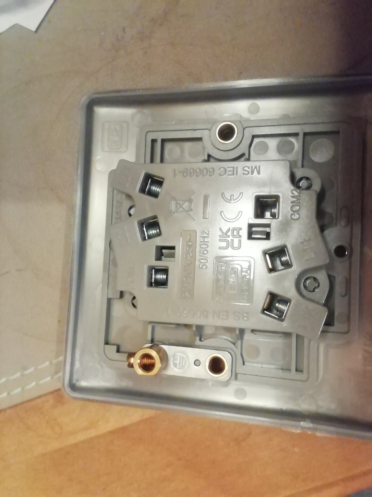

Better picture. Also both sides just 1 way switching.
Yes, if there are no marks on the face.
No, that will make no difference.
Yes, that's the way to do it.
COM1, L11 and L12 is one switch and
COM2, L21 and L22 is the other.
Move the wire from L11 to L12 and the wire from L21 to L22,

Thanks for the help. To be honest it doesn't really bother me, it's SWMBO who's bothered. I'll swap the L wires this aft. I've got another 3 to change out, so at least I know what the issue is. I've been putting a small wire from the earth terminal on the switch to the earth on the back box, but one back box is a bit tight. Is it really needed, and won't the screws provide an earth?
I see you have some dreadful BG switches.
The terminals are quite large and square shaped - you may experience wires slipping out of the terminals quite easily, or just feeling loose.
You will probably need to ensure the ends of the wires are folded over, and this may even be the case if even if you have two or so wires in a terminal.
Yes.

Normal light switches are up for off and down for on if they are used in a one way configuration .
Now then, you can use 2 way switches as 1 way switches if you want.
Some manufacturers label the terminals differently.
1/ C or Com for common and the other two as L1 & L2 - but some use L1 for 1 way switching whereas others use L2.
If its just a one gang switch you could turn it upside down and it will be in the correct orientation.
2/ Some manufacturers label them as L1 (for the common) and L2 & L3 for the other two terminals.
3/ Some manufactures put ganged switches all the same orientation (say all the Coms at the top) and some alternate them.
I think they all are labelled "top" to show you the way the manufacturer wants you to orientate them.
