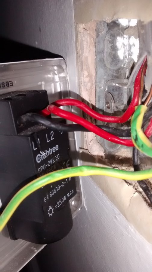

I have a standard basic white double light switch face plate, inside there are 2 switches (black boxes) 1 common port, and an L1 port and L2 port on each switch (black box)
In switch 1 (black box) I have put the mains supply red cable in the common port. I have put what I think is landing light red cable in L1 of first switch (black box) and black cable in L2 of first switch (black box). In the second switch I have put what I think is 2nd mains supply red cable into common port and then the stairs light from downstairs red cable to L1 on the second switch (black box) and the black cable to L2 on the second switch (black box).

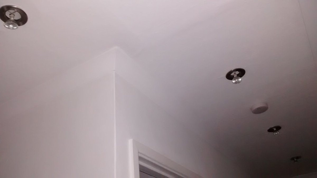

Overview-

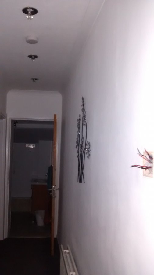

Pic 1- On the left is the 'single stair light', on the right the 'three landing lights', The 3 landing lights, all linked to one connection, the landing switch is the only switch for it (not linked to any other lights). The stair light, which has 2 switches 1 at the landing switch point and 1 at the bottom of the stairs (I would like both to work).
Landing light switch point (controls both 3 landing lights and 1 stair light)-
Pic 2- The landing switch point on the wall on the right.

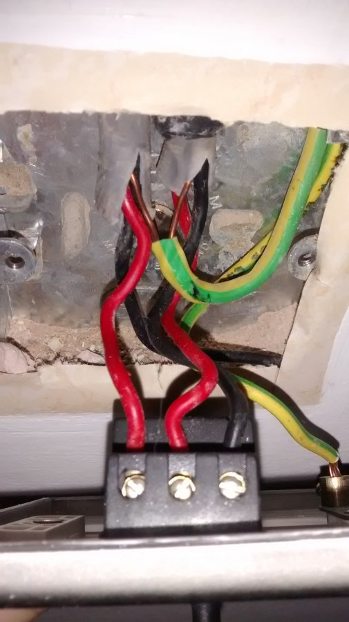

Pic 3 - Here is inside my landing switch point on the first floor, which has 4 cables coming in each with a black and red.

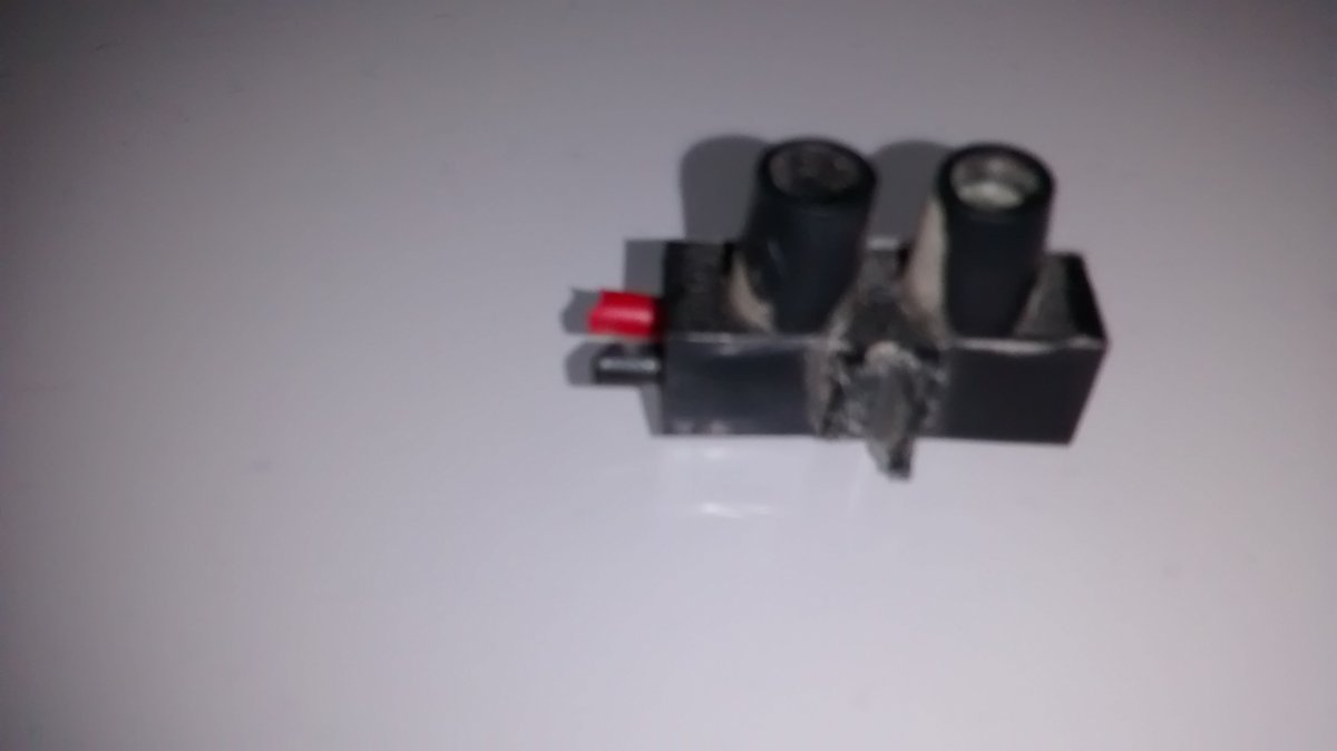

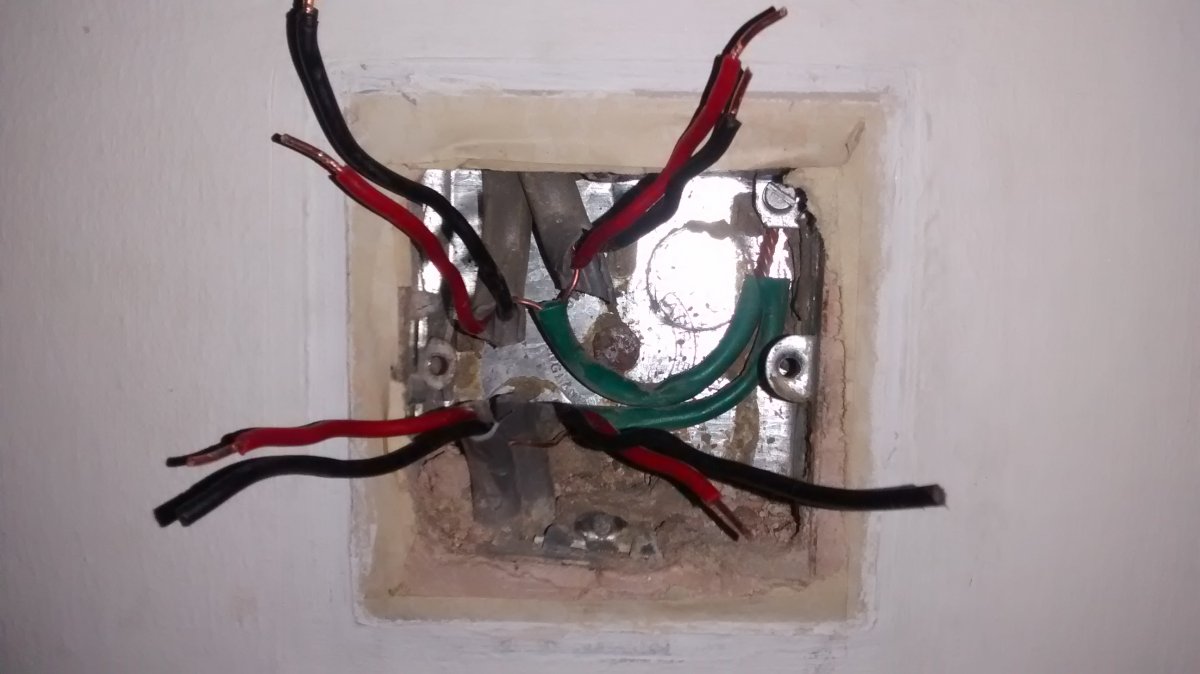

Pic 4- I did snip a little square plastic end which had a red and black going into it as shown from the landing light

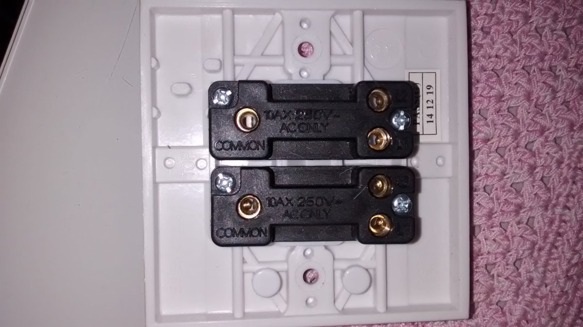

Pic 5- The old landing light switch with old pieces of wire still present (there was also an extra little red wire going from common to common)
Pic 6- The new double light switch I want to fix to the landing switch point.

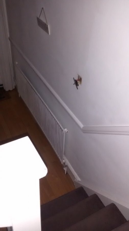

Pic 7- Looking down at the bottom of the stairs the stair switch point

Completely meaningless as we don't know where all the various look alike cables go. Do you even know which wires the connector block in pic 4 came from? If so put it back and then go for plan B.
