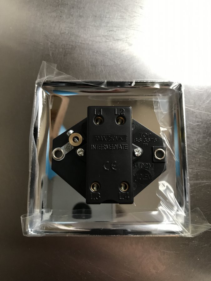

Hi all,
Bought a light switch today and just wanted to swap it like for like.
But the internals are different which has thrown me
The old switch has a:
Common (red wire)
Way 1 (black wire)
Way 2 (red wire)
Earth wire connected to backbplate
The new switch has L1 L2 L3 L4.
The switch is replacing a 1 gang switch on the landing. There is also a 2 gang switch at the bottom of the stairs 1 of which also controls the landing. This one offers no advice on how to rewire the upstairs new one
Ok, so if I am right I will put the Common red wire in L1
The L1 black wire in L3
And L2 red wire in L4
May I ask what are the likely consequences of wiring them incorrectly?
You've got an intermediate switch, which is for going in the middle of a 3 switch system. Take it back to the shop, and get a 2 way switch instead.
Brilliant diagram BAS.
An intermediate can be used as a 2-way with no problems at all - just leave one terminal empty. I guess if a 2-way is a lot cheaper then returning it would be an idea, but it would probably fall under the heading NWI-CBA.
It won't work.
But as you described, it will. If you feel that it's "upside down" (if you're anal about whether both switches have to be the same (i.e. both up or both down) when the light is off), swap L3 & L4.
