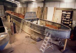

A freind of mine owns a boat yard where they build narrowboats, there unit is around 120*60ft (26*18m) and currently poorly illuminated with around 10 6ft striplights. During summer its find as there are clear sections in the roof but its now coming round to winter when its gloomy at best.
In my mind it is toss up between mercury vapor fixtures or metal halide floodlights, although they have re-lit a large area at work with clusters of floresent tubes but my experience is limited so Im interested if there is anything else to consider, as well as how many lights would be needed and the best way to arrange them.

Not the worlds best image, but I have lifted this from there website which gives and idea of the work area, size of a boat (7ft wide and a simular hight) and height of ceiling.
Obviously while the lights can be arranged to suit a certain position better, the boats do move around so lighting would have to be fairly even to get good light on the boat sides inside and out.
