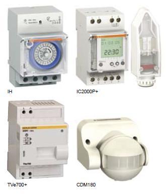

I have worked in offices where the lights are on a PIR but even in an office pain in neck. Schneider group do a whole host of relays for lighting. With impulse relays and modular contactors. This shows some of the devices available but your request it too vague to show exactly what you need. I would suggest you need to talk it through with an electrician. Some of the units can get very expensive.
