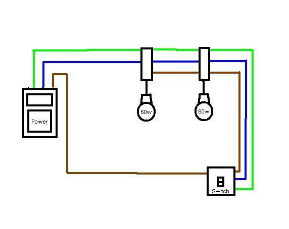

If anyone could help with this as i havent done any wiring for a while. I would like to install two standard lights in the loft with a 5 amp switch. Below is a simple diagram of the circuit:
Does this look correct or have i made any obvious errors? thanks
Doesn't look right at all. It looks like you're trying to use single core cable for the switch feed.
Instead, run normal twin-and-earth to the switch. And then another to the first light and a third to the second. Link the neutral in the switch and wire the two lives to COM and L1. Then connect the two lights up as normal.
If you look at your diagram, erase the blue and green going from the 'power' to the first light. Then draw a new blue and green from the 'power' to the lightswitch. That is the schematic you need.
If it's more practical to run to the lights first, then wire LN+E to LOOP Neutral and Earth at the first light. Connect a switch line (T+E) to the switch. The return live (the blue core) will connect to the live of the light. Then join LN and E of both lights together.
What do propose to use as your power supply? A fused spur, a lighting circuit junction, or direct from the fusebox?

yes you still have to sleeve the blue wire as brown, to indicate that it is a continuation of the live wire and not a neutral..
