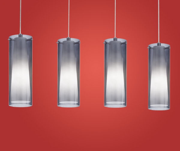

This basic type of lighting:
can look good over a dining table, but not much good if you move the thing around.
Avoid small downlighters like the plague.
In the kitchen area I'd suggest minimalist, unobtrusive recessed ceiling lighting (large diameter though), dimmable would be a good idea so you can have some light in that side of the room when eating.

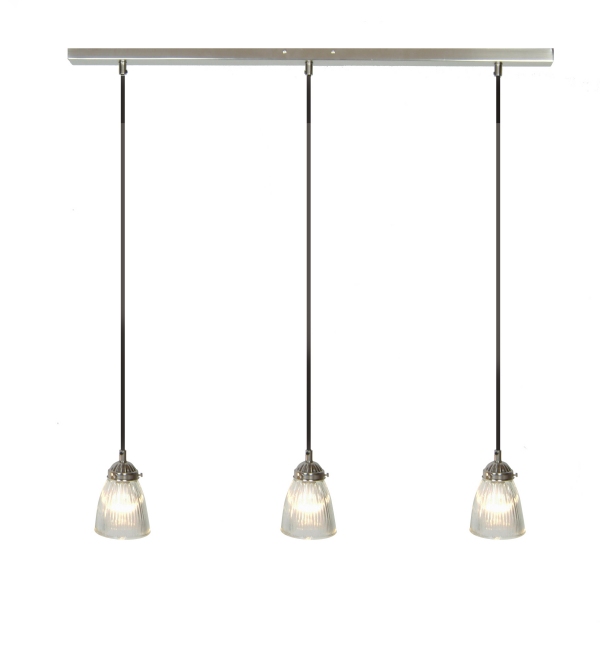

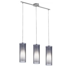

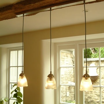

Unless fitted to plug in ceiling roses, then the lights can be moved easily.
The 'other' table location would also have plug in roses with some other form of light fitting connected.
When moving the table, swap the two sets of lights.
