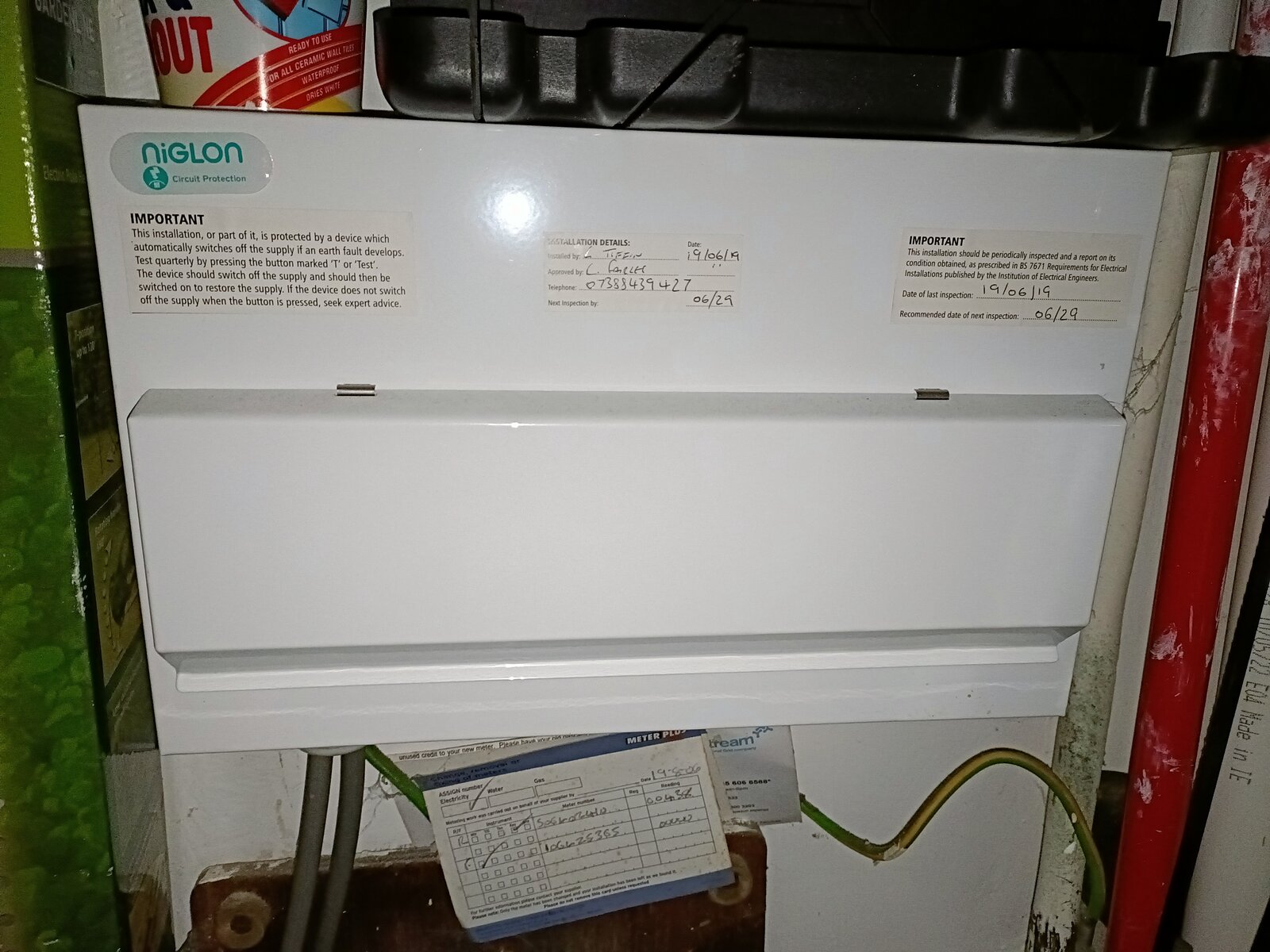

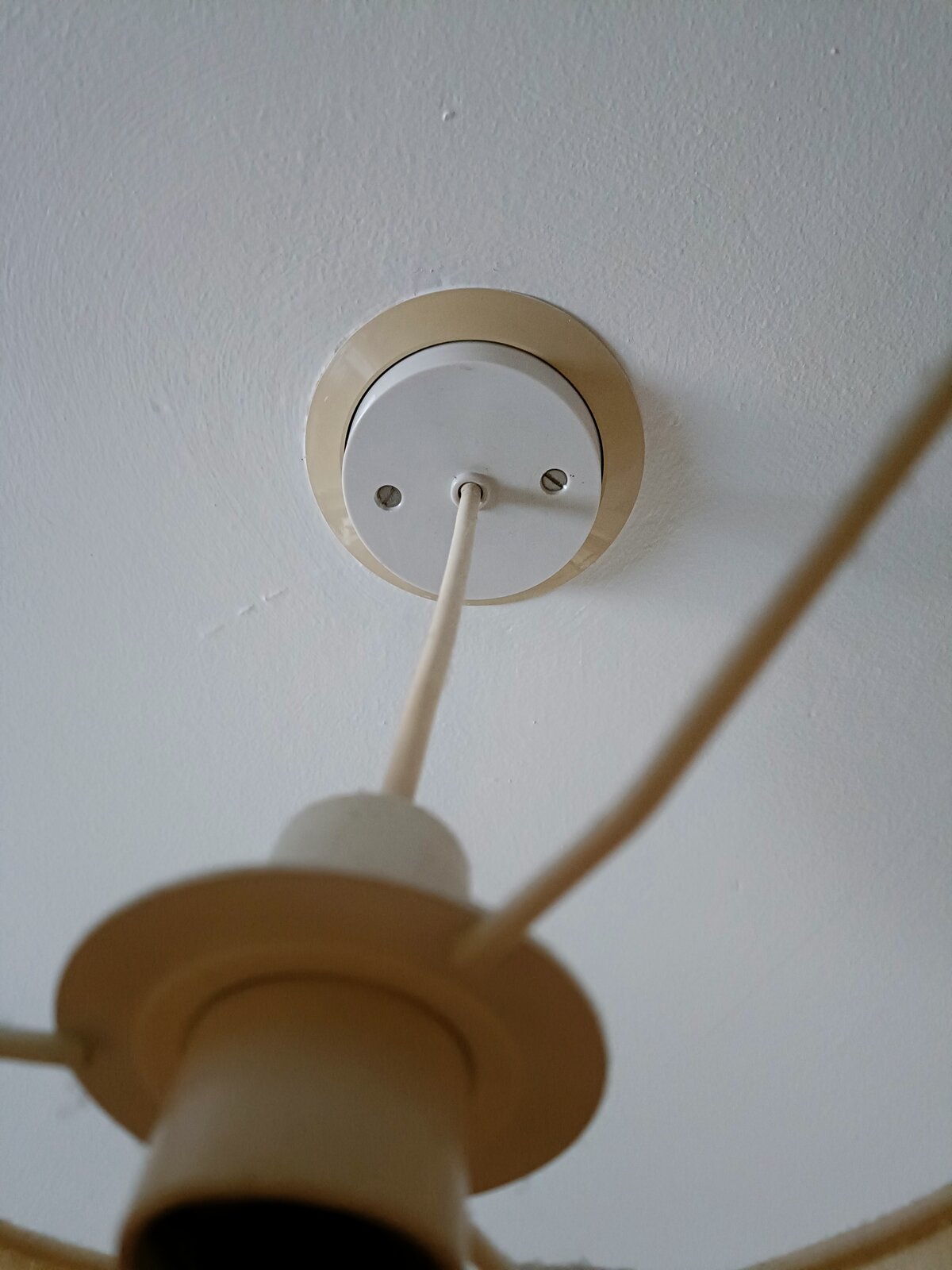

Photograph your ceiling roses and we can give you some tips.

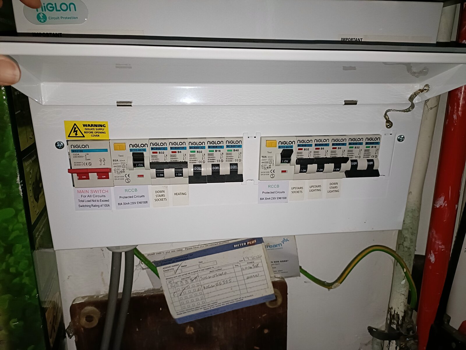

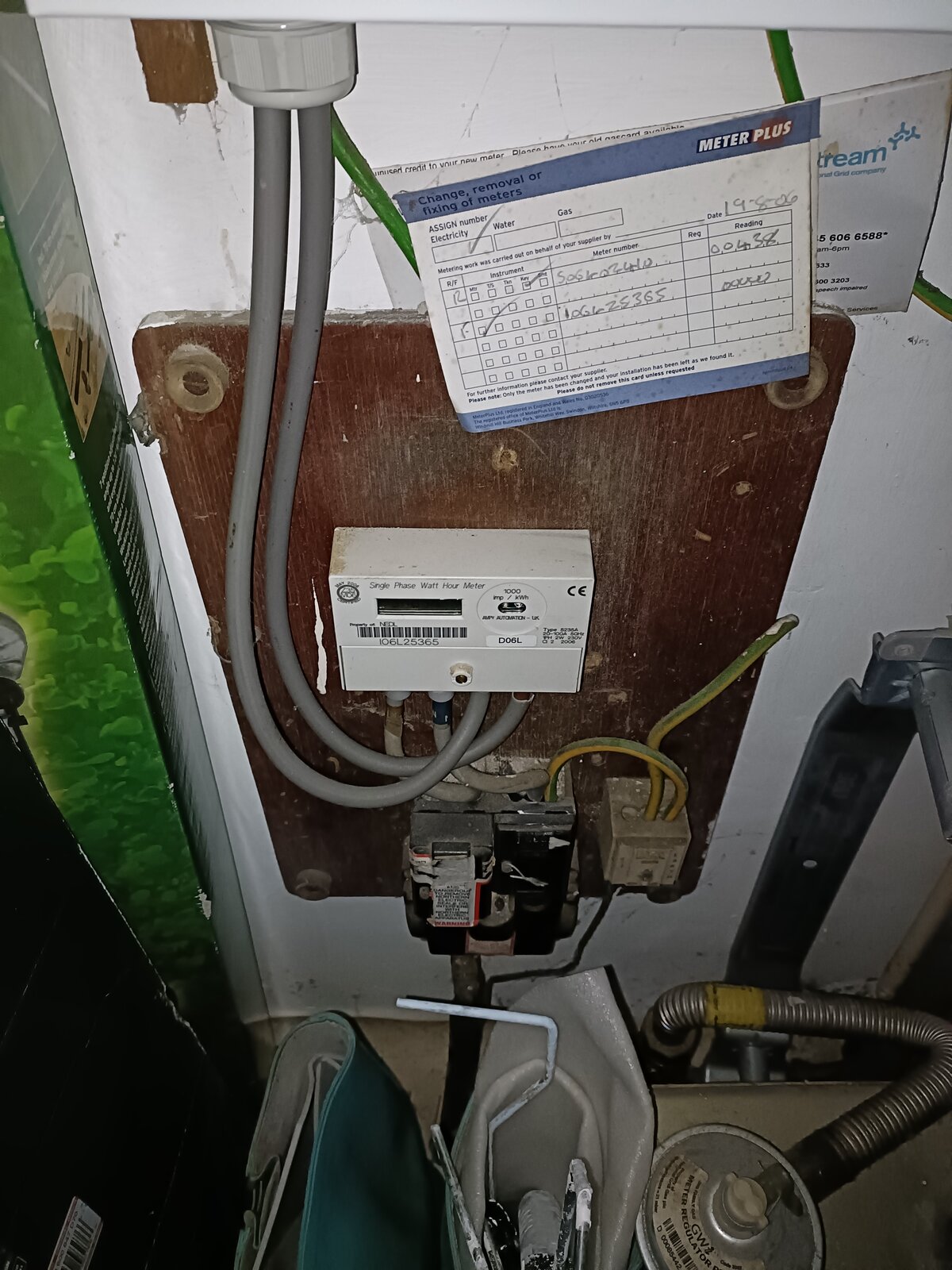

Also photograph your consumer unit and the cables around d it to give clues of the wiring age and quality

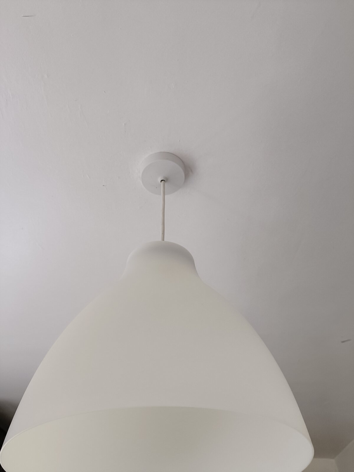

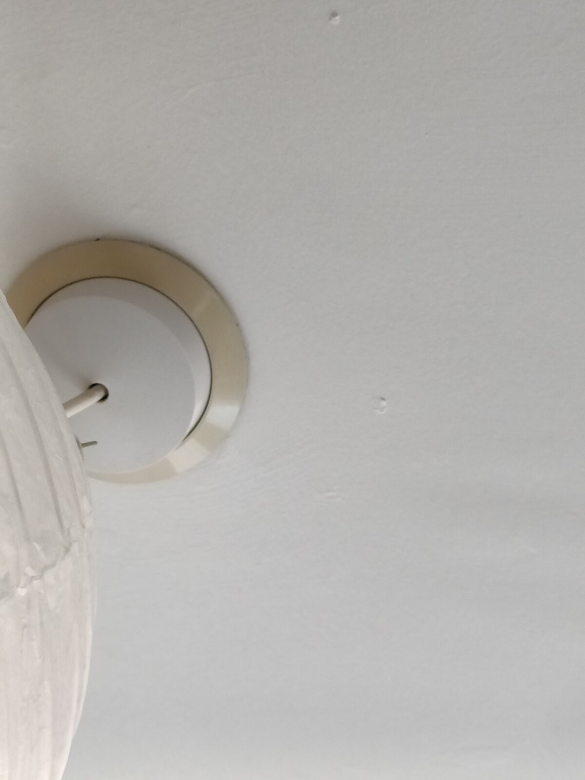

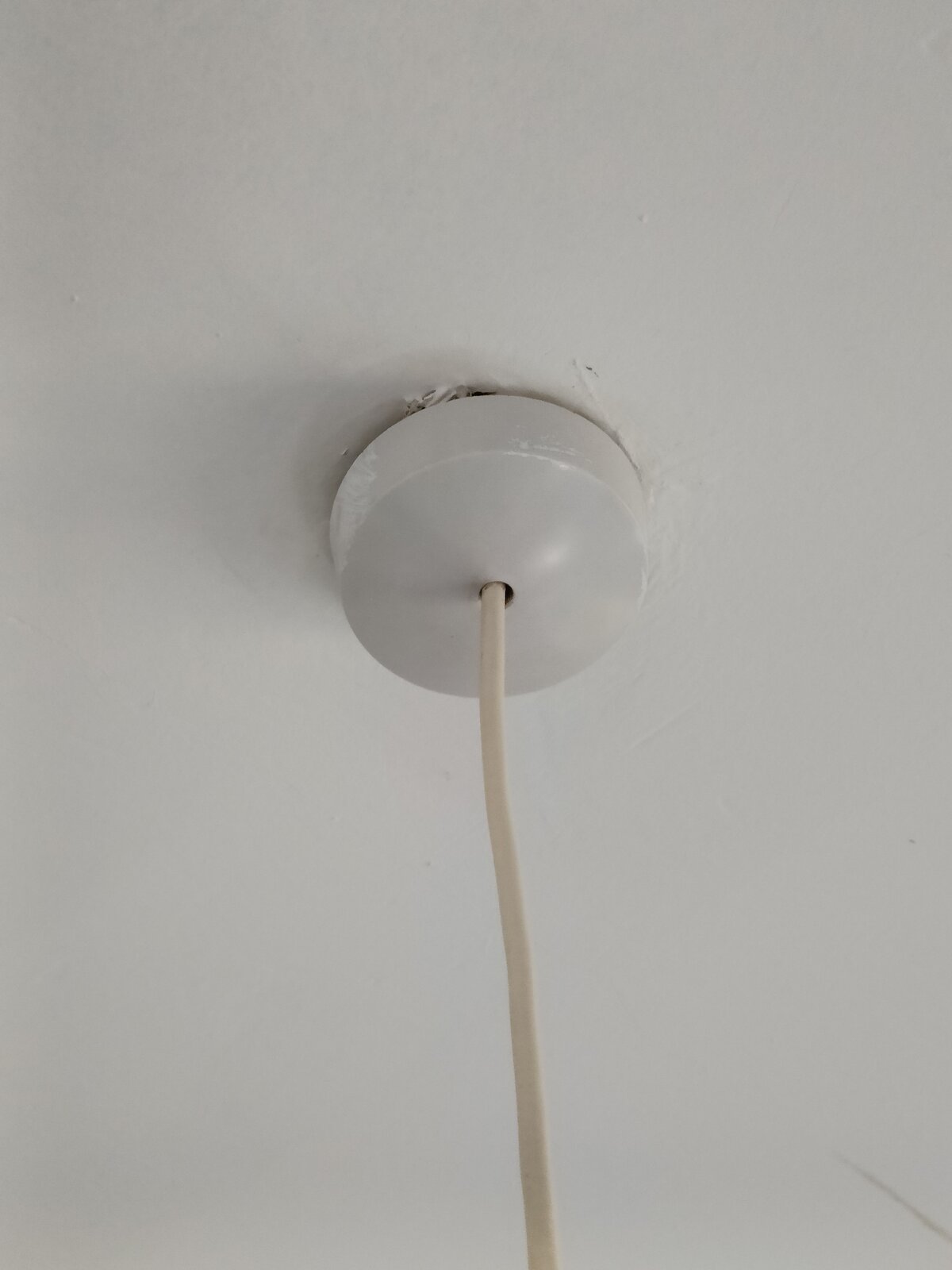

Roses are all this type. The ones with screws are the ones that aren't working.
I went back through my files and the consumer unit replacement and EICR happened in 2019. The actual wiring is all roughly 1980s vintage, I believe.

I can't see any of the circuit cables, so I can't guess how old your house wiring is.
The incomer is around 70 years old, so very likely the original wiring was replaced at some time. Some of the surrounds look brown, suggesting either great age, or smoke staining from cigarettes or an open fire, and these may have older wires inside

I think most likely there is a loose connection in one of the ceiling roses in the room where you recently carried out maintenance, and it was disturbed when handled. With lighting circuits it is especially important that each wire goes into the correct terminal, and you should mark them with tippex or a marker pen and photograph before touching. Colour is not sufficient identification.
If you find any rubber-insulated wires, or cracked or scorched insulation, you should call in a qualified electrician, as it is likely to be degraded with age and may crumble if touched. If it is glossy PVC it is likely to be fine.

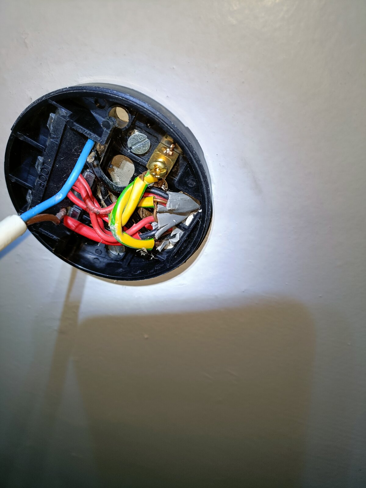

However I got up my courage to take the roses off and wiggled some wires and tightened some screws. None of them seemed especially loose but that did the trick. All working now!

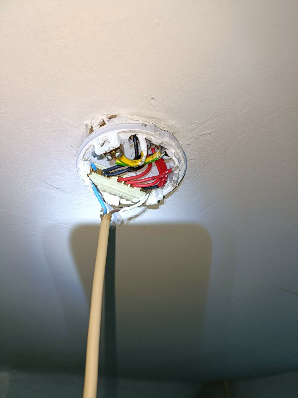

These are the two I took apart. Someday soon I will get the kitchen redone and replace these with better lights.

I can see the cables are PVC sheathed and insulated, which is satisfactory and lasts for many years. Red and black is an older standard, now replaced by brown and blue but this does not make the older cable unsafe.
Yeah it's a former council house that was built around 1950 and most likely had a full rewire in the 80s when the council did an improvement programme in the area. I think later owners had some not-so-great work done (some of the wiring in the kitchen is not chased in, for example) but all the problems flagged in the EICR were fixed.
