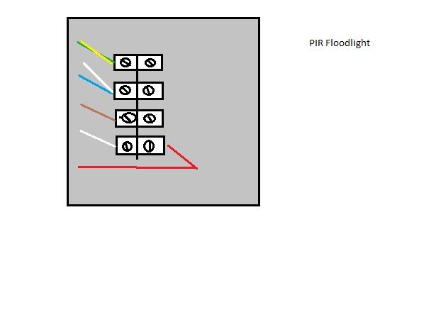

the new PIR floodlight is a std argos job and has a 4 teminal blocks inside with the lamp/pir wired on the left of the block and free terminal on the right of all but the bottom connecter:-
Left - Right
Earth - free
white (to one side of lamp elemnet)/blue - free
brown - free
white (to one side of lamp element) - red (to lamp)
so there remains an earth, neutral and live free as denoted above

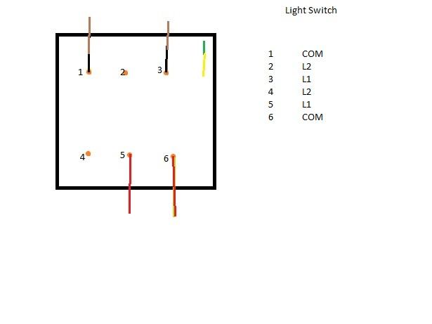

the old lamp was turned on and off by the indoor light switch -
left switch - outside light
right switch - kitched light
the indoor light switch consists of 3 terminals at the top and 3 at the bottom and is wired like this looking from the back
top left - black with brown sleeve (same core as middle bottom)
top middle - empty
top right - black with brown sleeve (same core as bottom right)
bottom left - empty
bottom middle - red
bottom right - red
and there is an earth wire on back plate
i hope you can determine what is what from the above info i'll post some pics 2morrow if you like (no main lights working downstairs)

Obviously a picture will give me a better idea how the switch is wired.
But some two gangs are divided by a line down the backplate that divides the two gangs into pymriads usually with C at the top and L1 and L2 at the bottom. The next pymriad may be upside down so L1 and L2 at the top and C at the bottom. It sounds from your description that you have this arrangement.
I take it there is no little link cable between any of the terminals.
Can you put the cable colours in the right terminal markings so what is the
C L1 L2 for the outside light?
And the same for the inside light switch.
It does sound as if you have a live and switch live and earth at the switch but live/neutral and earth at the new lamp position.
It is possible that the reds at the old/new lamp position are the loop and should go in their own terminal block - on the lamp - one of the black(brown sleeve) is the switch live and should go in the L teminal at the new lamp and the other black is the netural - which goes in the N terminal - also put the earths in the earth terminal.
You might need a multi-meter to test to see which black cable is acting as the switch live.
You don't say what type of fusebox you have but if it is a semi rewireable you may have blown the fuse wire hence no power to the lights - I take it you have changed the fuse or reset the MCB if you have one of them.
Okay you need to concentrate only on the part of the switch that controls the outside light.
With the power off.
At the switch connect together in a terminal strip the red and the black/sleeved conductors.
Turn you multi-meter on and set it to continuity or low ohms.
Then at the lamp test between the reds and the blacks until you find which pair give you a low ohm reading - this will now contain the switch live black - mark it in someway (red tape) so you remember which one it is.
At the switch reconnect the red and black back in the terminals they came from.
At the lamp ----- Again you don't say on the drawings what each terminal strip represents - it will be in the instructions - but from your drawing it looks like you have earth, neutral and switch live.
I am not sure sure what the white wire represents but I would guess this is a link to a second light.
So at the lamp you will need to put both reds in its own separate terminal block and tape it up.
Put the black you identified and marked with (red tape) into the switch live (opposite the brown) - put the second black into the neutral (opposite the blue) and the earth to the earth.
Re-set the fuse/MCB.
Remember this light has a PIR so you will need to follow the lamp instructions on how to set it up to work.

the floodlight wiring info just says
connect brown to live
connect blue to neutral
connect earth to earth
as per diagram these represent the right h/s of the 3 blocks that are free the rest is the lighting internal wiring and is all preset
