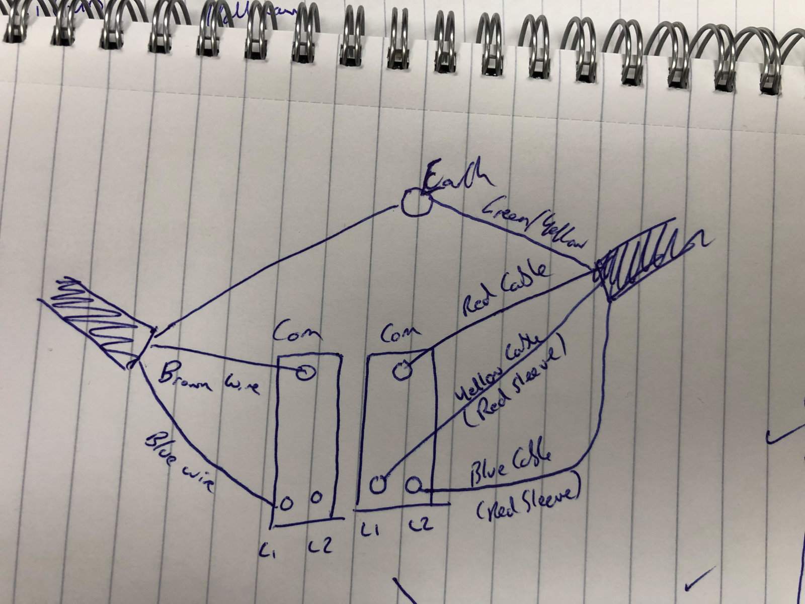

I have recently purchased a house. In the hallway we have two, two-gang light switches, one which has a switch for the upstairs landing light, and one for the downstairs hallway light. The other two-gang has another switch for the downstairs hallway light and the other switch is supposed to be for a light under the stairs. Everything works EXCEPT for the light under the stairs. After doing to obvious (check the bulb etc) I decided turn off the power and look at the back of the switch. Which looks like the attached image.
In short, the hallway switch that works is wired with a red cable in COM, a yellow cable with red sleeve in L1 and a blue cable with red sleeve in L2.
The non working switch to the under stairs light is just a twin and earth cable run into the back of the switch (the other end of the twin and earth cable goes directly to the light rose), with a brown wire to COM and a blue wire to L1 (both cable runs are earthed to the Earth point at the back of the switch box).
I am assuming the wiring for the under stairs run is totally incorrect, but I do not know how to go about correctly wiring the connection to the lighting under the stairs. I realise this is not really a full picture or how everything is put together, but I was hoping somebody may see the obvious solution! Happy to get pics of connections if they are needed.
If that is all there is - one cable from switch to light - then obviously it cannot work.
I assume it was installed by someone with no idea what they were doing do.
You would need to run another cable from the supply somewhere (is the consumer unit also under the stairs by any chance?) to the light and wire it correctly.
