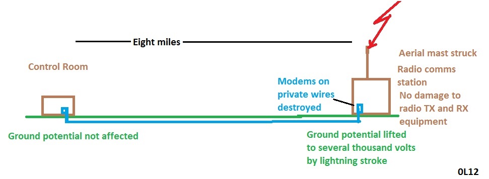

Protecting equipment from damage by lightning strikes is a black art.
Even bringing phone service by underground cable to the house does not ensure protection of equipment. The damage is often the result of the local ground potential at the strike location being pulled up by several thousand volts above the surrounding ground potential. Incoming metallic services staying at the potential of the ground at their source resulting a very high potential difference across the phone line interface circuit.
An example was a direct strike on the mast of a radio comms station, There was some scorching of cables on the mast but the radio station remained operational except that the data connections with a control room about 8 miles away were lost. The line transforners in the phone line interfaces in the modems had failed. The same type of damage that occured when, during post incident investigations of the failure, very high voltages were applied to the phone line connections of new modems..
The phone lines ( Private Wires point to point copper pairs ) were at the potential of the Ground at the Control room

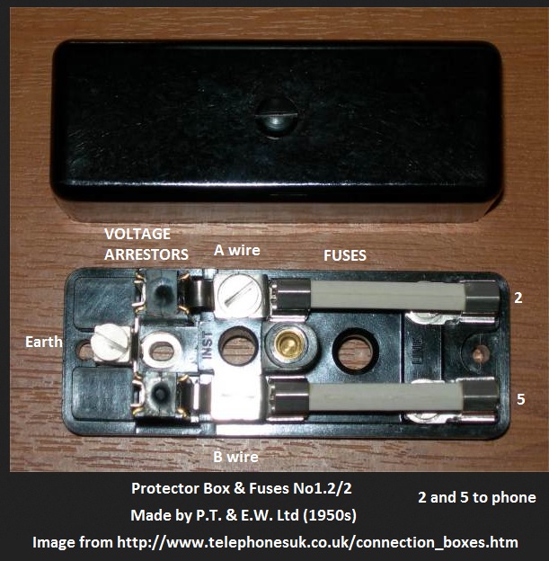

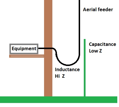

A U bend in a cable ( Aerial feeder or over head telelphone cable ) and an earthed metal plate will divert lightning energy down to Ground. In a severe strike the current will flash jump to the plate, it may not happen fast enough to protect the equipment but is is likely to reduce damage to interior of the building.
In early days of telephones one of these was fitted at the house to protect the telephone from lighting strikes
