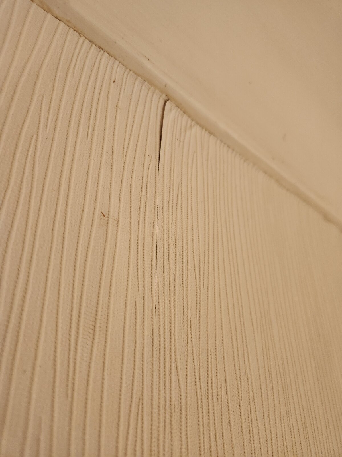

I was wondering what I should have expected when a decorator came to wallpaper a single (prepared) wall. 7 x 2.4m .
I fully expected him to put down the lining paper, let it dry and come back the next day to put in the wallpaper.
He came in at 8am and left by 2pm (with an hour lunch), (charging me £320, no material cost [north london]). He said it's fine to put wallpaper straight onto damp lining paper.
I'm wondering if I've been ripped off.
I have yet to see if the bubbles go away under the wallpaper but there are some pretty substantial ones.
Is this the normal way to do things?

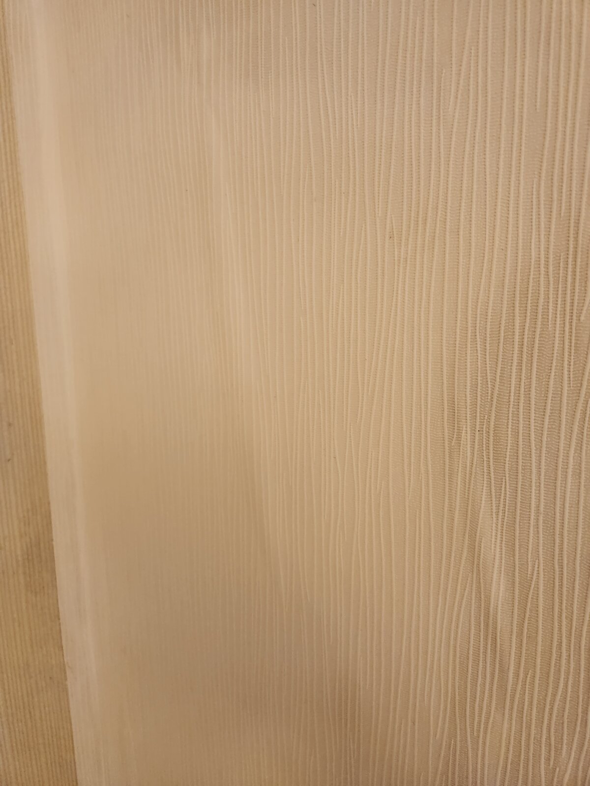

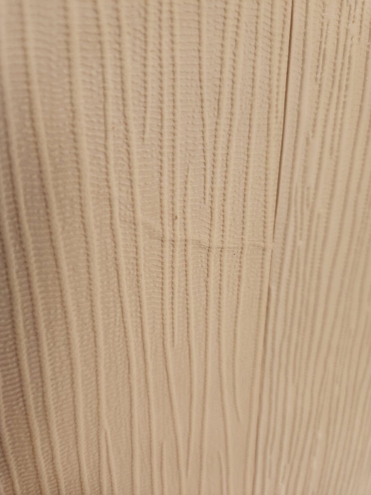

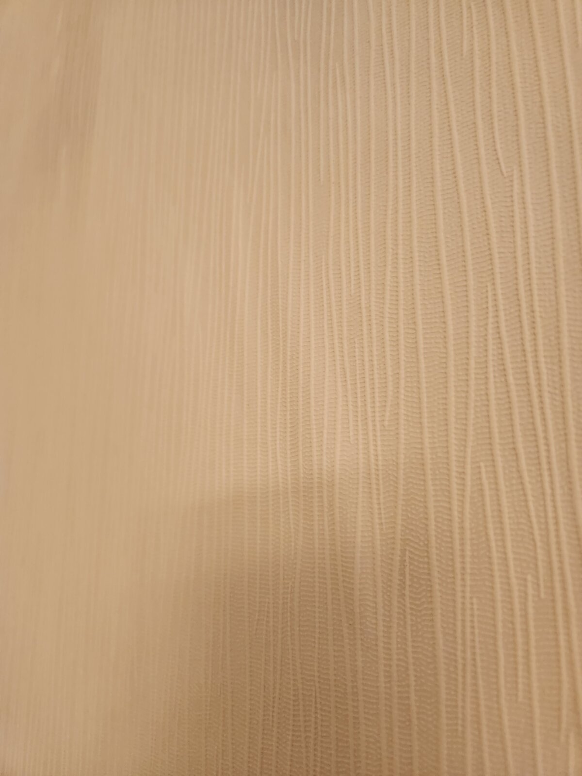

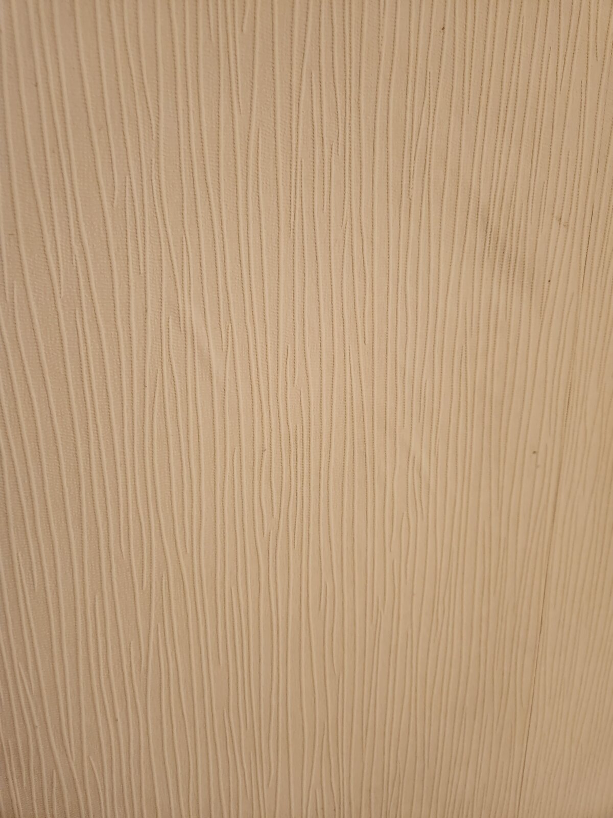

I wouldn't have paid until the bubbles had gone. If the lining papaer wasn't soaked long enough, they may NEVER go.
I did find ages ago, that a wall I'd papered had bubbles which remained (not lining paper), so I resigned myself to going back the next Monday to stripping and starting again. I found they HAD all gone. It as much less porous than lining paper though.
Only did my own flats - I never tried papering on damp LP!
£320 for a day may be ok in N. London, just. I'd have opps' arm off. Where are you, @opps ??!!
Ok, so it was a paper that needed to be smoothed with a papering brush.
Image number 1 will never sort itself as the glue dries.
The final image, hard to say, but the crease may be in the lining paper (which should not happen). and if it did happen, you would sand it out the following day- hence the importance of letting products dry.
Perhaps ask the fellow to provide evidence from the wall paper manufacturer that recommends hanging the paper over wet lining paper.
