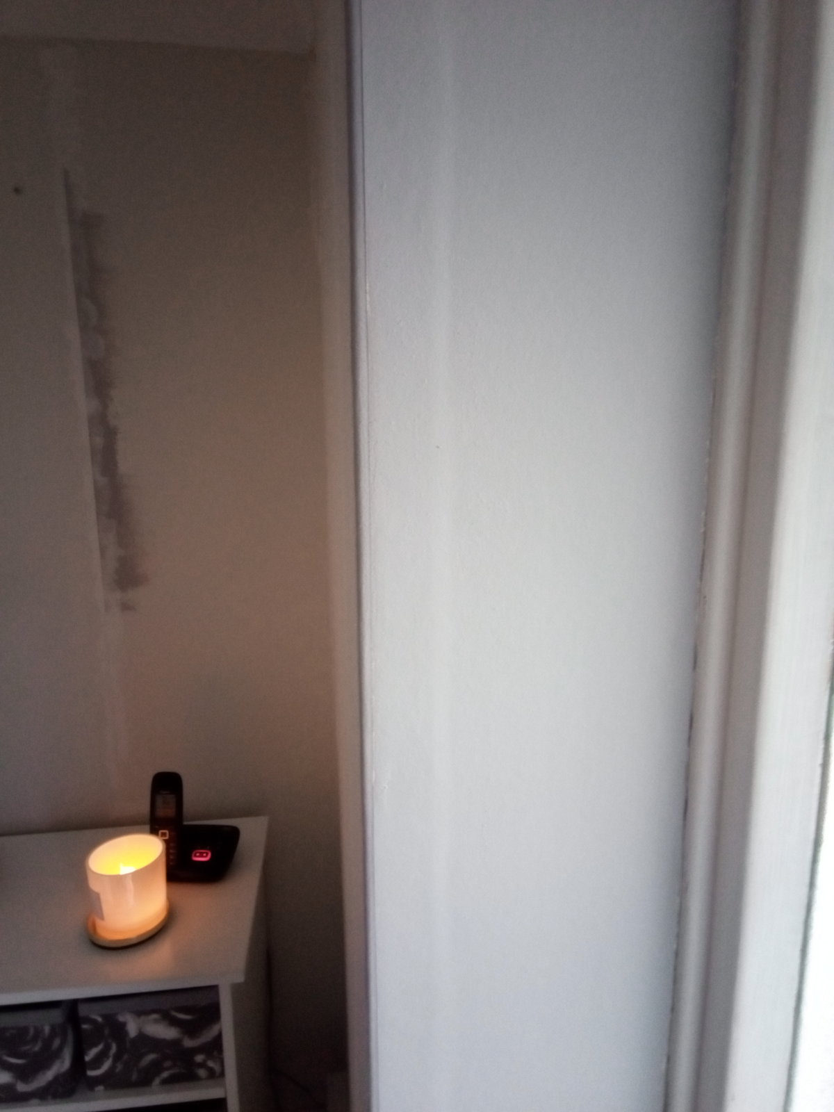

Hi all. I have papered my hallway with 2000 lining paper. Silly be forgot to splice round the corners and now I have ridges
Is there anyway to rectify this without having to strip and re paper. The lining paper has been up for 5 days.
Thanks for the quick response. Hopefully you can see my issue in the attached.
Run a new stanley blade down the join and carefully peel back the overlap.
As it's lining paper the paper you put over it should not show it.
Thats unless your gonna paint the paper, in which case - strip and do it again.
