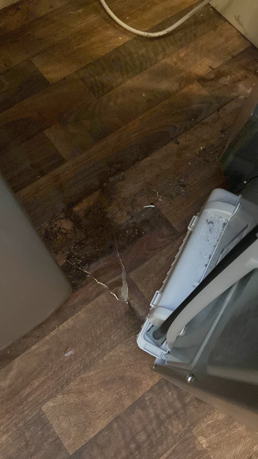

Hi, my Lino ripped moving my machine forward. Any type glue that you can recommend to fix this? Thank you.
Clean the area.
Then use a small container or a cartridge of flooring adhesive to glue under the surrounding vinyl.
Smoothly press them down. Use a gloved finger or a spatula to spread the adhesive.
Carefully glue the ragged edges, and under the lifted piece.
Then smoothly press down.
