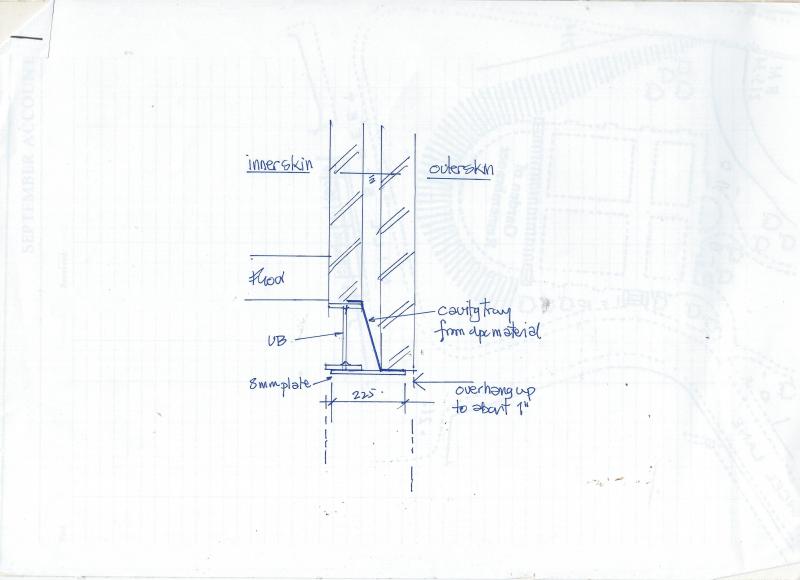

I have been given calcs for a UB or a Catnic.
UB works out cheaper but all he said is the size with a 8mm plated welded for the bricks to sit on but no size of the bricks.
So I presume the plate it brick + cavity + brick on the bottom of the I ?
Where does the UB site in relation to depth. ie. straddling both inner and outer skin?

The calcs say 178 x 102, so the width of the bottom plate I can work out from brick and cavity widths.
So is there more weight on the inner skin than outter as from that sketch to me it looks like the outer is not as well supported as the inner skin?
There is usually more weight on the inner skin, as this also carries the weight of the roof (and the floor if the joists span on to the wall).
If the steel plate is 8mm thick and is welded to the bottom flange along two lines,it will easily support the brickwork.
Catnic make a similar fabricated beam using an I beam with plate welded on the underside, intended for carrying heavy loads over long spans (google 'Catnic CXL')
Aaaah right, that all makes sense then, many thanks.
Yeah have looked at Catnics, the one I need would be £130 where as UB with the plate is going to be around £90

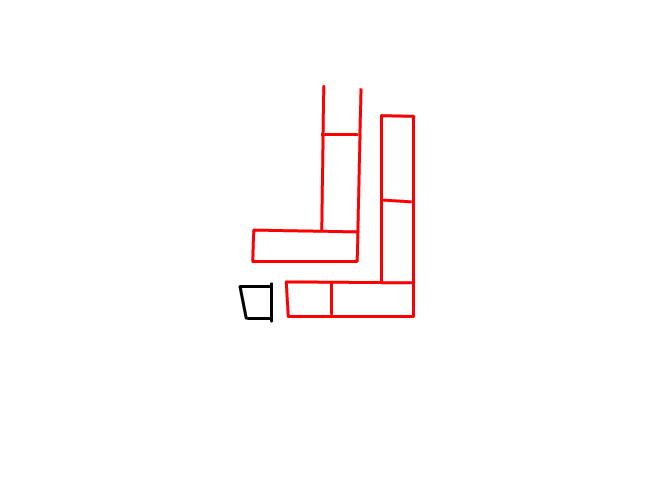

The end wall where the current shed door is. the brick work is like the picture below.
The inner skin extends byond the outer skin by 80mm
When the new door is fitted it needs to sit to the outer skin line.....so would I be able to cut the inner skin flush with the outer?
(the black is current door fram, and where new one would be sat
This in turn means the 150bearing of the lintel will be sat on the inner skin bricks going perpendicular to the lintel.
Will this be an issue?
Looking back at your pic, there seem to be only 1 1/2 bricks showing on the front face at the corner of the house. This is called the 'return', and modern requirements are that the return should be about 550mm (say 2 1/2 bricks) to ensure lateral stability of the building.
The potential problem you have here is that in putting a much wider opening in, you are effectively increasing the load on that corner.
If you have made a Building Regs application for this (which you should) you need to discuss this with the inspector to see if he would be happy with it left as it is. He may ask you to get an SE to do some figures to prove adequacy, or possibly strengthen the corner some way.

Hmm, delved a little into this.
Seems I could have 2 option here.
1. Bring the outer skin in line with the inner skin and hope the BCO agrees that this is okay due to the fact an opening already exists within 550mm of end wall.
Or, not sure if this is possible but.
2.Fit a 'corner' lintel so that the load is spread more down the gable wall......this could also fit for future idea of extension to that end of the house.
What does anyone think?
Instead of fitting a corner lintel fit a shaped padstone.
I believe this may work as far as load dispersion is concerned.
The shape being a square spreading over both inner and outer skin?
Or a L shaped stone?
