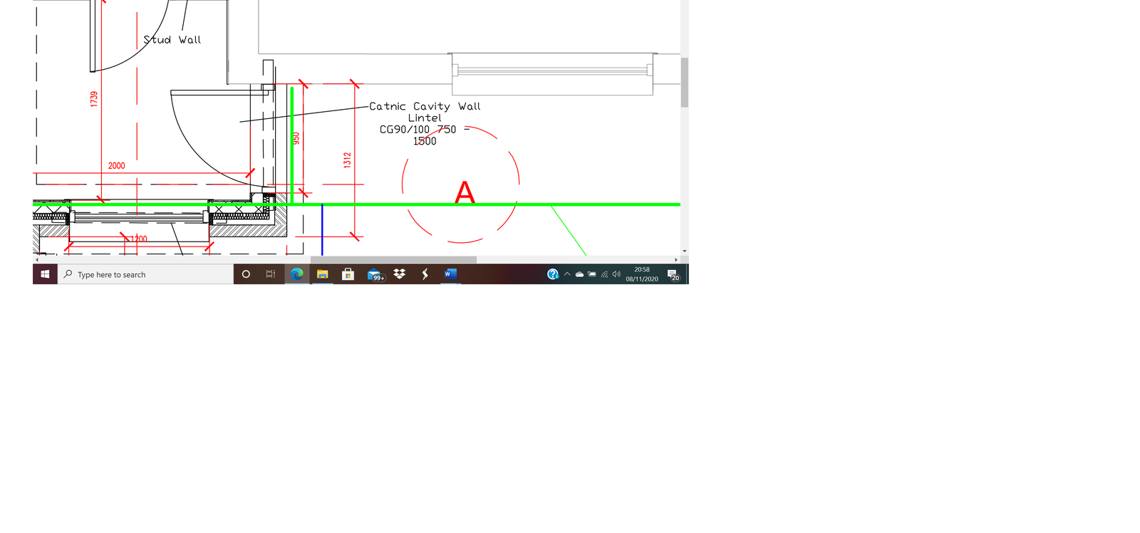

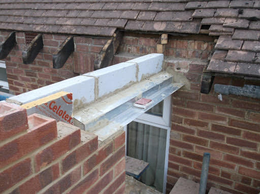

Lintel into existing wall
26 Dec 2017
19
Hello
I want to put a lintel above the door, and slide it into the existing wall at a right angle.
then pack round the lintel
Is this acceptable
BC have already approved the plans
sorry, here are the plans and photos

Yes. If it's a pedent BCO, he may want confirmation from the manufacturer that 100mm bearings are OK ( which they are).
