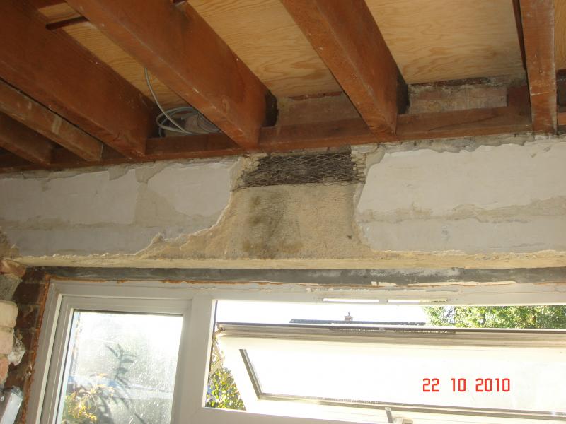

Hi there, I have posted about this problem before but now the issue has come to a head.
I'm converting my windows in the lounge into french doors.

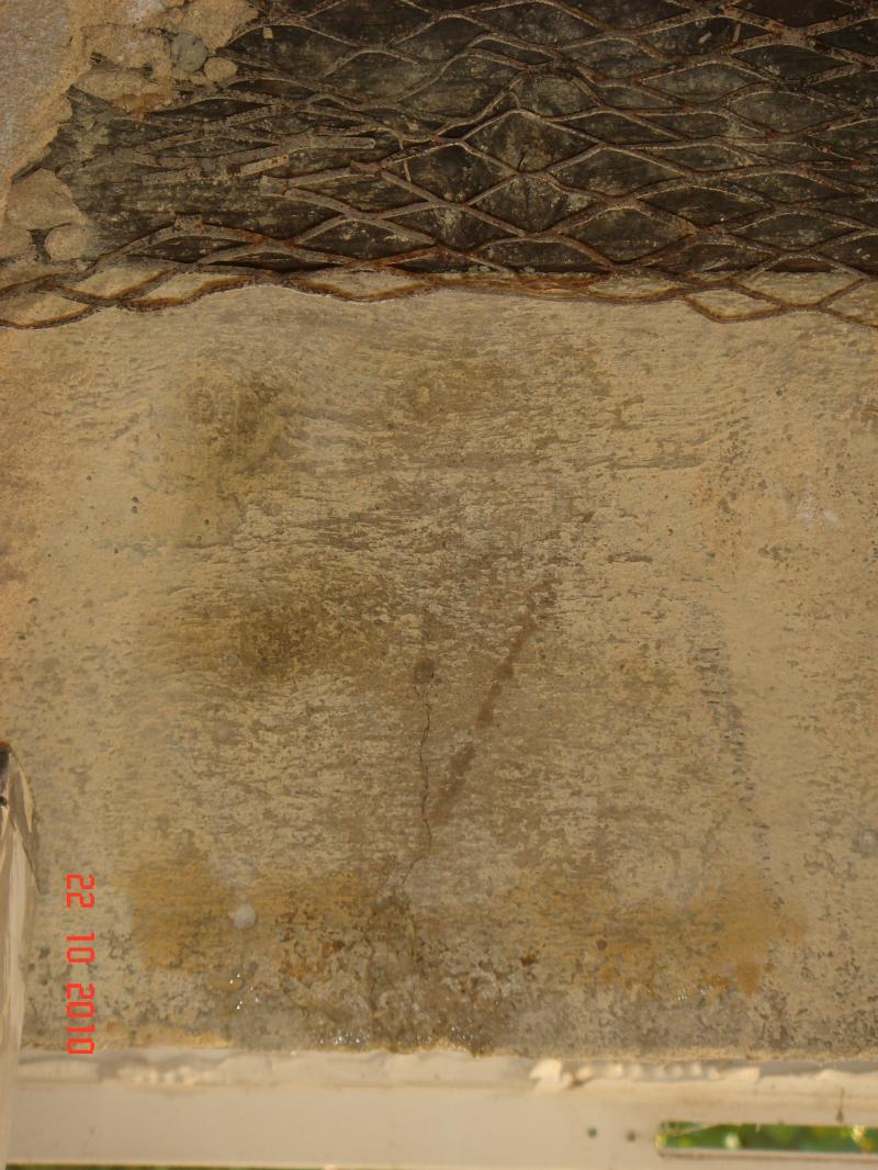

I have noticed a hairline crack in the middle of the lintel about 4.5" high going up on the face, it goes underneath and the back of the lintel. I believe this has been caused by drilling into the lintel and inserting wooden dowels for the curtain rail.
Asking you professionals would this be a concern? (See Pic 1&2)
Would you replace?
The lintel dimensions are L2040mm H200mm W115mm, it also isn't level, slight slope.

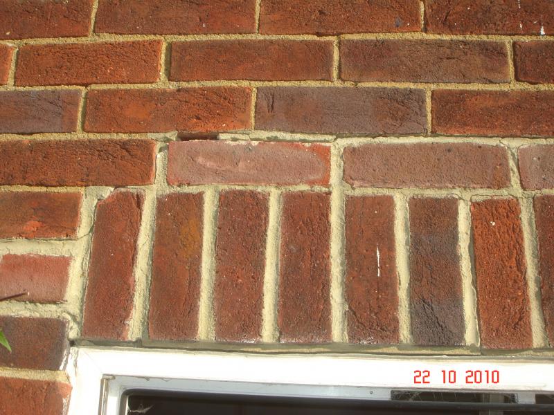

Also outside the course of solider bricks there isn't a lintel at all. The course of solider bricks has cracked and is now resting on the window.
Today I very carefully inserted a steel chisel, gave a little wiggle and the bricks slumped by 5-6 mm (GREAT). A lintel is a given here!!
Asking you chaps.

Hi
The situation you find yourself in is quite common where timber windows have been replaced with plastic windows, basically the timber window did not deflect under load from the soldier course whereas the plastic window does, and hence the reason for the soldier course dropping. Going by the photos you can actually see the deflection in the top of the window frame.
The easiest solution would be to pin up the internal and external wall along the length and above the existing lintel height. You would likely need a minimum of 3 pins (or one every 600mm from the end of the lintel) to support the brickwork above. Then take out the offending lintel and window, build up the walls to suit the new opening width and install a new lintel to suit (you could possibly use a catnic lintel which will then provide support to the external soldier course and take any dead weight off the new door frame) and finish by rebuilding the external soldier course.

Lots of these concrete lintels crack on installation or at some point over time and you never see it.
As long as the lintel is not overloaded, and the ends restrained, then it will be OK to leave in place
The external brickwork will need a lintel though
