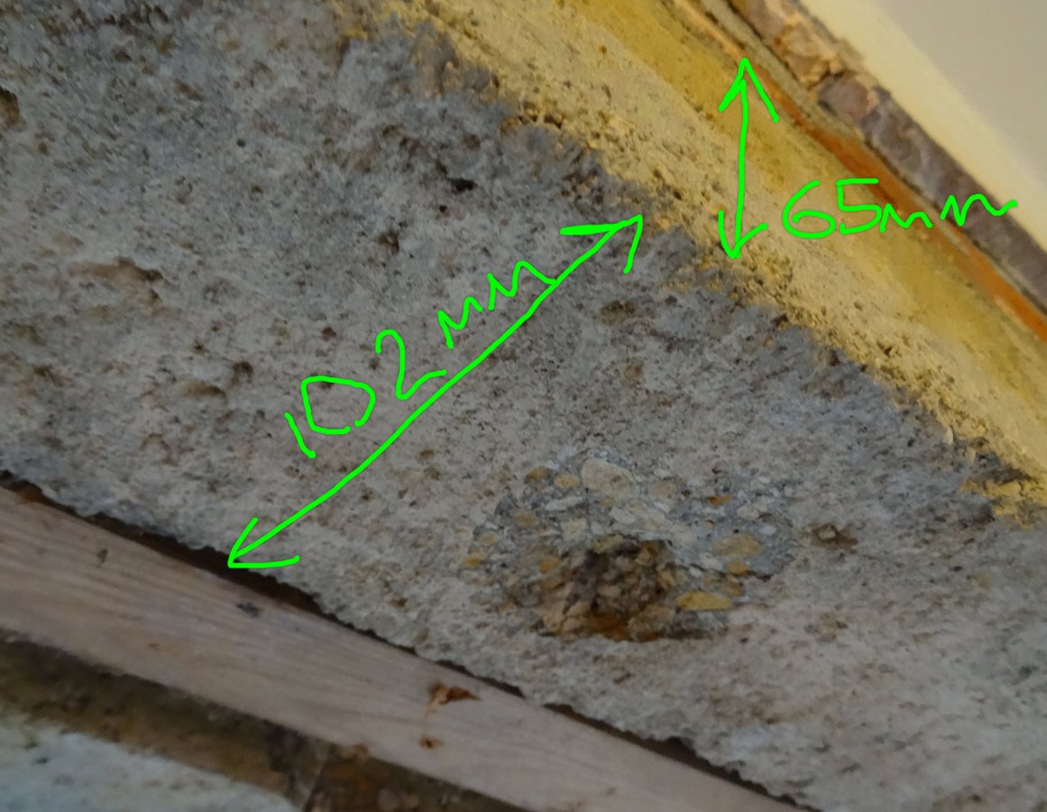

there are two concrete lintels for each side of this wall supported by something like 12-15cm of brick

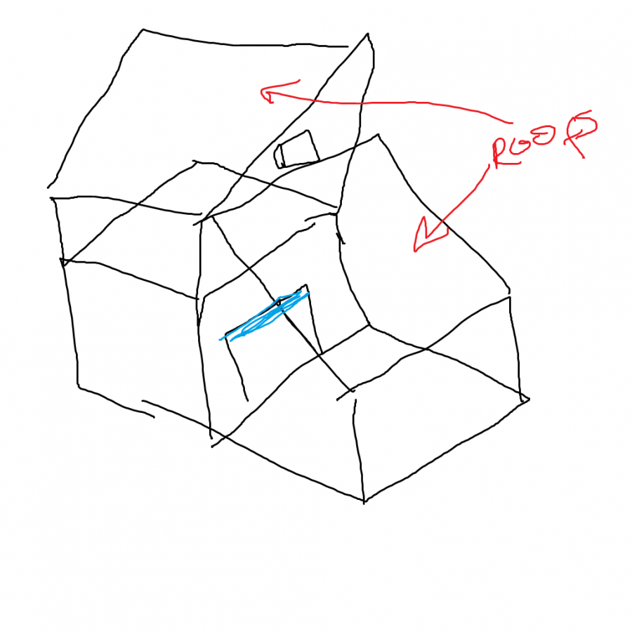

(please check sketch below)
lintels are 65x102mm with length about 2400mm
there is just one room above the dinning room and slope roof above the kitchen room
everything was nicely covered with ceiling and plasterboard cut arch in this opening
luckily as a part of refurbishment I have removed them and found that original outside wall lintel is actually bent a little and the brickwork above it is a bit loose - "thanks" to another stupidest person who rammed the wall with a hammer to insert rafters for a flat kitchen ceiling
so these 65x102mm lintels are actually helping to hold a brick wall (was original external wall of the building), the wall in question is around 2m high on one side and something like 4m at the other side (~3m tall wall on average - second sketch)

I want to create additional support for these lintels by adding another one right below (third sketch)
I have plenty of space to extend walls into opening to create 100-150mm of support and there is up to 200mm in height to sacrifice before this opening will look too low

ah... only rubbish pictures on this computer, here they are:
- overview of this wall\location from kitchen-into-dinning room (sorry for fisheye lens)
- closeup of lintels currently in place

- one of the lintels is visibly bent (never actually measured the exact figure)
- someone was bright enough to nail the arch (not shown in pictures, removed already) to the lintels itself
- it is so easy and inexpensive to make this opening even stronger, actually If regular reinforced concrete bars would be "enough" I would go to 140x100mm concrete lintels, install them with some tension underneath the existing lintels and support them with extended wall,
just for peace of mind, if these lintels were originally 140mm I would not do anything but they are 65mm :(

rough estimation - it is ~10mm down in the middle for 2000mm length
few holes from nails
