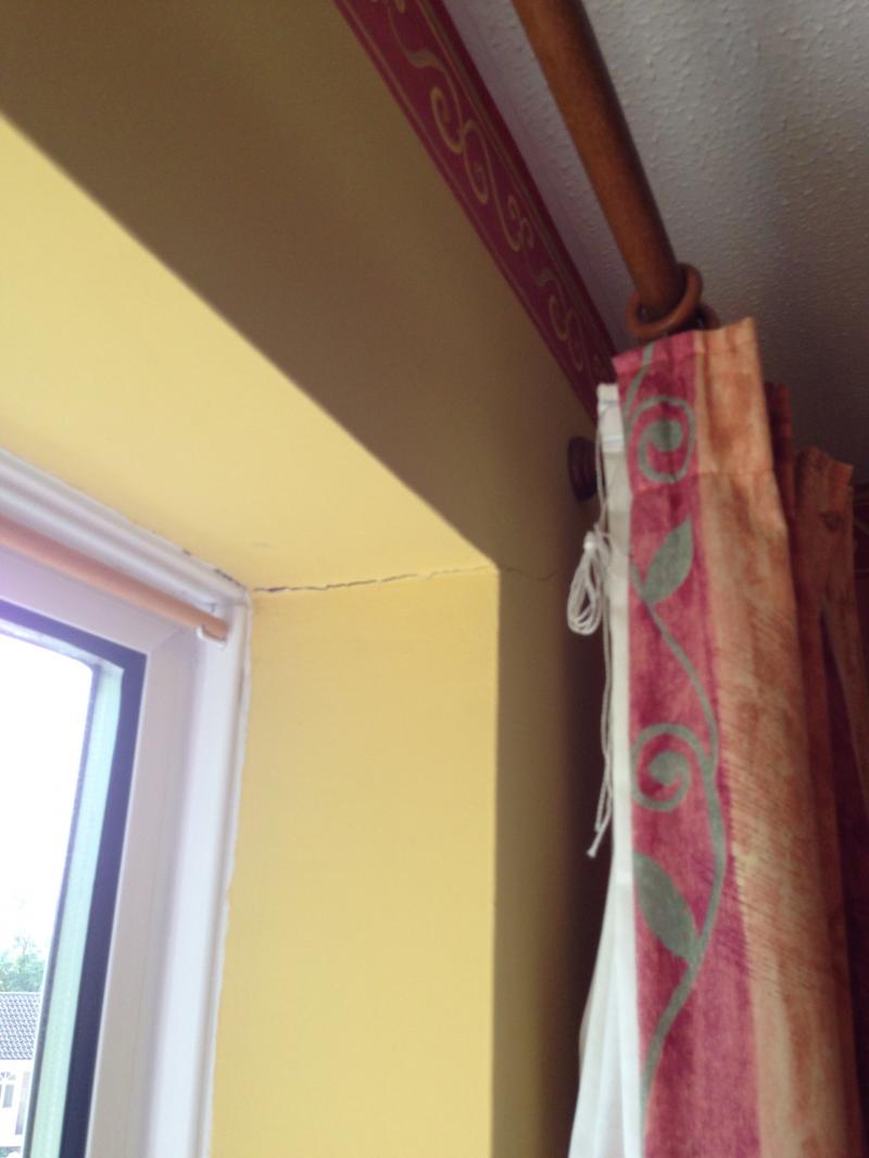

Hi guys,
long time reader but first time poster so hello.
We are in the process of buying a 1960/70 house near Northampton. Older chap use to live there so lots of decor needs updating.
Now I have noted a number of cracks on the back wall 1st floor windows and the horizontal crack running between the 2 windows so i believe it may have a lintel problem.
I asked the surveyor to look into it and has suggested the lintel may be rusted or subject to expansion. Basically I wanted a second opinion and then what are my options?
Cheers

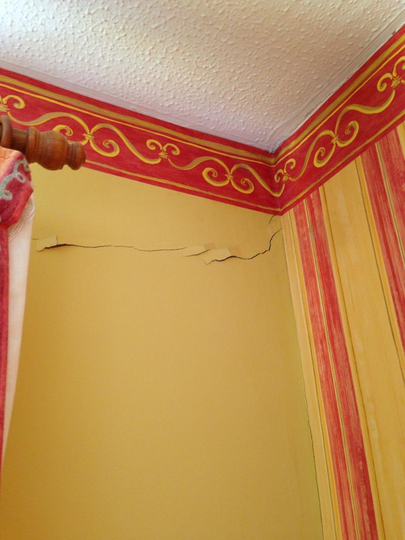

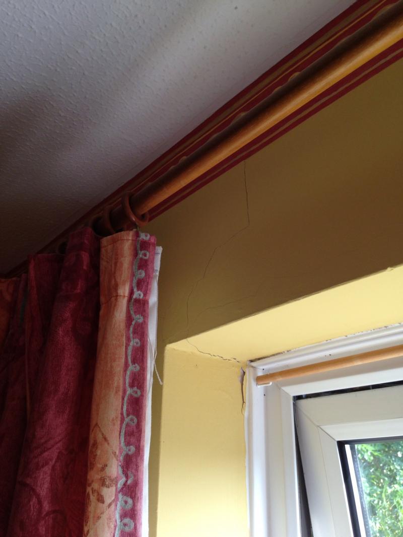

I don't see anything I would consider a lintel problem as such. Both cracks at the top corner reveals are normal and can be dismissed, the external pic shows a small drop of the brickwork between the two windows, if there's a lintel between these that in it's self is most unusual!
I would suggest you hack out and expose the internal crack to the right of the window in the pic, see if there's a problem there. Otherwise re-point the gap between that one small section (I presume it's the only one?) keep an eye on over a full year and see what movement, if any occurs.
Let us know what you find under that internal crack.

I bet angle irons (L-shaped steel) have been used as lintels, and have rusted. The corrosion will lift and crack brickwork like you wouldn't believe!
I would start by stripping the paint from that internal wall, it may just be de-lamination of the paint, curious though!, then re-point the course between the windows and keep an eye on it. But it would be worth asking the seller for their explanation, they may give a clue whether they mean it or not...pinenot :)

My money would be on wall tie corrosion causing horizontal movement.
The internal damage corresponds with the outer level of damage.
