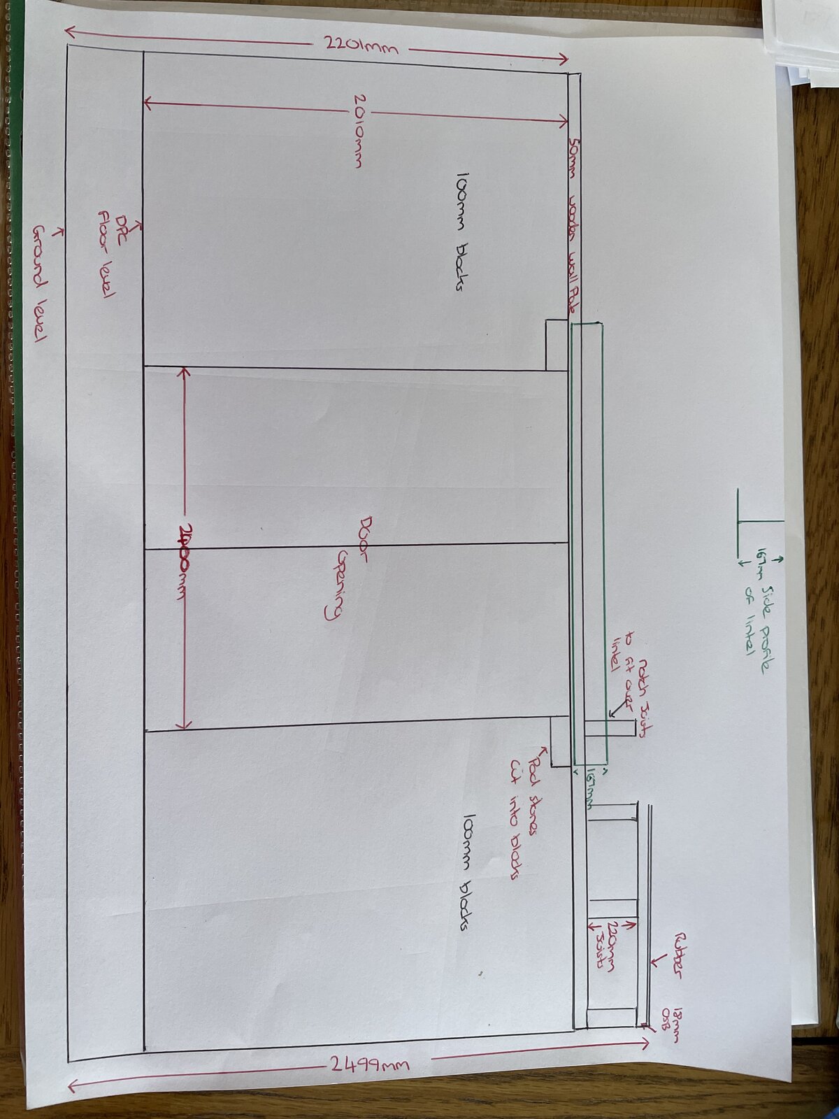

Hi i have attached a drawing of the side profile of my build. Can someone give me some advice as to see if it’s right please.
Given the wooden construction above blockwork level, I'd be looking at a flitch beam to simplify construction. Steel plate sandwiched between two lengths of timber and bolted at several points along its length.
