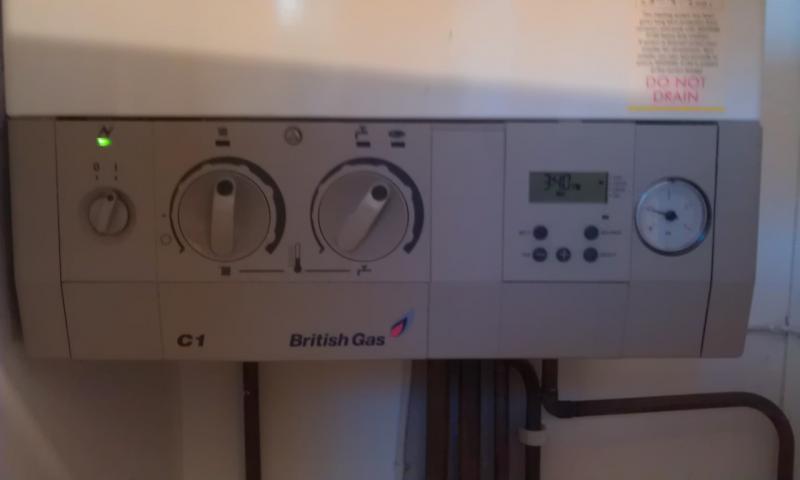

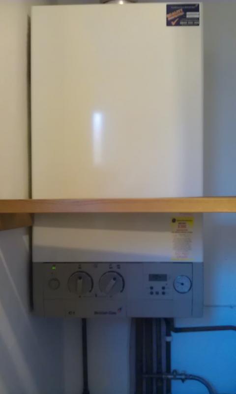

The boiler was fitted aprox 10 years ago by British Gas and currently has 4 radiators upstairs and only two downstairs?? I'm no expert but that does not seem many??
We have a 3 bedroom end of terrace house which has a small hall /entrance / stairs where 1 x small double rad is fitted, 1 x lounge / diner (two rooms knocked into 1) with only 1 x radiator fitted. A kitchen and conservatory with no heating. On the first floor there are three bedrooms each with a radiator, no radiator on the landing but there is one fitted in the small landing area between the separate toilet and bathroom. That's it.
Attached are 2 x pictures of my existing boiler (sorry no name or make) from the replies it would best (if poss) to add some extra radiators? 1 in the kitchen, 1 in the bathroom and if the boiler will accept more 1 more in the lounge / diner and poss 1 on the main landing? Will this boiler be able to take more radiators?

yours appears to be a combi boiler.
If it has enough power to run a shower, it has more than enough power to heat an average house.
Looks like one of the old Worcester Bosch CDI units that British Gas rebadged but they came is several flavours and would need to check the rating plate to know what size it is in KW's. Even then, if it's the 24CDI then it should easily take another couple of rads.
You would need to find out what rating the boiler is and what size/type the rads are that are installed at the moment to calculate the available capacity. There will be a plate inside the boiler with lots of info on it, like serial number etc, it will have the boiler rating on it in KW's.
