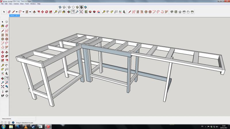

So I made a concept idea in Sketchup with reasonably accurate measurements. This was a base to get started. It also made working out materials alot easier. I made lots of drawings but once it was on computer it was really easy to work things out. Great free little program !
Now a few things. I needed to allow space for a Tumble Dryer and a Washing Machine that would later be put in. I also wanted to try to incorporate some old wardrobe doors I had that I was hoping to use. So this determined the size of the cupboard sections.
Also, at first I was going to make a unit that could be moved, but this required more materials and after some thought I realised there was no point. So I decided to go with something that would be solid and fixed in place.

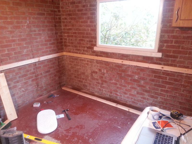

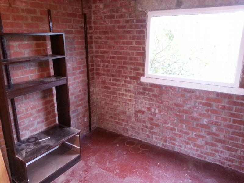

The garage space, tided up, with an old unit that previous owner left behind

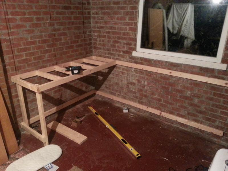

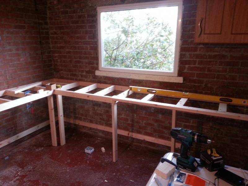

I bought a load of 3x1s for the frame. Cheap and sturdy. (£4.70 for 4.8m)
Added one side and first legs.

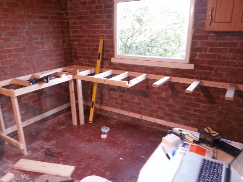

Now, importantly the W/M and T/D would have to fit, and for this I lay the 3x1 on its side for the front section of that, otherwise it would raise the work surface too high.
As you can see here

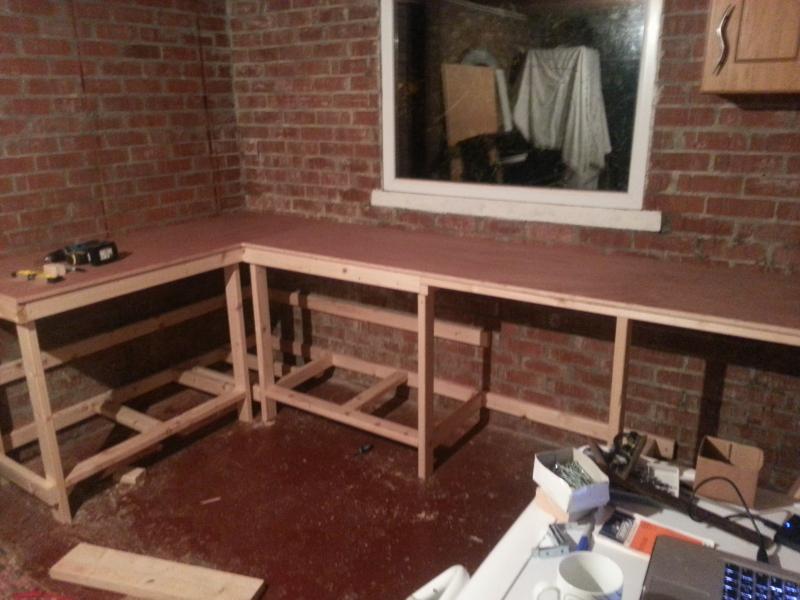

Top on. For the top I just used 18mm Ply. For what I will be using it for it is good and strong. You can also see the structure of the cupboards now. All super solid !

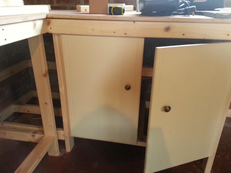

And them doors I was able to use. Thankfully all my measurements worked out nicely !

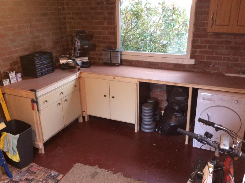

And finished. I was able to add a drawer from the same wardrobe and the off cut of the door worked out perfectly for underneath. The drawer was a really nice addition that I am glad I put in. Handy for lots of tools etc.
Got lots of storage out of it and I still have lots of space left. The space where the washing machine will go, is just being used for some stuff for now. I am also planning to put some shelves up in the corner with that old unit that was in the first picture.
And the mitre saw is not kept there as it would not be very practical! I just put it there for storage. I actually rather use it outside to keep dust out!
It is no kitchen quality finish, but it looks great enough for my garage space ! Was lots of fun making this.
