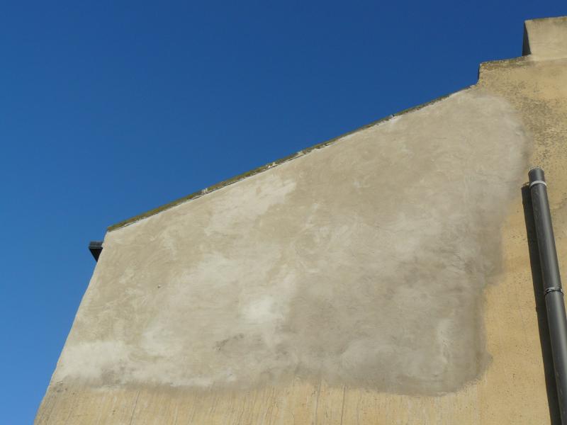

Hi, we have a very old property (c. 150 years), end terrace in a very exposed location in Yorkshire. The gable wall has been rendered in the past, and is failing in places. Where we have cleaned it off to repair, the masonry behind is fairly ropey, with loose mortar between the stones.
There is little or no overhang, and when it rains, water runs down the gable wall rather than down the roof and nicely away in the gutters. We have a problem with damp in the worst-affected bedroom, and in the nearest part of the adjacent bathroom.
The whole row of cottages appear to have been reroofed at the same time, as they all have the same tiles; we have big heavy stone coping stones at the gable end, that the render runs almost flush up against on the outside edge (if you see what I mean).
I've been reading on the forum here about dry verge systems, and wonder whether you guys think this might help, or be a possible solution? We wondered about lead flashing, but aren't sure of the best way to go about fixing this. The coping stones really are huge, and the prospect of moving them is just a little bit scary!

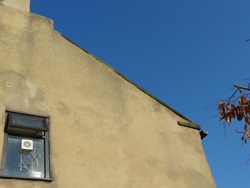

Okay, hopefully I will have attached photos of the gable end. I can't get pix of the roof itself, I#m just not that high, but you can see the edges of the coping stones; these are about 2-3" thick, and about 15" -18" squareish. The tiles are Marley tiles, if I remember what my roofer told me a few years ago, and I understand they're nothing special.
The first photo is of the south end of the wall, and you can see how patched and cracked the render is. The second one is of the north end of the wall, where we have replaced some of the render in an attempt to rectify the dampness inside. This was really badly cracked, and the masonry underneath very uneven, and extending out under the coping stones, so there wasn't really an option of reducing the render thickness enough to make a difference.

So in short (!), the rain's not coming in the roof, it's pouring off the roof onto the external walls, and then seeping in through the pokey render (is my best guess).
