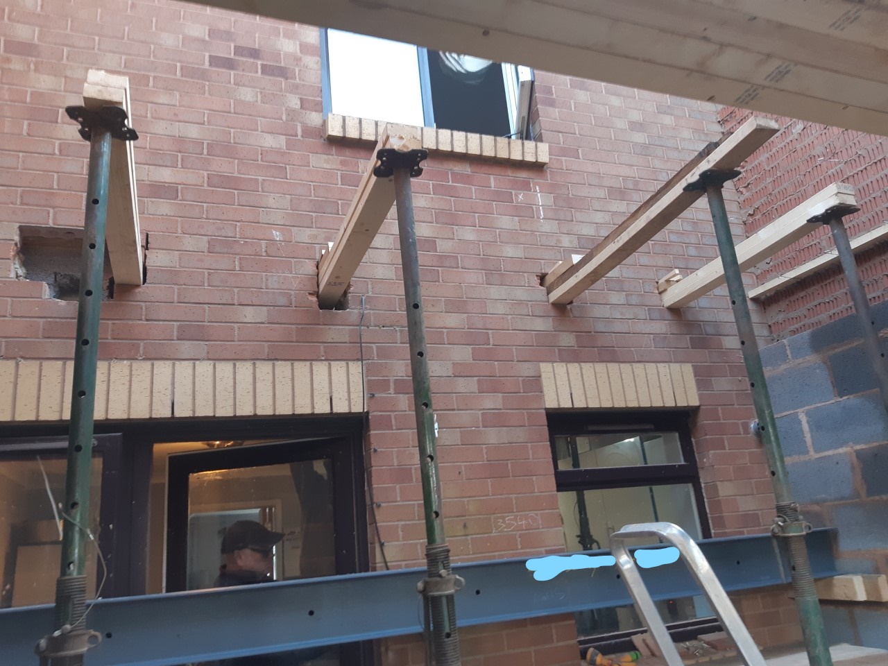

However, the biggest headache is threading the steel beams in or at least having the steel already trapped in between the props - as you can see below.....
That looks like what I imagined :)
So what is supporting the needles on the inside if you can use strongboys for one of the leaves?

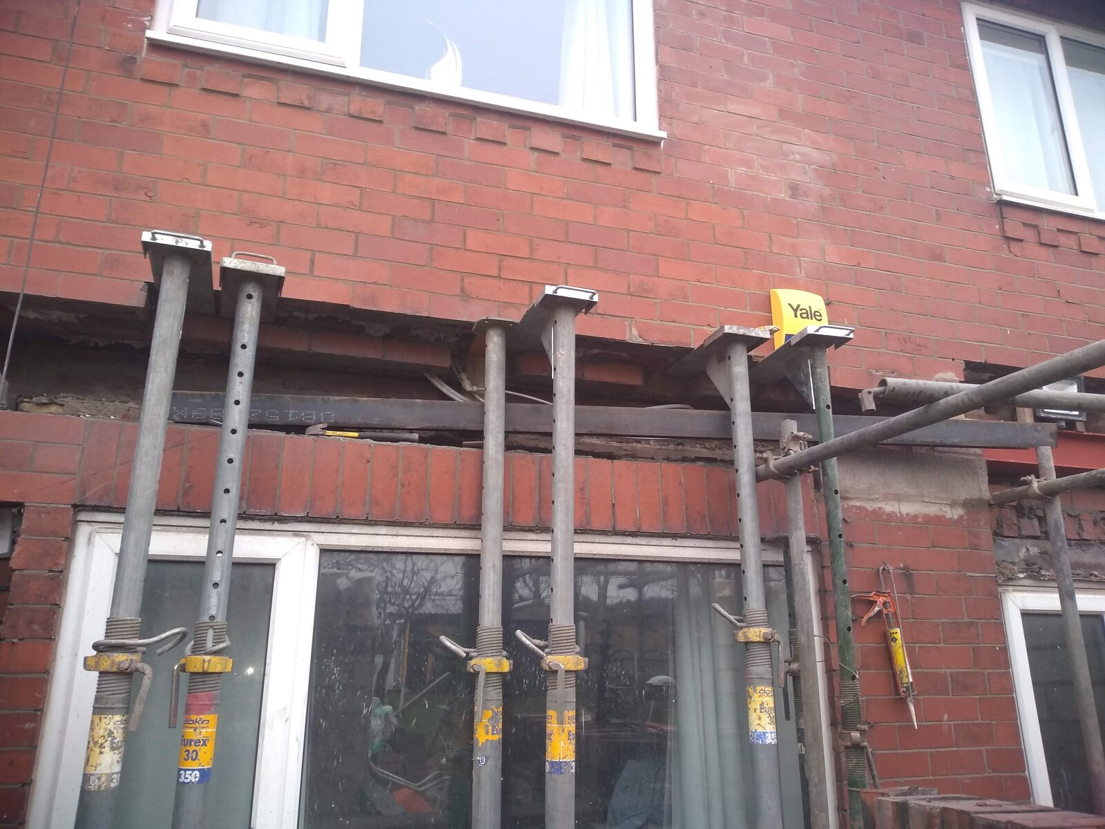

I did both skins with strong boys, because I'd just redone the room upstairs and didn't want to knock holes through the wall. Even less room to squeeze the steels in:
