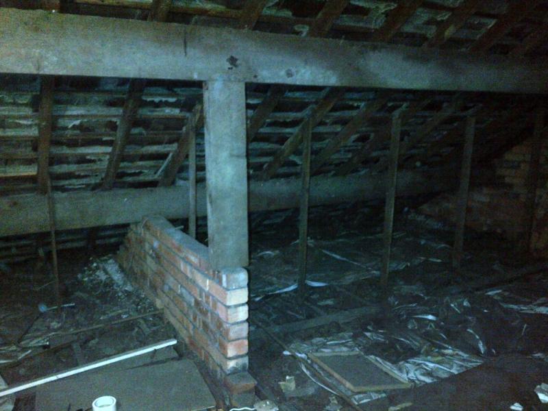

Hi,
I recently purchased a 1930's semi where one of the internal walls was described by the surveyor as a load bearing wall. Downstairs it has apparently been removed and replaced with a stud wall. The surveyor stated he is unsure about the adequacy of support to the retaining solid wall upstairs without destructive investigation but he could not see any obvoisu signs of any structural problems. On the survey he classed it as category 1. The previous owners who lived there for over 20 years say the removal of the downstairs wall was carried out by the previous owners prior to their own purchase so no building reg were sought. I have no idea if a lintel or steel beam was used. Attached is the wall as it enters the attic. Is this a load bearing wall? how would a stud wall support a solid wall for so long? And why on earth would someone remove a solid wall and replace with a studwall?
I'm baffeled!

That wall is load-bearing as it is supporting a purlin prop in the roof.
It is perfectly possible (though unusual) for a timber stud wall to be built to support a brick wall.

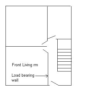

There's only one way to find out, and that's do some hacking out above the opening to investigate whether there's a suitable lintel across the opening on the ground floor.
If the first floor joists go across the room parallel with the opening, and both sides of the opening, then the floor probably isn't supported by the wall. But if perpendicular with the wall, then they are dependent on support from the lintel in the opening.
Either way, the first floor brick wall is obviously dependent on the lintel - if there is one - as well as support to the midway of the roof.
Just out of curiosity, is this wall roughly central along the length of the elevation your house?
Its' not central, as you enter the house the wall divides the entrance hall and the front living room - see attached plan of house. The joists run parallel to the wall i.e. front to back. But in the attic there is a underpurlin prop resting on it supporting the roof. The wall which divides the kitchen and the back dining room also has a purlin prop resting on ti supporting the roof.
