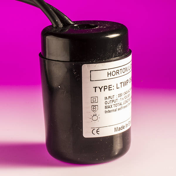

You can get weather proof toroidal transformers 1685865081016.pngone shown is a 60 VA. In Wales the job would be notifiable.
