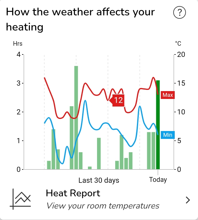

The thermostats tend to have ways to auto modify the way they work, with some pretty charts, 1730496832057.pngone shown is my Wiser thermostat, but since I have both Nest Gen 3 and Wiser, they don't help that much. My Nest was also claimed to learn, but to learn, doors need to remain the same, and sometimes we leave internal doors open, and sometimes closed, in the main left open for the cats, use a door stop so they don't fully close. So I at moment use 9 programmable TRV heads not linked, two motorised valves, 5 TRV heads not programmable, and three wall thermostats, with an oil boiler using C Plan, in a three-story house with 5 bedrooms, two kitchens, two living rooms, dinning room etc. So rather a large house.
I have the intension of swapping some programmable TRV's for linked programmable TRV's, in the near future. But every system is different, because it works for me, does not mean it will work for you. If starting again, I would use Wiser, but not saying that would be best for you.
