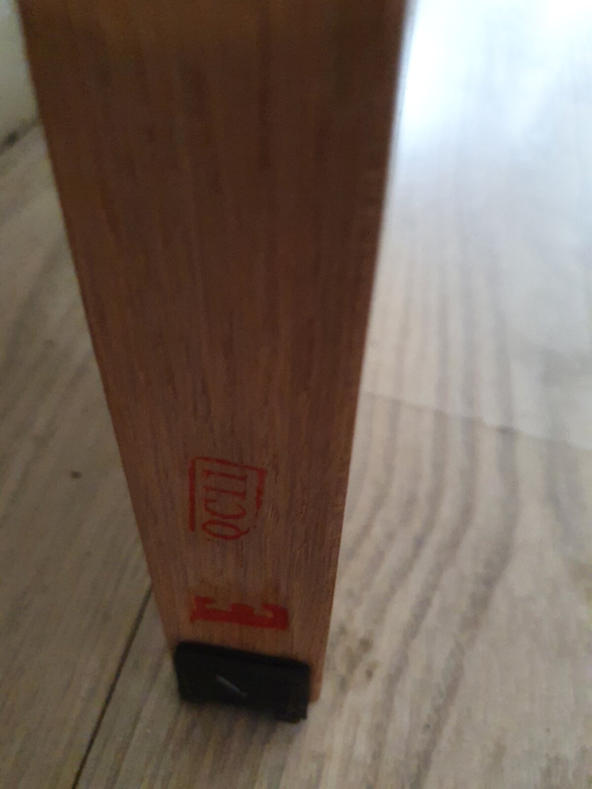

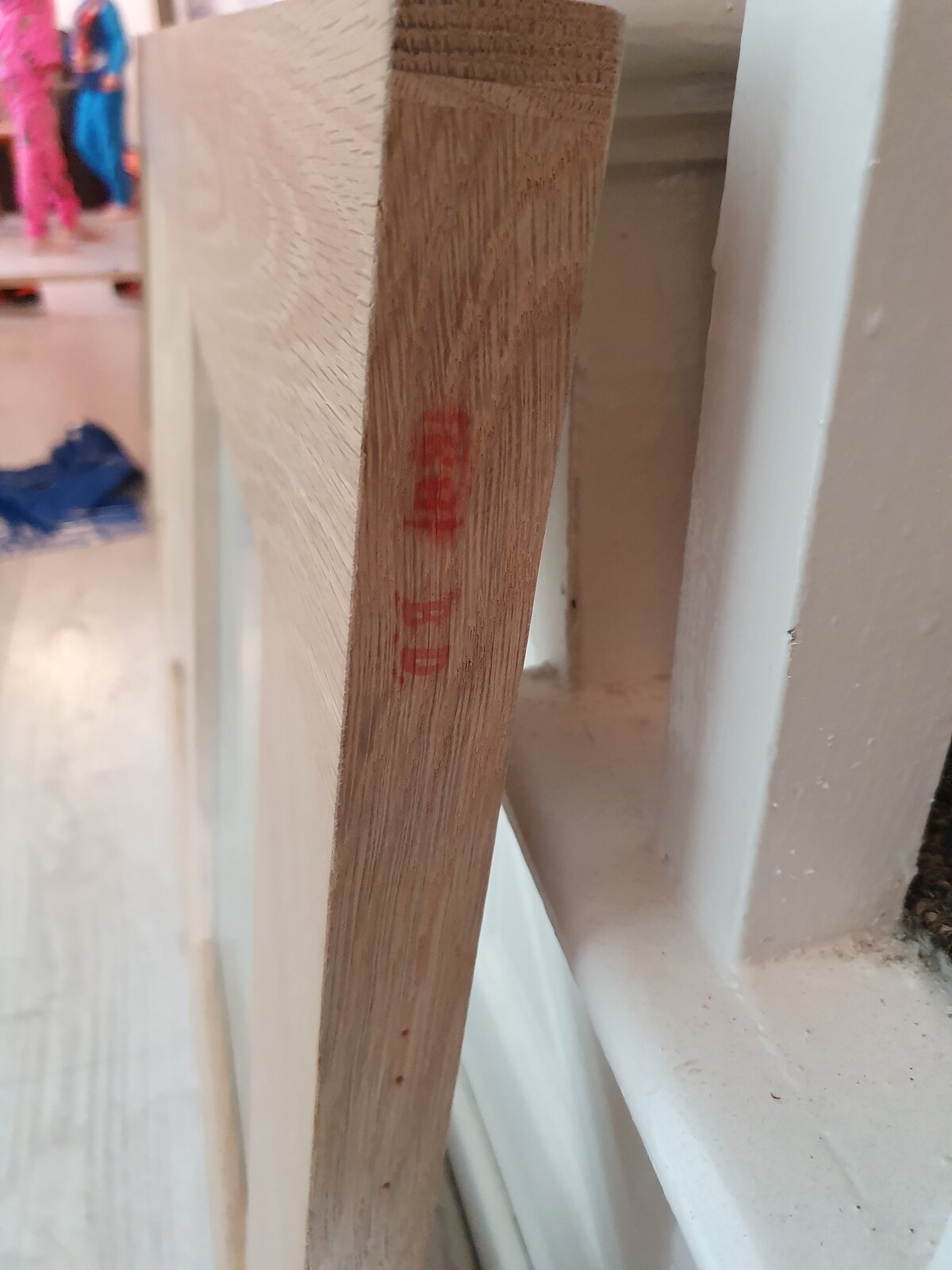

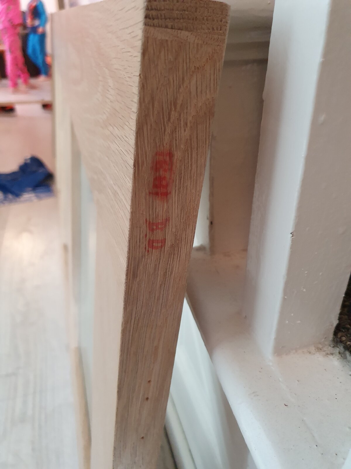

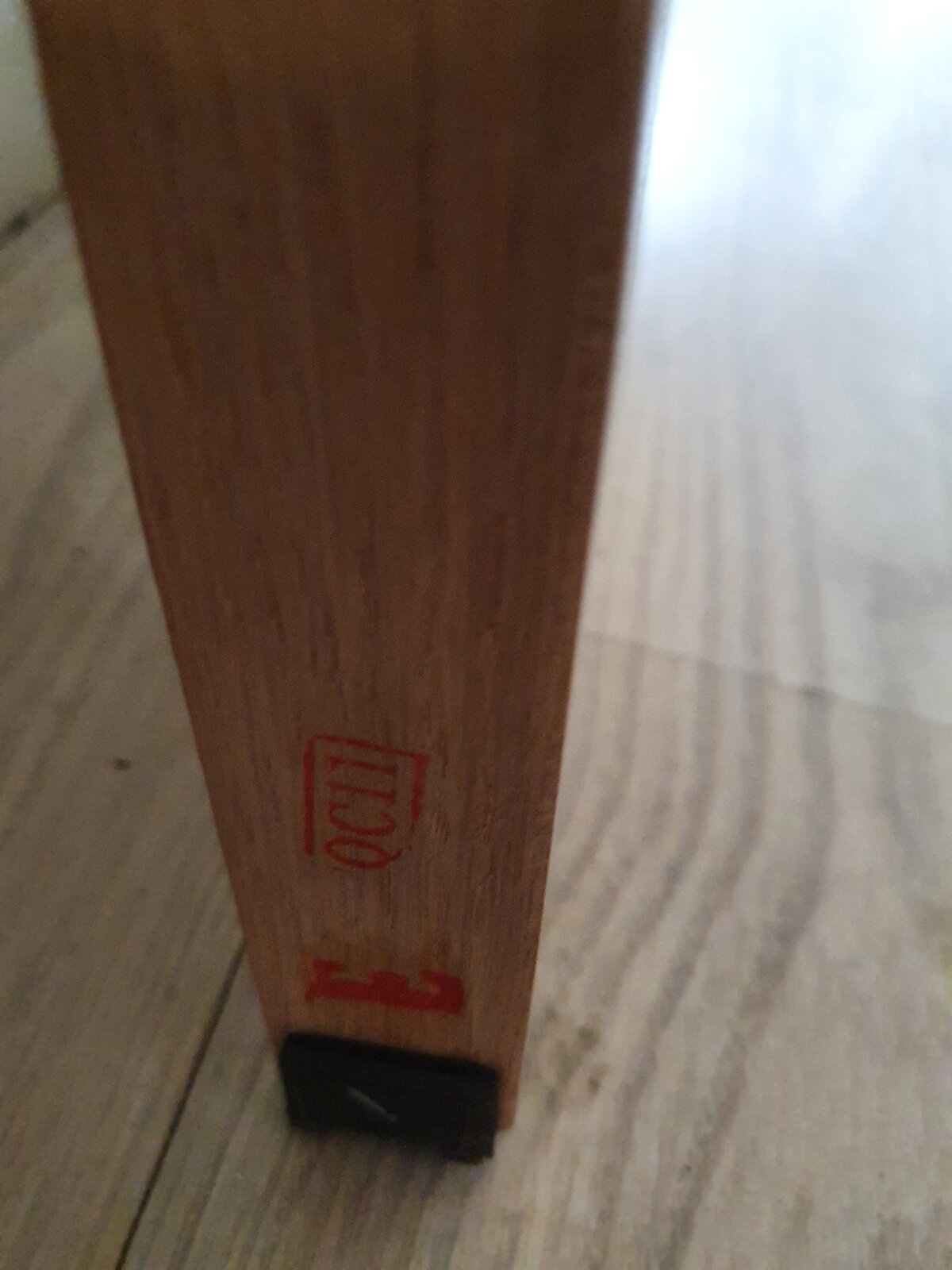

i have got wickes oak veneer doors doesanyone know what side i should fit handles or can they go on any side as its a solid door cheers

if you're sure they're solid, the locks can go either side.
Locks with a block are stamped on the top edge with "lock" on the side where the block is.
I can't read the stamp in your pic, but it doesn't seem to say "lock"
