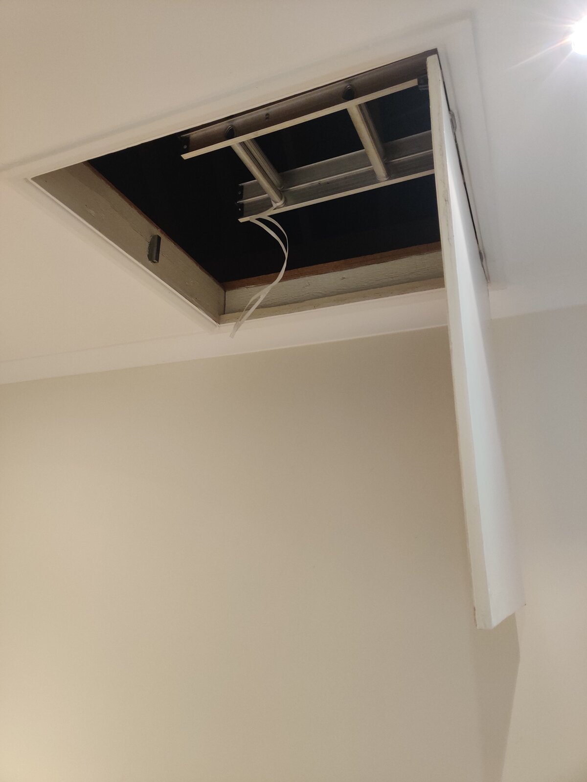

Working overseas, we are renting our house next year and will be storing a lot of personal items in the loft. I'd like to add a lock onto the loft door without it being 'in your face' obtrusive, and slightly insulting to our (unknown) tenants. So a dangling padlock is not acceptable to me. The existing loft door is on a 'push open/ push closed' latch and is 18mm thick. Picture attached. I imagine a 'camlock' of some type, with a recess cut into the wooden timbers to accept the rotating locking 'blade', ideally with an inset facing plate, rather than just a slot in the unprotected wood? I cannot find anything specifically for this purpose, which surprises me. Can anyone point me in the direction of a suitable product? Cheers.
What material?
Couldn't you just fit (a pair?) of rim locks? and if necessary fit a steel plate into the frame with a slot?
Or something similar to this?

Gosh. I wasn't anticipating criticism of locking the loft! As Freddie Mercury's Twin says, the agent will have a key. It would be great for any other specifically designed locks for a loft door, but the gate lock suggested above is still a bit intrusive looking. I was thinking more along these lines: 32mm Camlock
It would benefit from a 'face plate' to make the job neater, rather than just cutting a slot into the frame timber.
Tigercubrider: the door is MDF, I think, and the frame looks like pine.
The slot in the timber frame will be above the hatch door, ie not visible from the hallway.
Yup. That's right. But it might look neater if it had a face plate when open, and as I won't ever remove the lock, it will add to the longevity of the 'female' part of the system. I think I'll go with this 'camlock' solution.

The gate lock is similar to a Yale lock. The bulk is inside the loft with just the key bezel on the house side.
a rim lock would only need a key hole drilled in the MDF. (As on a shed)

To answer. Buy one of these.
Fit and shut with another person in loft to mark the catch location. All easy enough
Cam Tubular Locks 20mm with Alike Keys for Door Cabinet Mailbox Drawer Cupboard Security Locker Hardware Locks https://amzn.eu/d/drdUFRU
It's the same design as some loft hatch catches and will be easy to fit.
Also can't pick or break
Check thickness required before you buy.
You could fit a bolt and padlock but it's not easy to get a latch hole with not much to drill in. Also looks terrible.
