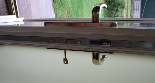

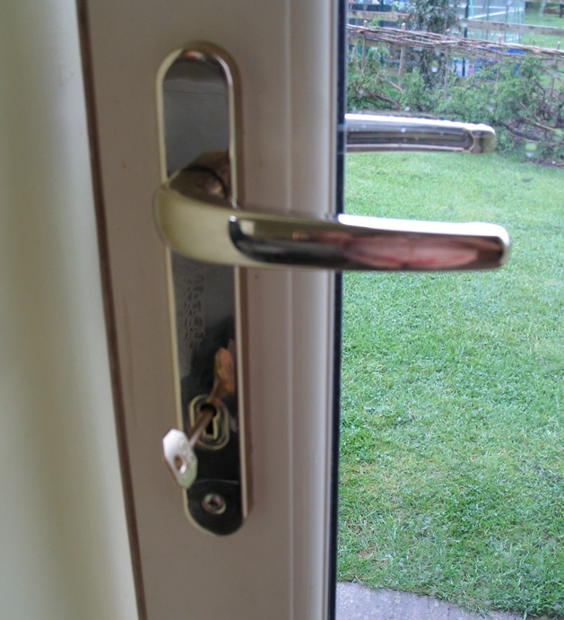

I have to admit from the beginning that I know nothing about door locks so please bear with me. On a 5 year old house we have Vectis externally locked doors. The sort that you pull the handle up before you turn the key to lock them. But the locking action has become very stiff and noisy lately and so I decided to squirt a bit of oil in the lock mechanism and the "slidy" bits that run full length of the door.
Now I find that I can't open the door. The lock mechanism is working much better but when I push the handle down to open the door while it is retracting the locking protrusion it's not retracting enough the angled bit that goes in and out when you close the door.
I have Googled it but if I'm honest I think the lock mechanism (is it called a gearbox ?) is shot. And so my question is : how do I get the lock mechanism out of the wooden door ? Do I have to undo all the screws on the full length vertical plate on the engaging part of the door face ? And if so is it better to take the door off it's hinges to do that ?
Sorry to be so ignorant about such matters and my inept terminology but I would be grateful for ANY help.

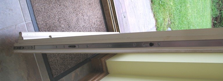

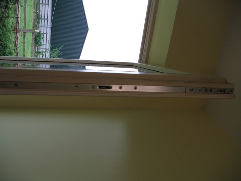

All sorted now (I think !) Took the plate off the vertical surface of the door that interfaces with the door jam. Took the gearbox out and discovered that the rack was in 2 pieces ! So hasty trip to lock supplier and bought a new gearbox (£61.99 !!!). Now fitted and works O.K. except for when trying to lock the door when in the closed position. It works fine when the door is ajar and I think it is either the top or bottom peg that isn't engaging properly with the hole on the top (or bottom) of the door frame.
Many thanks to all who helped.
Door will need adjusting or your new gearbox will break too.
Google "Toe and heal a door"
Basically you need to take the beads out, Lift the door on the handle side and add some extra packers above the glass.
All sorted now. The top pin bolt cavity and upper hook cavity both needed adjusting. Thanks for all the help.
