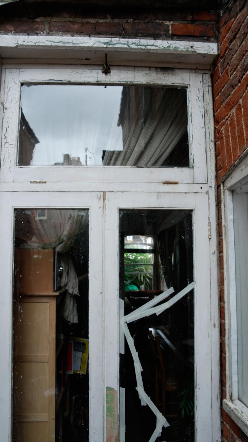

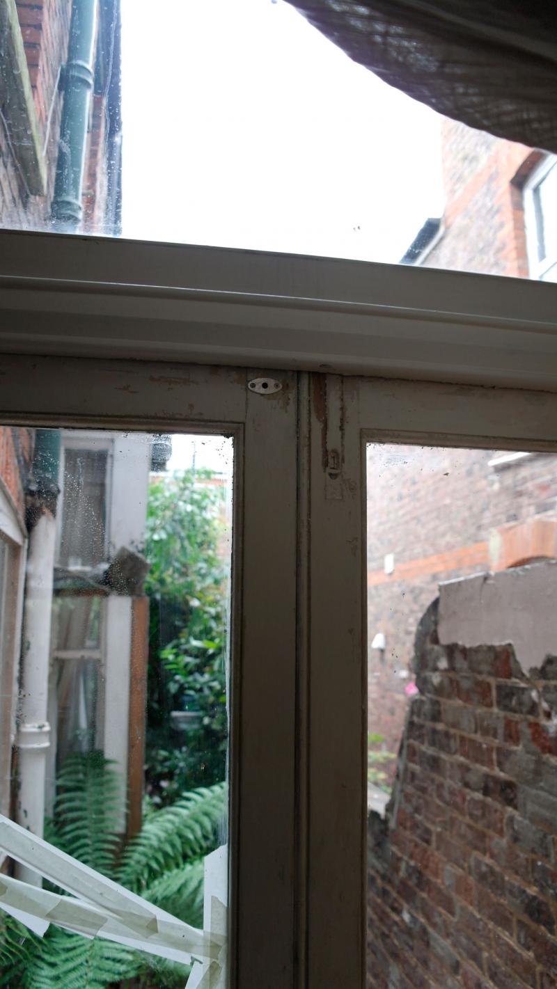

I've uploaded some images of the doors.
Someone currently placed a flush bolt on one of the doors both top and bottom and also included some other paraphernalia along the way.
As with regards to replacing the doors, it would mean I would have to replace the entire frame and I don't want to do that.
I will be replacing the window above to a piece of glass only, possibly stained glass (dependant on cost) and the same for the glass in the doors.
However as I stated my main concern it the locks I can install. The beed on the doors are part of the door and cannot be pulled off. The doors also have gun stops which probably doesn't help.
if was my door, I would leave the top alone if both bolts work, and fit a pair of universal bolts to the bottom
that pressed rimlock is rubbish
And is it on the outside of the door :eek:
