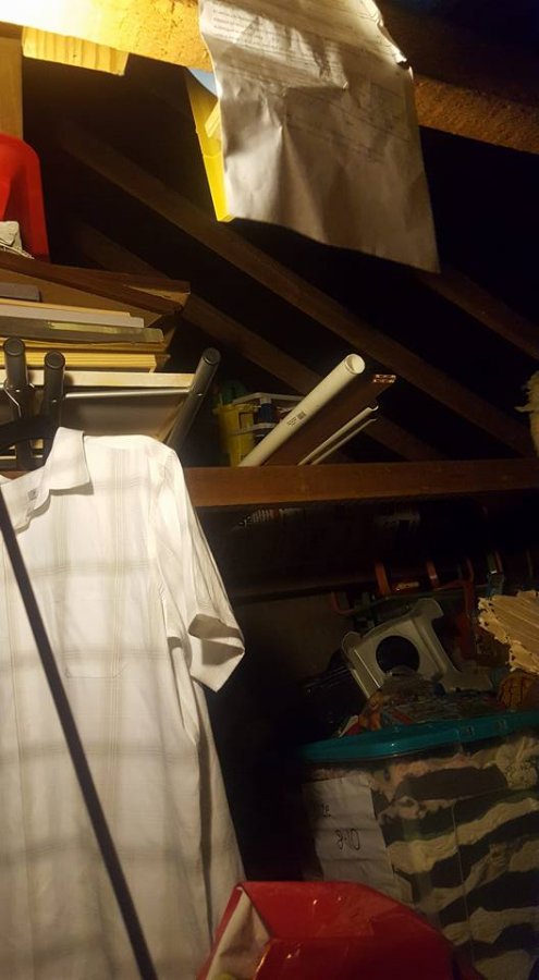

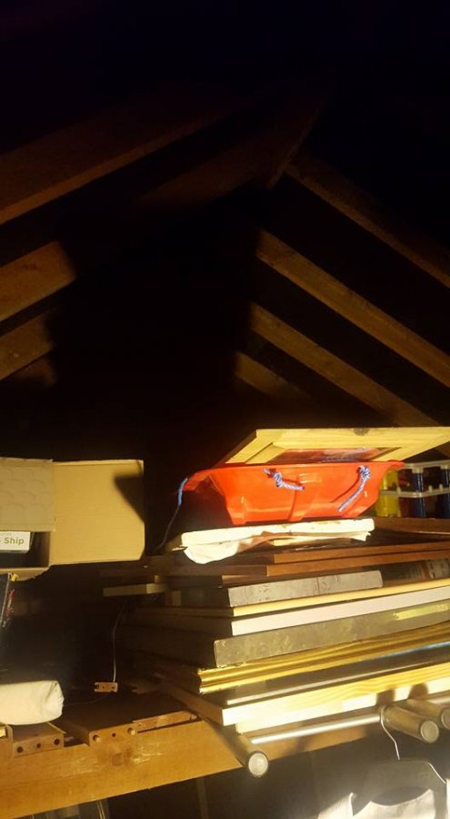

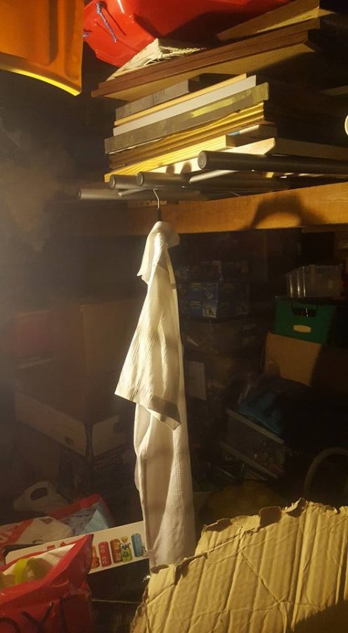

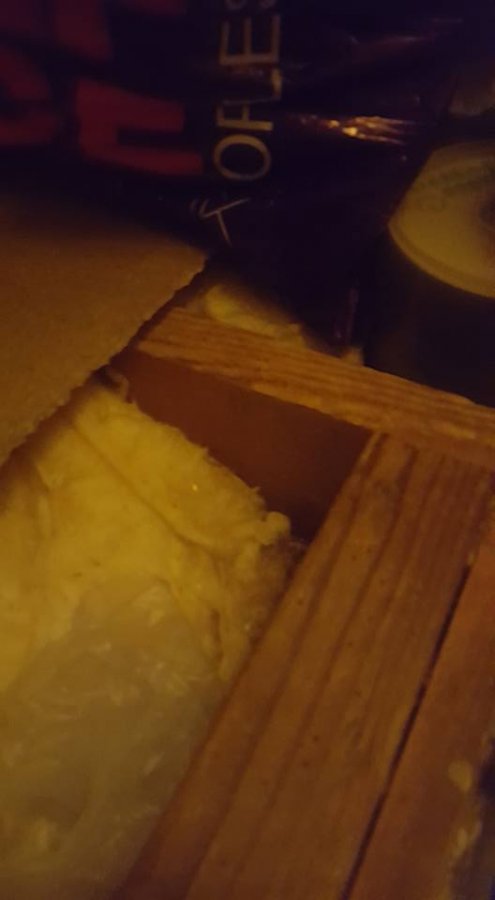

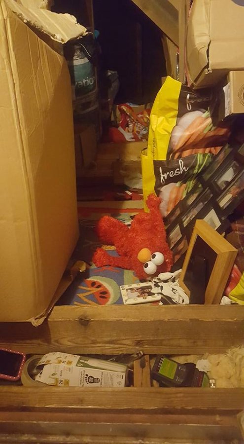

15181399_1826074447665003_3574202159324861986_n.jpg 15241753_1826074400998341_1759441720133675317_n.jpg 15171180_1826074367665011_5243412153284682436_n.jpg 15171051_1826074327665015_2408416245697736174_n.jpg 15203165_1826074307665017_8144087479766446190_n.jpg 15134624_1826074280998353_7610771813358169506_n.jpg 15219548_1826074237665024_6479973283488109269_n.jpg 15181240_1826074197665028_5989315967072610390_n.jpg 15193456_1826074170998364_25491379438366280_n.jpg 15241365_1826074144331700_3692250206667744889_n.jpg

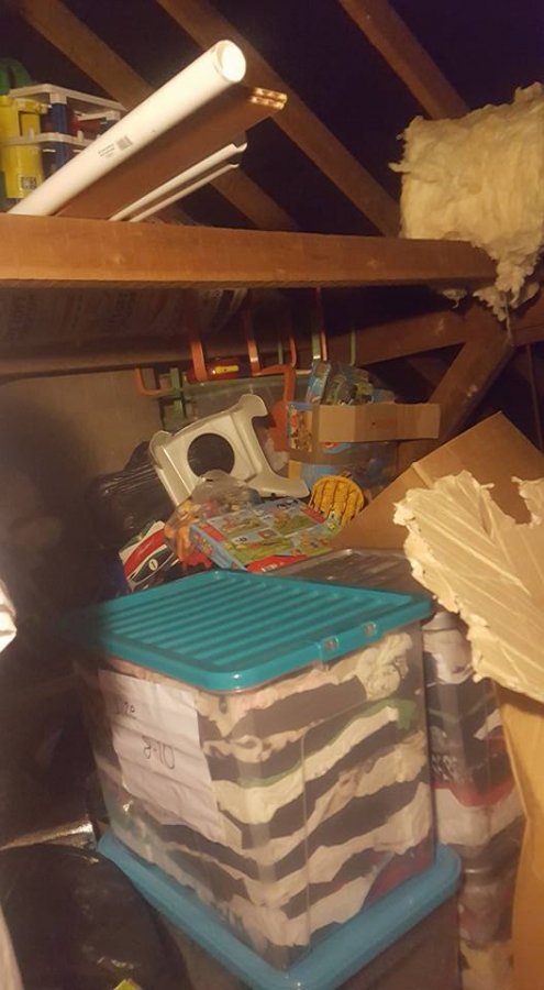

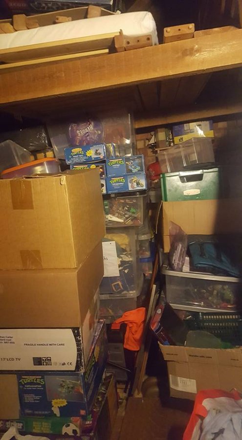

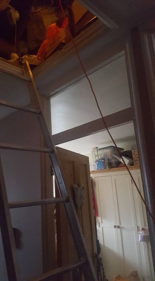

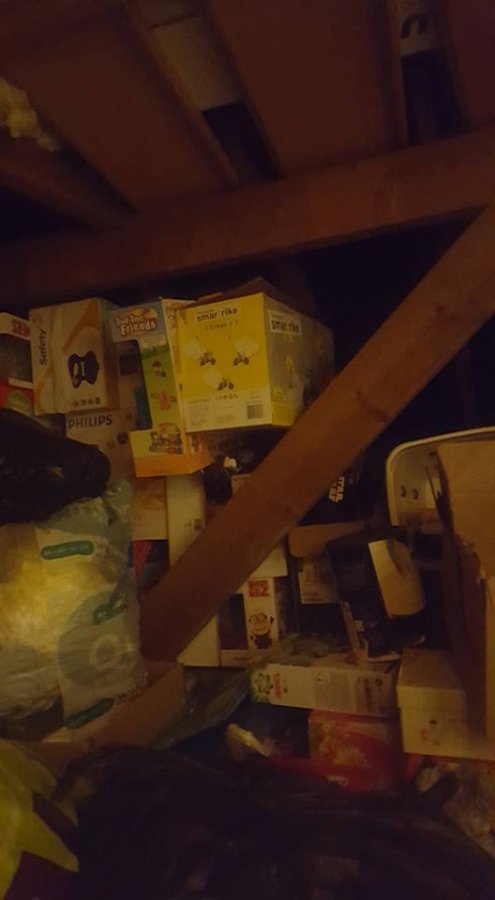

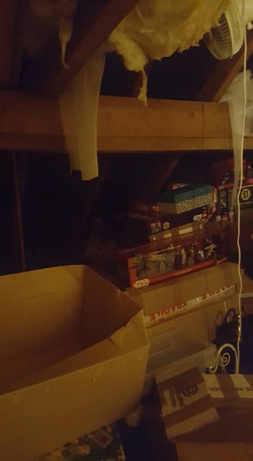

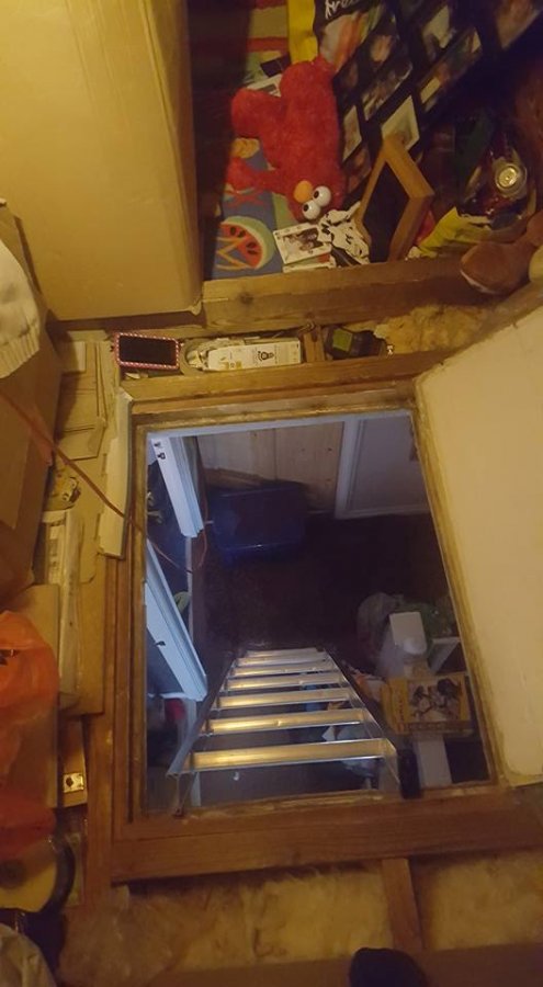

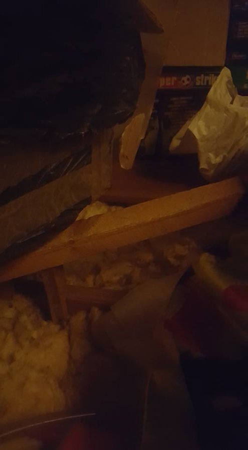

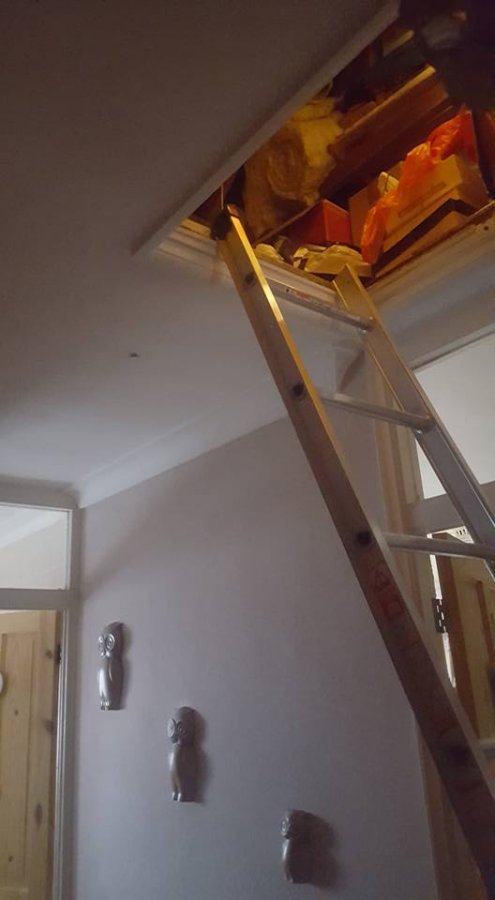

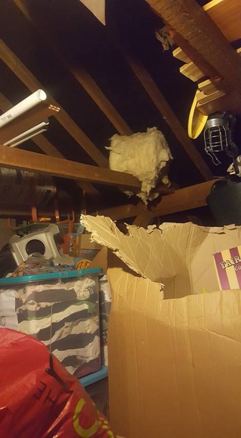

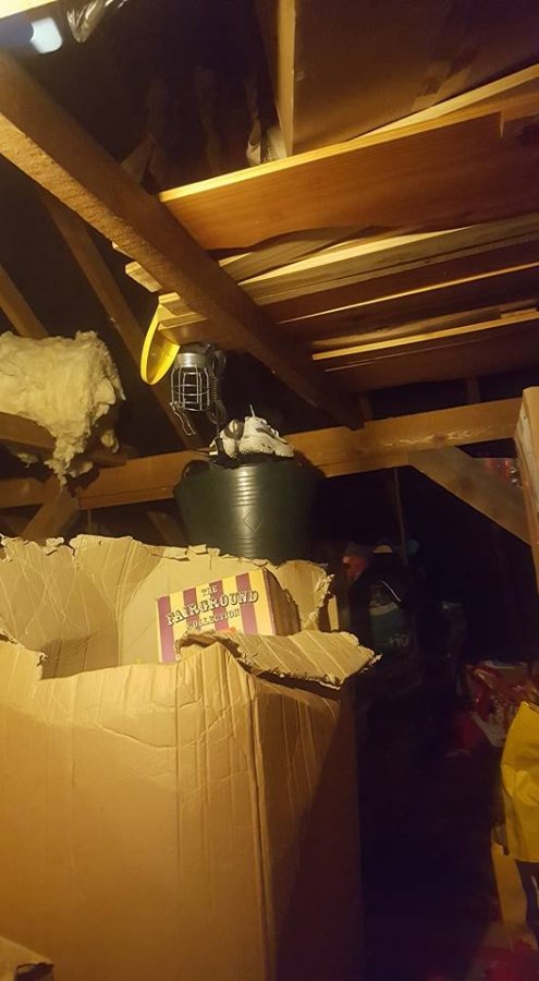

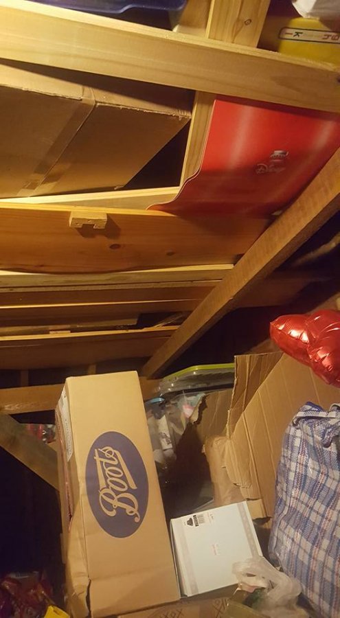

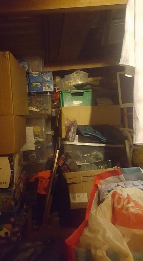

as you can see i have a lot of stuff up there - even on top beams. I have used old desks/cupboard doors and some loft boards (not screwed down) to support the stuff across the beams. I havent got much floor space left so had trouble taking some photos
Sorry TV, but you'd need to clear a good space for us to see the joist layout. Great pictures of the amount you managed to stuff up there, but we can't see the joists, nor the layout to be able to advise you properly.
