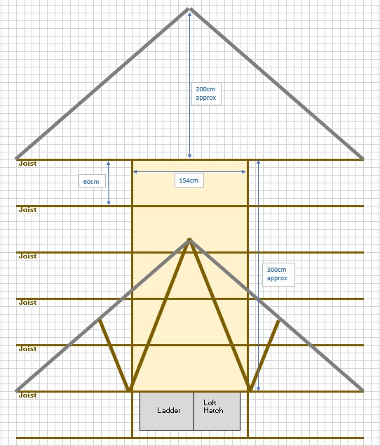

I'll attach a crude diagram I've drawn (inexplicably in Excel, I have no idea why) to show the loft layout, and where I intend to board (the beige area). Joists are 60cm centres. I've drawn in one of the trusses(?) to show the supports. House was built around 1981 I think. 3 Bed detached, timber framed. South-East England. Let me know if you need any other information.

As a reundant truss designer, your roof trusses will have been designed to support your weight wandering around in the roof space on an occasional basis for maintenance etc, and also for storage of bits and bobs up to 250 newtons per square meter, (approx 25Kg). The size of the timber used will have been designed for those loads, and your truss span is only 4.5m, so 72mm timber is fine, it is only unsupported for 1.5m.
As for boarding, using bearers across the joists won't make the trusses stronger, but it will help with load sharing across multiple trusses. In practice this means that the overall load applied cannot be any more than the 25kg/m2, but you will get away with the load being concentrated in one point.

Yes, that's right. The weight of the battens and boards should be knocked off the 25Kg/m2 but in reality, the trusses will carry considerably more than that without any problem. I'm just learning about the condensation issue, which seems to be of more concern than overloading, and i am beginning to think it is probably not wise to board above bathrooms, and especially shower rooms.
