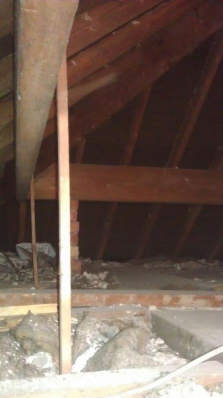

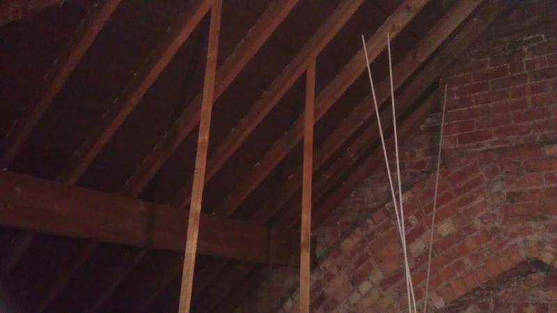

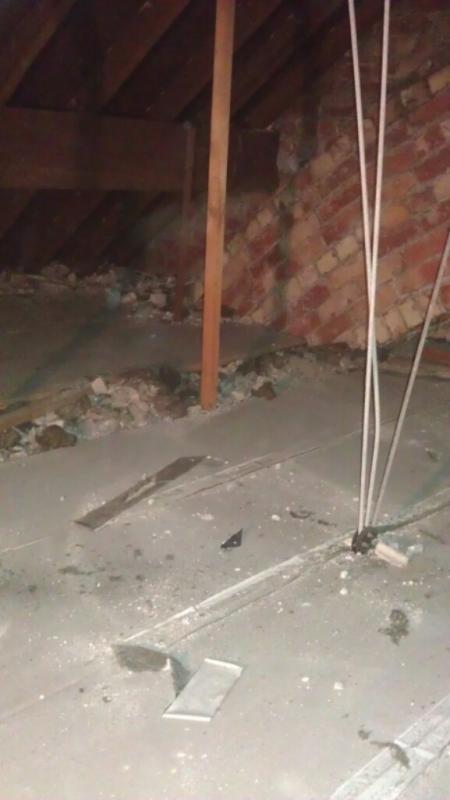

Im 99% sure its not a trussed roof (ive added pics below)
We've lifted up the old boarding which shows the cealing beams/joists.

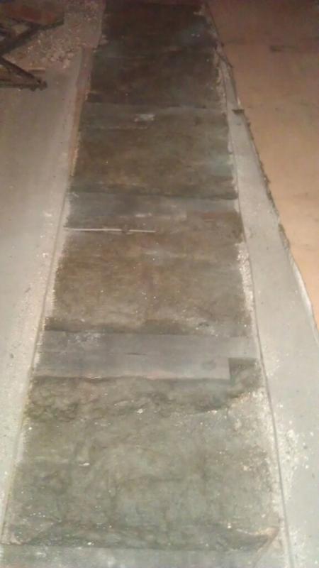

Q1) As you can see the beams/joists are joined together with nails - Is this normal?
Q2) Where the joins are is pretty much where we want to add the new hatch, is this still ok? Is it safe to cut the beams there?
Q3) The wall that runs under (at 90 dgrees) the centre of the loft is a stud wall is this likely to taje the weight of boarding and storage? You can see the wall ties poking through on the pictures.
Any advice/ suggestions would be greatly appreciated! Even if the advice is Dont do it! :LOL:
Its not a truss roof, its a traditional cut roof with purlins.
Q1, nails are pretty common and fine
Q2, if you are referring to the ceiling joists staggering then chances are these are over a load bearing wall below. Measure out exactly where you want the hatch and mark it out up there. Cutting 1 joist and trimming is fairly easy and shouldnt effect the overall ceiling.
Q3, its possible, does this stud wall run under the staggered line of joists? pull up the insulation and see if you can see the top of the wall.

The joins in the beams or joists shown in the last picture - are not over any wall. The wall under that side of the loft is a stud wall and is 2-3feet to the left of those joins.
We dont know if there was originally a brick wall, stud wall or no wall there. But we think it has been moved further towards the back of the house at some point. (left to right on picture)
Im not sure if there are any more joins or just the one in each beam as i havent pulled up all the boards & wool yet.
Is there a particular part of the beam which is best to be cut or doesnt it matter? ie just cut wheerver we want the hatch to be even if its cutting through the joins in the beam?
Pull up some more of the insulation around the staggered joists and take some more photos.
