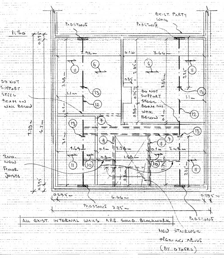

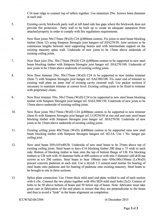

I'd be interested to see any drawings and structural calcs that you've had done.

Would be good to see the drawings for it (y)

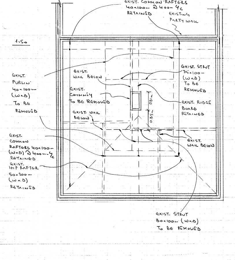

Are the steels only supported at the ends? I guess you bolted them together in situ.

Did you get quite detailed instructions regarding the building from the SE or BC, in particular the support etc or did you wing it.

Steels are supported on concrete pads at either end. Two in the party wall and two on the external side wall. Because of the hip roof the beams had to be cut at an angle and had a flange plate welded onto the bottom. In hindsight I should have extended the hip roof and done a dorma conversion. Don't forget to get a party wall notification done. Templates online.
Yes we bolted them together in situ. Took 4 to carry in and up and support etc.

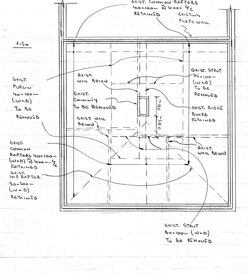

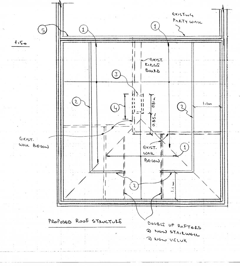

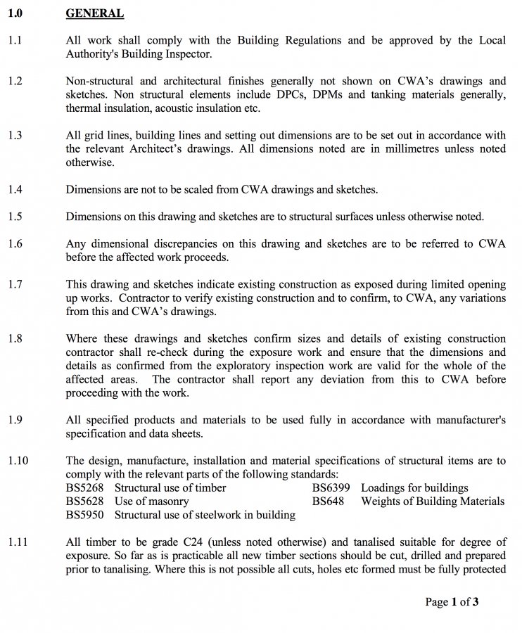

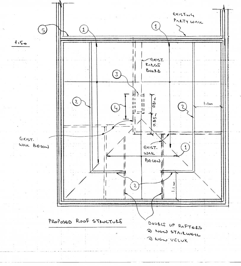

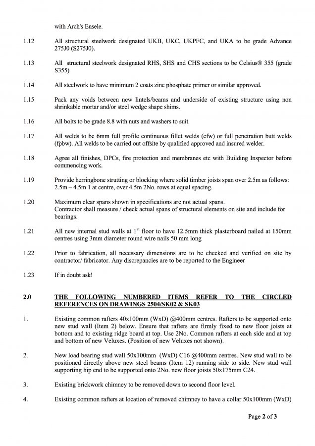

SE details were pretty detailed in terms of where to place stuff and what was needed. It read more like a shopping list than a design.
The drawings themselves looked as though they'd been done by a child!!
They specified the steel positions and the horizontal wood beam positions but not the verticals. Under advice from builder friends and the Haynes manual I doubled up the existing roof beams and placed the vertical support studs onto a wooden head plate on the steel beam. The only winging so far has been the plaster boarding because I knew the plasterers would make good.

Looks like I can upload drawings here:
