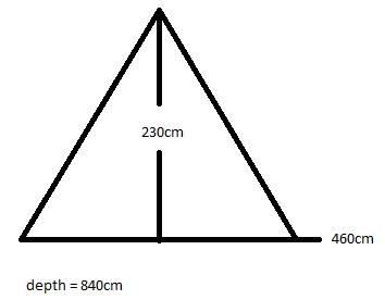

Thanks for your responses, i just thought i'd go up into the loft to take some measurements because if there isnt enough space up there in the first place then theres not much point going any further really lol
From apex to ceiling joist it is 230cm, width 460cm and depth 840cm.
do you guys think that will will be adequate?
im about 5ft 8 and when i went into the loft it seemed like there was plenty of headroom but putting personal preference aside i remember reading somewhere that the minimum needed was about 2.3m? im guessing that i'd just be on the borderline to meet the legal requirements?

Believe it or not there is no minimum headroom for lofts or for any other rooms in a house for that matter, only over the loft stair which needs to be 1.9m. You will have to get a stair in too of course which can be fun.
Is that 2.3m to the top of the ridge board or the underside? I have assumed it is to the underside of the ridge board. Now 2.3m once you take off a bit at the top for insulation etc and take of some space at floor level is gonna leave you with sweet FA, ordinarily you would add a structural floor on top of your existing ceiling joists, with some good design though it may be possible to get this structural floor depth submerged into the depth of your existing floor joists which should help with your head height a little. But whether you have enough space to make a conversion practical or not would need to be determined. I would estimate that if you (or you Designer & your Structural Engineer) applied some good design to how the floor worked you may get away with 2.1m from finished floor to underside of ridge. As mentioned there is no minimum ceiling height but if you ended up with 2.1m this will inevitably put some buyers off down the line but then as a bedroom for a teenager it may not be such an issue. Realistically you are probably going to have to consider a dormer too if you want to be able to stand anywhere but immediately under the ridge. It is possible to lower the ceiling of the floor below but this is rarely practical.
