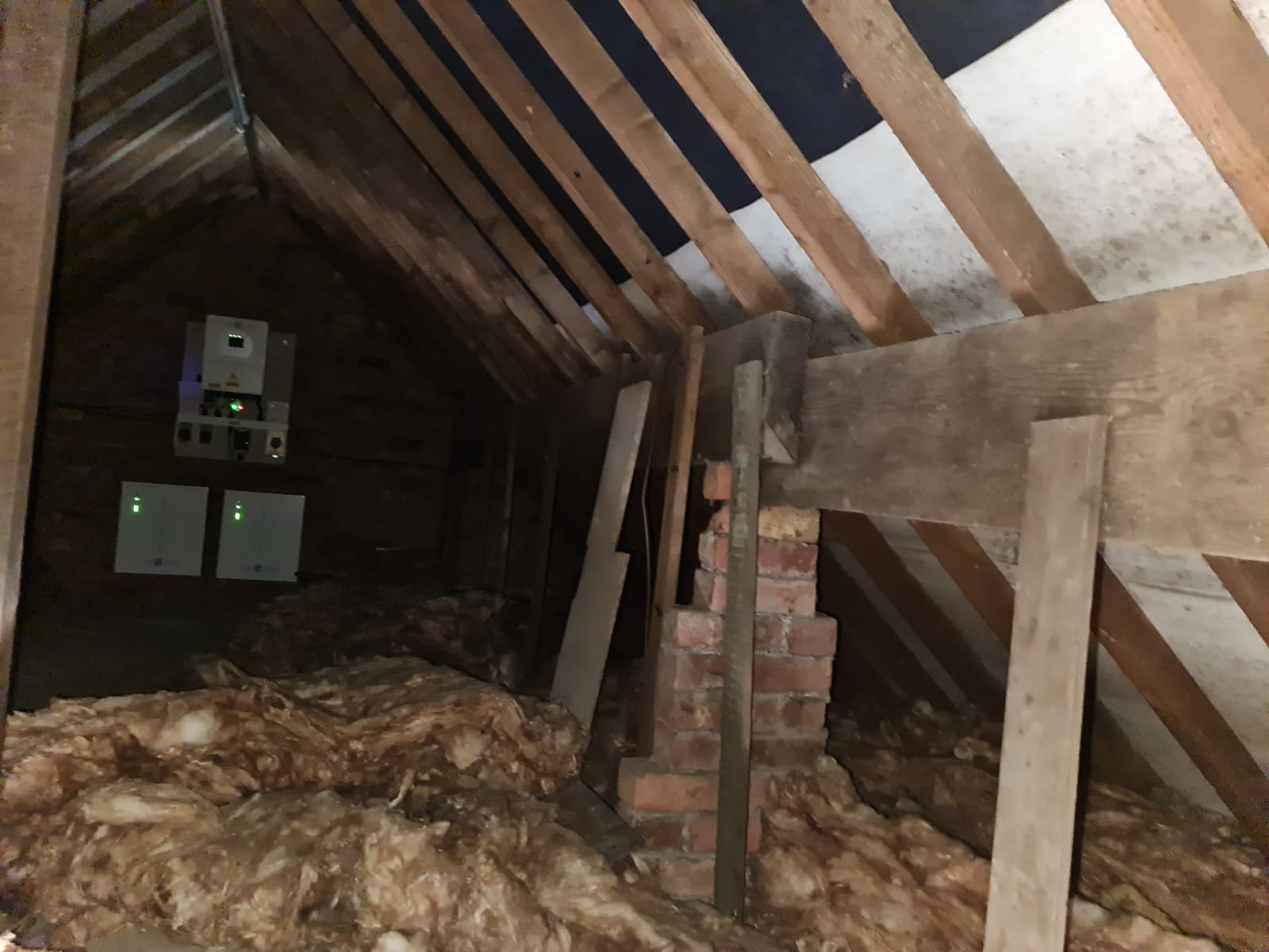

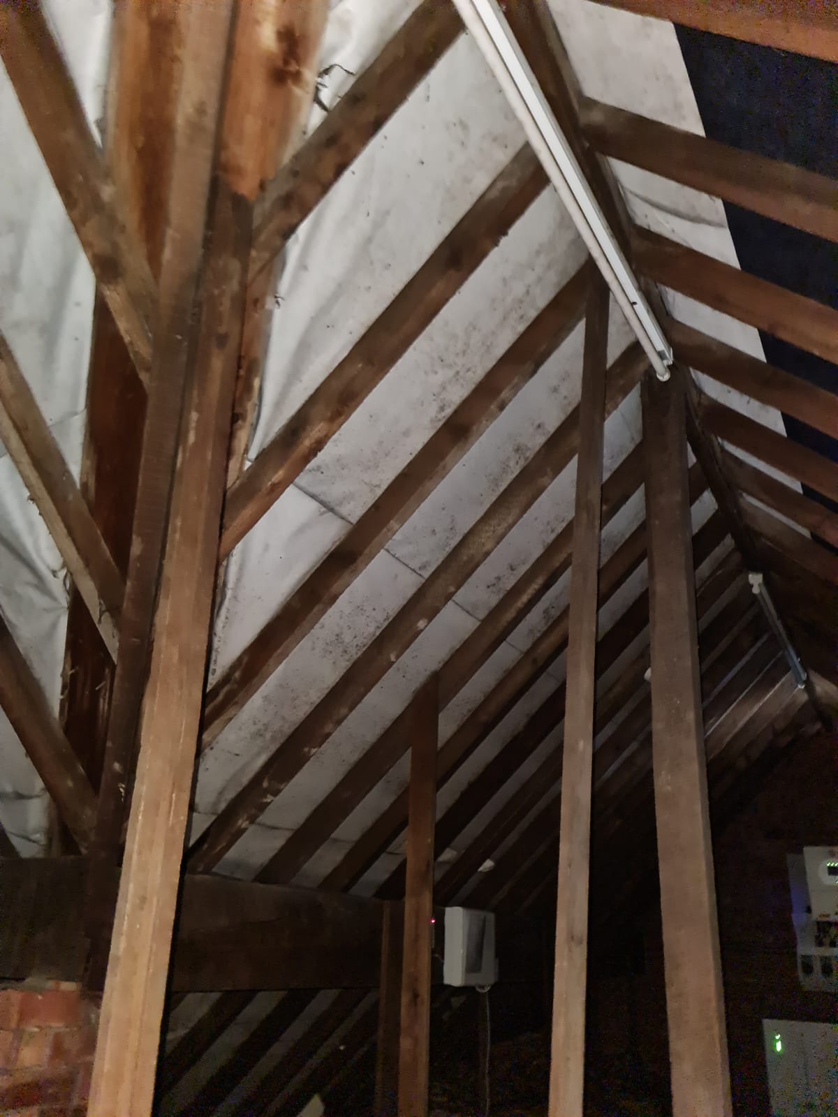

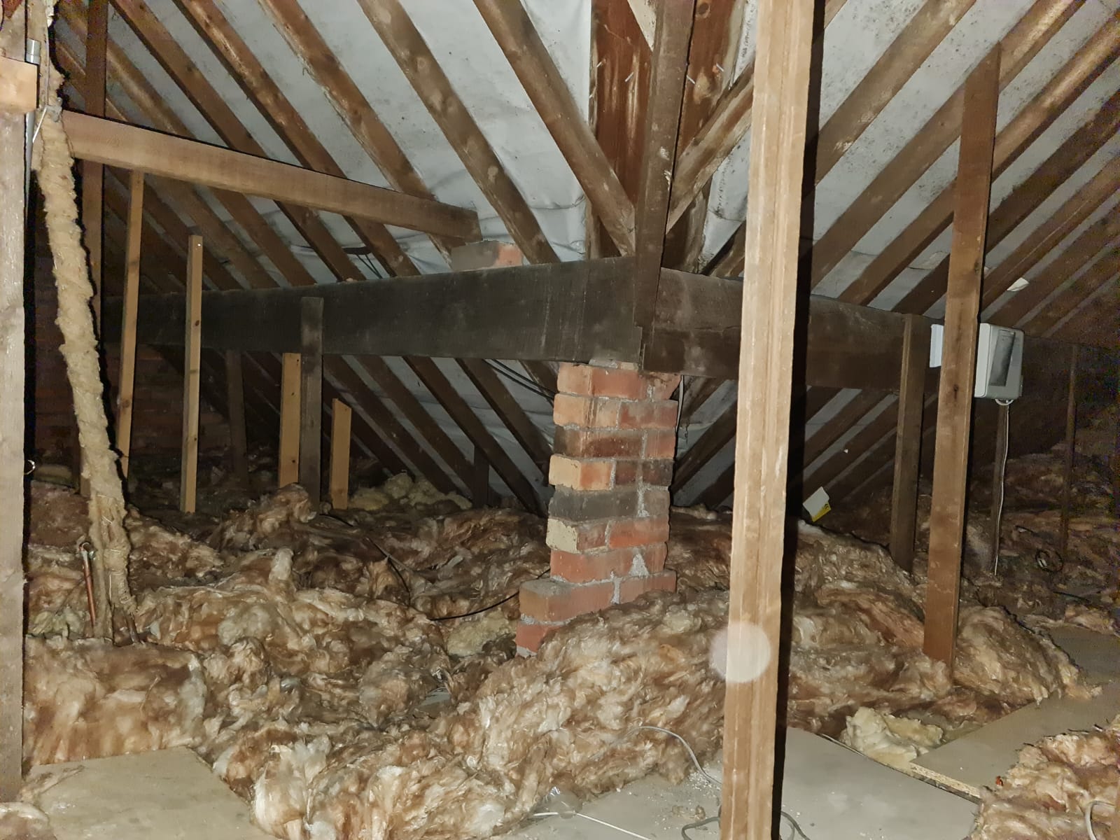

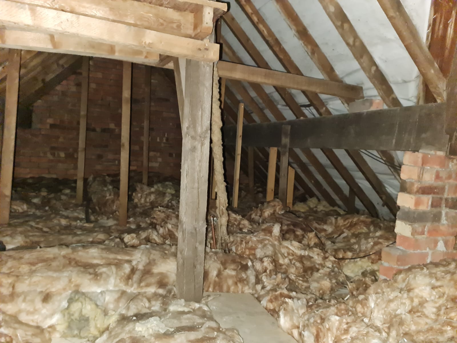

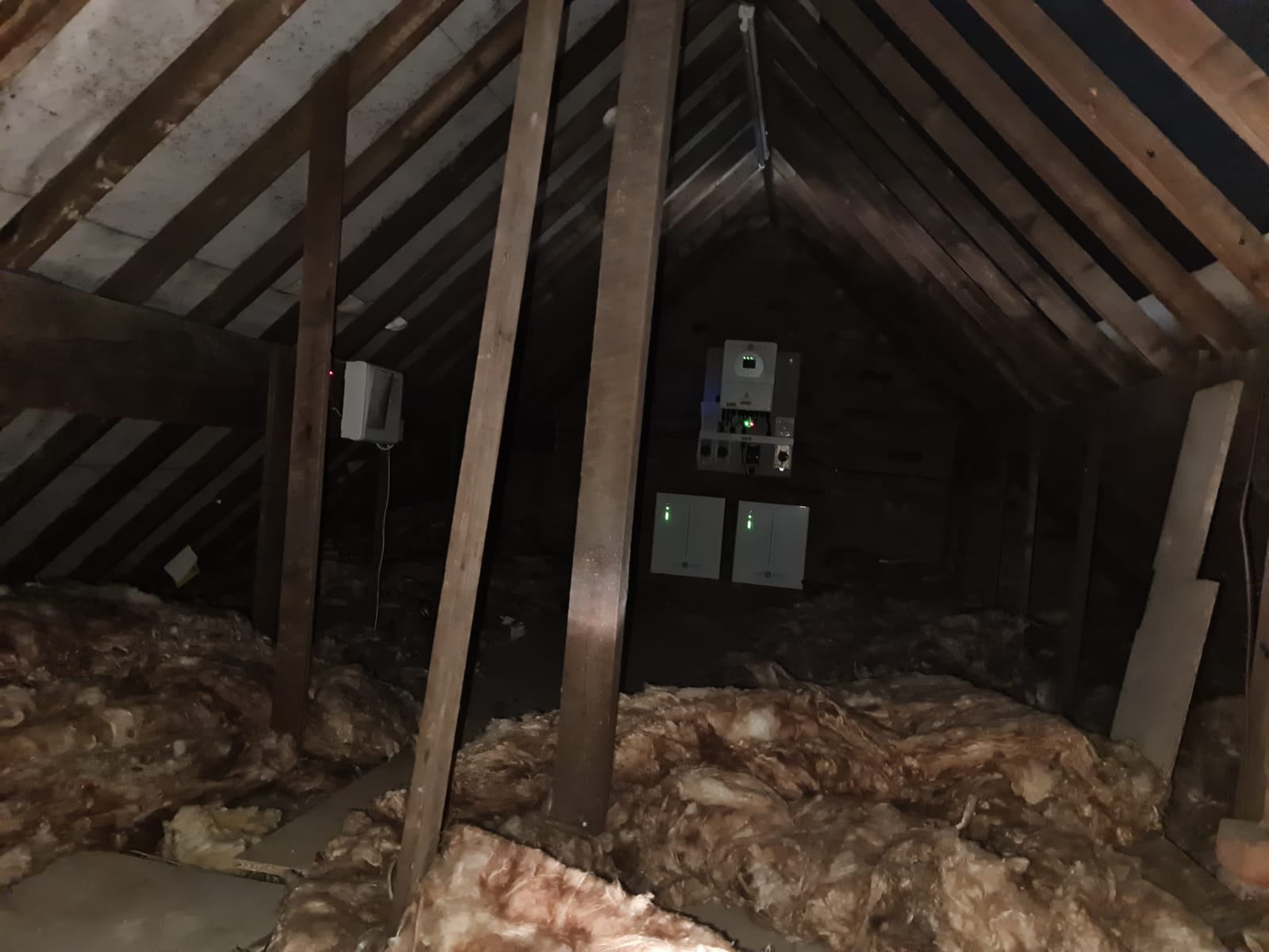

Hello,
Someone has asked me to give them a quotation on converting their loft into a storage space, with the future intention of further conversion work i.e., they may later make the loft into a dormer conversion.
For now, they asked me to give them a quotation for installing the floorboards, with insulation drywall on the roof.
The things I am not sure about are:
1. Whether or not the joist would need to be reinforced / new joist fitted?
2. If the roof rafters would need anything done to them before fitting PIR insulation boards and plasterboard?
3. What would need to be done to remove the wood supports that come from the center of the roof to the floor? (I presume they are there to support something?)
-The floor area is Aprox 20-25 sq meters (in an L shape)
Room height is 2.5M
Thanks!

Installing floor boards for storage is one thing, loft conversion is major work , if you are asking here probably out of your depth .

ok my thoughts to convert to storage perhaps 500-1k
same to in future to comply with building regs if required perhaps 5+k so not an easy job
you need to comply with insulation structural requirement and head clearance amongst other regs
in general the ceiling timbers is to hold the ceiling up up so floor timbers need to be around twice the size
all work needs to be passed and checked by building control at stages as required so your work done now may not count as not quantifiable at a later date

I've done a few of these jobs and always advised to lay new floor joists so they will be already there when loft is converted.
It's not the easiest job without touching the roof, but very doable even by a competent diyer.
The most essential thing is to get a structural engineer involved so to plan the loft conversion and do the floor accordingly.
In other words, you'd be doing a bit of the work in preparation for the conversion.
Otherwise, if it's only for storage, get some chipboard flooring 22mm and board the existing joists.
In this case, at conversion stage, the boards will need to be lifted and could be reused.
I will guarantee that once the home owner realises they'll need a design for the loft conversion, know exactly where the stairs would go, need an SE design, a couple of steels, some beefy floor joists, get Building Control on board, what started as a flippant idea will turn into £10k+ of work, the'yll end up just laying a bit of chipboard on top of the existing ceiling joists.

I have looked at doing exactly the same; creating a usable storage space, with the intention of converting later on.
Basically, as soon as you start making structural alterations to the roof space, building control need some involvement.
If you install adequate floor joists, insulation and improve access, it makes sense to make changes that will pass BC for a loft conversion; in doing that, naturally, you are creating a habitable space, which may require extra work regarding escape routes, fire doors etc.
Alternatively, you can go purely down the storage room route, making minimal changes, not involving building control, but accepting that any work you do, will likely be completely undone when you create the conversion.
If you want a loft conversion at a later stage, it seems to make sense to create it as a conversion, from the start, even if you leave it as a shell.
Regulations also change, any work you do now, may need redoing in the future anyway.
I went down the second route, strengthening the joists and reboarding. It is definitely not a habitable space, but is much more usable.
