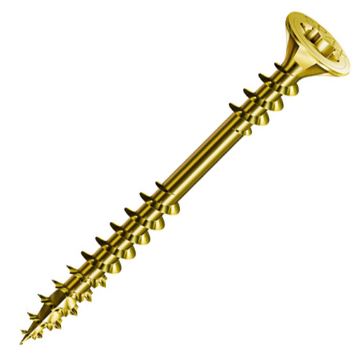

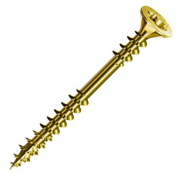

Purpose-made flooring screws for man-made boards are often fully threaded with a small reverse direction thread at the very top of the shaft, just below the head, like these Spax ones:

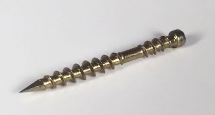

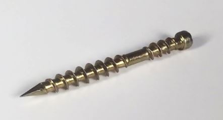

and these Reisser ones:
Closer to home, even Toolstation sell that sort of screw in smaller quantities.
Note that this type of screw generally requires a high torque drive bit (such as Robertson square drive or Torx) ratrher than the more usual Pozidriv/Supadriv or Phillips bit. Also note how small the head is on some of these - this is to permit sinking of the head into chipboard without the need to pre-pilot drill

I would never use those in chipboard .
Reissers's chipboard screws are really good, but they're not those ones. The Reisser Cutters are designed to cut their own pilot and their own countersink, you just bang them in with a driver, they're ace.
The reason for the smooth shank is so that if you don't hold the boards down when you screw them in the board will jack on the thread, the smooth bit takes the jack out again. The smooth bit will let the board rub and squeak. If you aren't being a lazy arse doing them as quick as you can, the fully threaded screws will leave you with a better floor.
