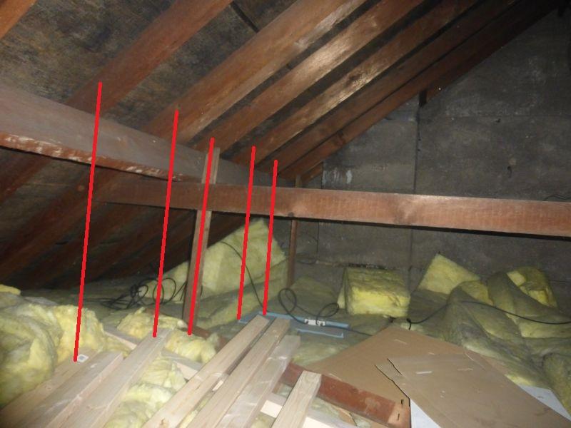

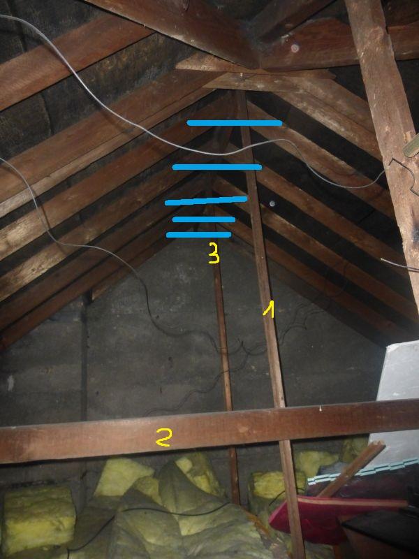

loft conversion for storage
6 Feb 2015
Manchester
I'm planning to convert my loft in to storage. But i need advice on removing roof support. I will remove pieces 1, 2 and 3 and the install new pieces of wood where blue lines are. I will also put 1.5inch x2.5 inch pieces where my knee wall will be. as on second picture. Do i need any additional roof support?
