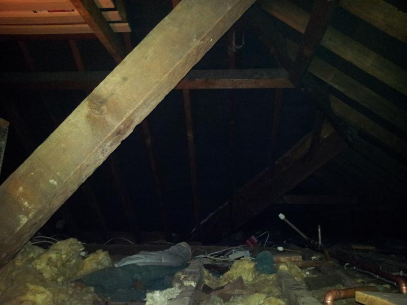

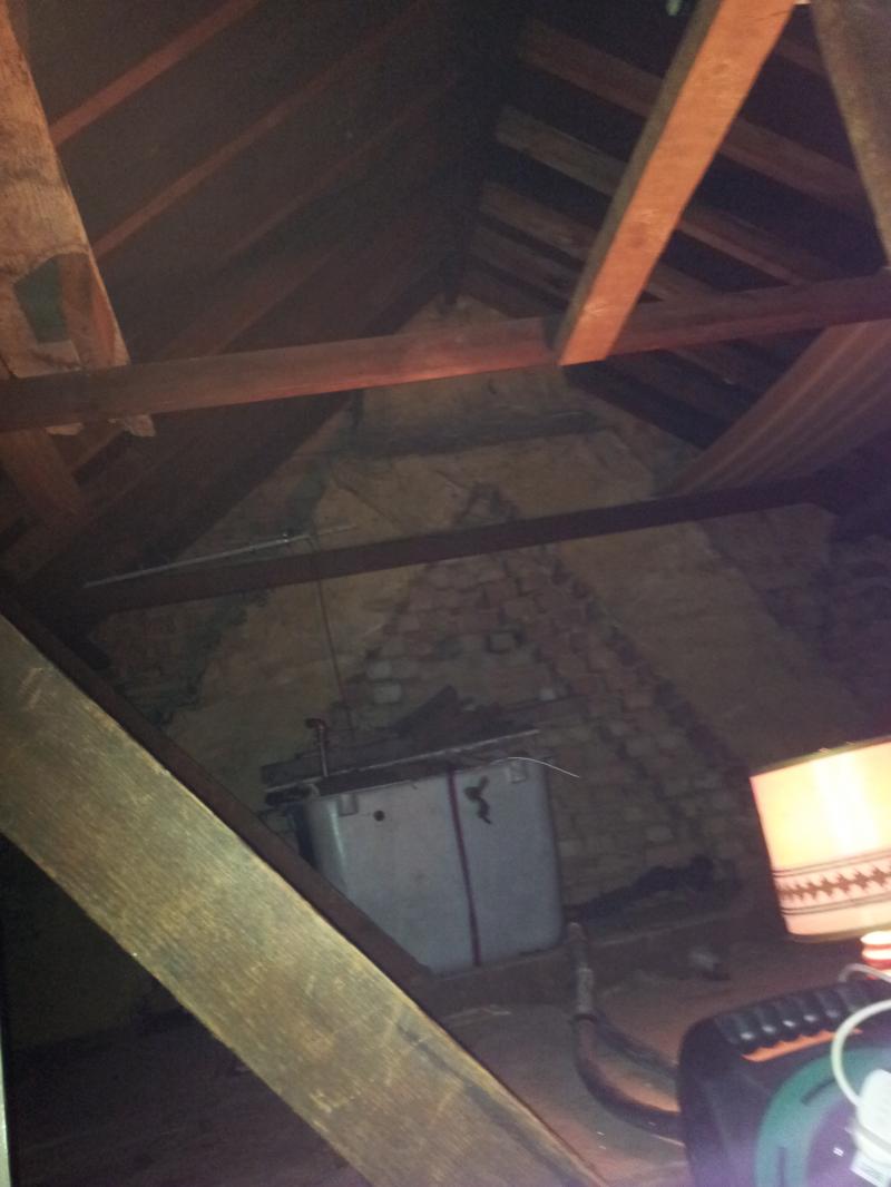

Basically, I need to replace cross bracing, fit a hard floor and put a nice trap door ladder so I can make the loft easily accessible, more spacious and nice to walk about in.
I am comfortable doing the hard-floor and the trap door ladder (which is just a fitting right?) myself - but how much would it cost to get someone to replace the cross bracing? What kind of solutions exist? Is it worth it?

Your photos really dont show alot as well.. try some wider shots of the whole loft space..
Hi Static, I will when I get home, do you have an estimate on "how" expensive replacing them is in an average bungalow loft like this one? To describe it, there are 3 "sideways" planks of wood on each side terminating on a plank of wood on the floor, and there are 3 going across vertically.. it seems there use to be 4 but one got removed (before I bought it). I basically have to crawl up each time, and I can't store some of the larger (long) items I need easily (I am an engineer and have quite a few parts I need to store so they don't clutter my guest room)... I don't have an issue with money as long as it is reasonable.
EDIT: I was rethinking the space layout.. and I only need to remove one of the cross bracing of the 3.. for example it looks like this now:
[ |-|- | ] (one of them removed)
But if it was like this:
[ |___ | ]
It would also be fine, since I can fit all the items I want and can walk around without crawling
Well your description helped muddy the waters, but at best guess you have purlined roof with struts.. cant see any hangers but doesnt mean there arent any.. you also have collars lining up with the purlin struts..
So removing struts (assuming you refering to removing only the middle one) would require the purlin to either span longer distance or be supported elsewhere.. usually done with a steel below the purlin line then either posts or a load bearing stud wall.. assuming you can span back to something solid with the steel..
The collars, well it should be possible to shift them higher and add more.. at a guess every other rafter..
I would guess a couple of thousand for the work assuming its an easy job with no complications..
