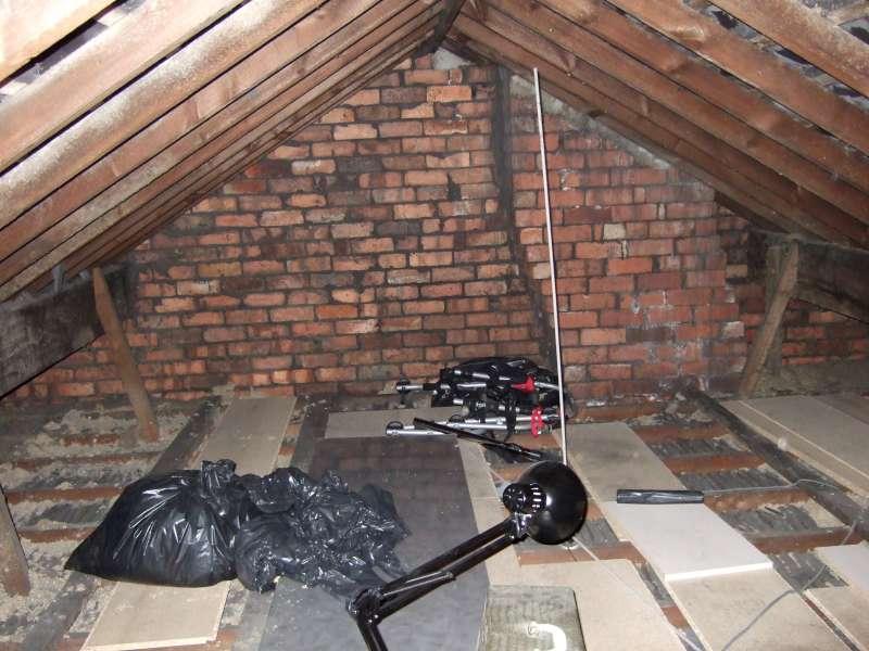

Me and my wife just recently bought our first house. Only been in four months and we're looking to utilise to loft space. Really disappointed about limitations we've discovered but we're determined to make the most of it. We want to use it as an office room.
Age: 85 years old
Type: Stone end terrace.

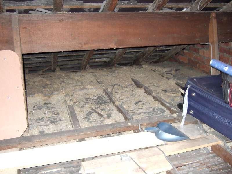

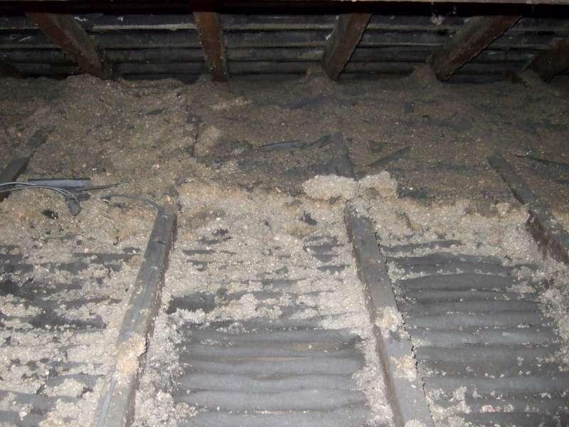

Floor beams are 4cm x 7.5cm with 37cm space in between them.
Roof joists are 5cm x 7.5 and with 36dm space in between them
Height from the floor beams to the central roof beam is 173cm.

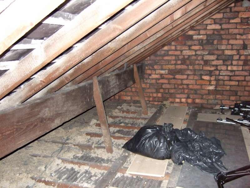

Purling dimensions (I'm assuming the purlings are the massive beams running along the sides) 27cm x 7.5
We realize that the height doesn't meet the regs for it to be an official room, and as it's an end terrace we can't get the roof raised. No one would be sleeping in there and it would be an office room only with one large velux. We don't care about making any kind of profit as we plan to stay here for may years and just want to max out the space potential. We can get 328cm x 400cm of useable space if we can do it, and that's not including any custom drawer space under the purlings!
The floor beams are worrying me though, as this room would be regularly used and I can't think of how on earth I could strenthen the floor beams without getting them completely replaced with bigger beams which probably isn't possible due the limitations of it being an end terrace etc..
I would really really really appreciate any advice anyone could give me on what to do. It would be a damn shame to leave it as storage only.
Yes the joists are to thin for any serious use, a very common issue as they were only ever intended to hold the celing up. What I have done is create a new floor in our house using 2"x6" (47x150mm) timber. Although still not officially good enough for a room, it is perfectly adequate for my liking without raising the floor to much. In our case there is a supporting wall in the center of the loft so the maximum unsupported span is 2m.
I have basically put a length of timber on joist hangers from and to end of the loft so that the weight is taken on the walls not the existing joists on each side under the purlins, parallel to them. I have then attached joist hangers all along this timber beam that are suspended 1" (25mm) above the existing celling, between the existing joists. This means that when the floor deflects a little it doesn't touch the plaster of the celling below.
Basically leaving the existing celling joists with no additional load on them.
