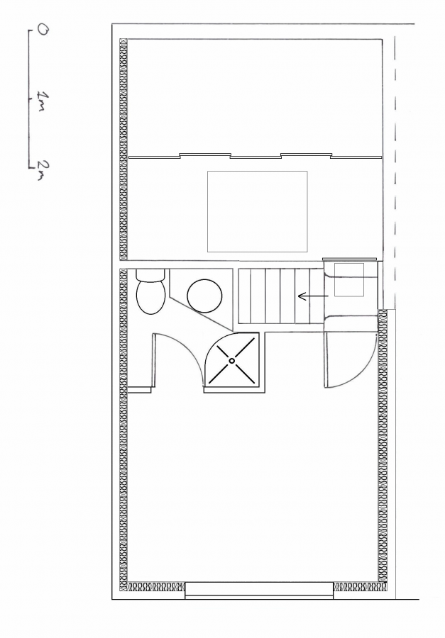

I'm in the middle of having a loft conversion done on a 1930s semi. The building inspector came round yesterday. He said he was happy with everything done so far and doesn't need to come back until the insulation is in. Good news. But then he mentioned fire doors.
Our conversion has a bedroom at the rear with a full width dormer, plus ensuite. At the front, we're going to have a store room. I'd planned a sliding door for the store room as there is not enough ceiling height to install a normal door. More so since he's insited on 200mm rafters. (The structural engineer specced 150s). He wants to see a fire door on this store room, which means hinges. Which means cutting the top corner off the door. I want to avoid this if possible. Do we have to have a fire door on this store room? If so, is there another option other than having the corner cut off?

Here's a sketch of the top floor. Ceiling height is 2.65m under the ridge, which runs across the width of the picture. The door to the front room is at the top of the stairs. There is room for a 1981mm door of about 410mm to open under the slope of the roof. Or a wider door with the corner cut off, leaving 410mm at full height.

Stud wall partition and turn the door 9 degrees so it opens into the ridge ?
If I understand you right, you're suggesting we put a small landing on the left at the top of the stairs and have the door parallel to the ridge when open? That door would still not fit under the slope. You would just swap the open and closed positions.

Why does it have to be a full height door if it's just a store ?
I don't suppose it has to be, its just nice to have. We could just do what the guy suggests and cut the corner off the door. But I'd rather not if there's a good alternative.
Is there such a thing as a fire proof bi-fold door? That would work. Does the door need to be fire proof? We could fit any kind of door then. As a silly example, if we fit a toilet at the far end, does it become a bathroom and non-habitable, so not need a fire door?
It looks to me that that is a room, despite what you choose to call it, and it's still a risk so needs a fire door.
But yes, if you change the function of the room to a bathroom, then it will not need a fire door. Or if you just open it up to a landing.
I've had a bit of a think and had an idea. If we fit a 610mm fire door and we put a velux style window in front of it, the narrow door can just about open into the window recess. No cutting the corner off the door required.
You can get sliding door kits which are fire rated, portman do a few (As im sure others do). Will work out costing far more, however is doable if it works in your arrangement...
