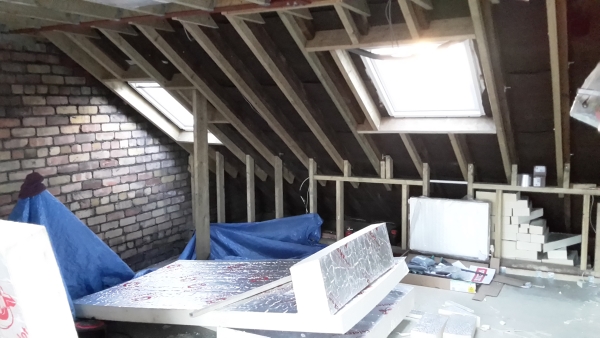

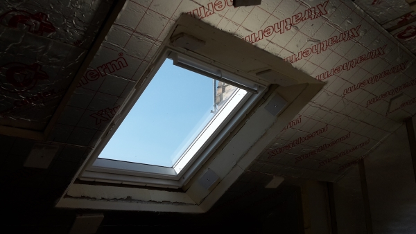

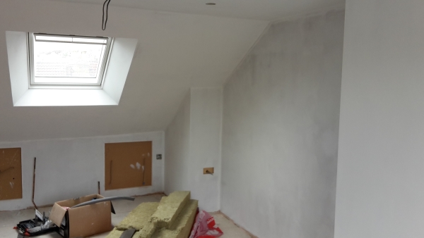

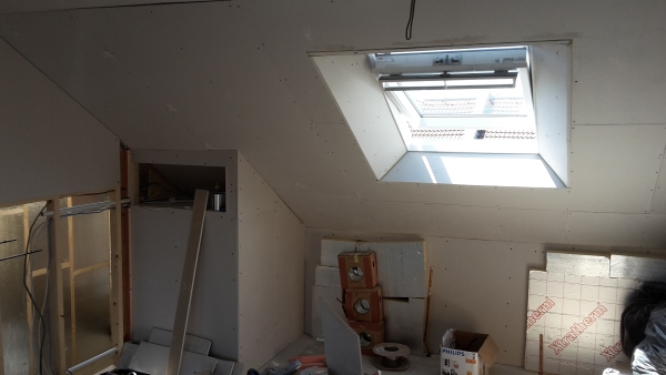

I have a single MK04 in the main part of my loft with dormer. Sounds like you will have loads of light but to maximise it I had the adjacent rafters spaced a bit further apart so I could create a chamfer into the room.

Useless comment?. Are you refering to the fact that the rafters are not doubled up all the way to the wall plate? Presumably it's designed to not need the strength all the way down to the bottom.
The window opening would normally be centrally between the joists, not slightly offset as this one is. Not a big issue though.
theres no support to the left at all (its only supported buy the old rafter coz that header for opening is doing sod all )and when rafters are trimmed to a opening size of 1200 or greater carrying more than one rafter they should be doubles if the opening was left at 780 then no
wouldn't need strengthening to the bottom if the purlin wall had been made correctly and was actually supporting the rafters
