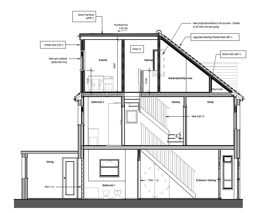

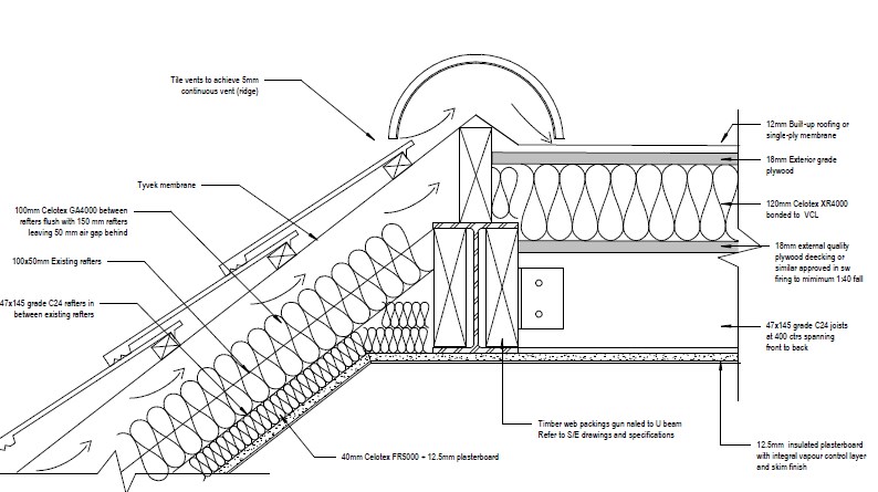

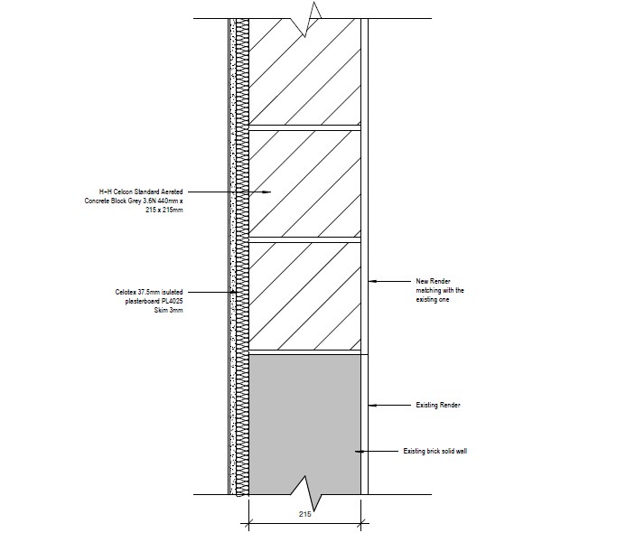

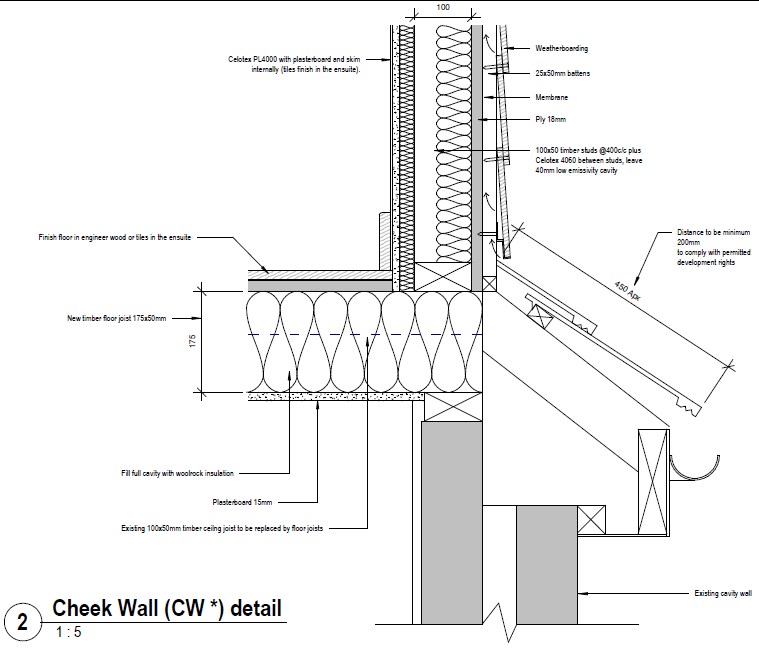

if do not mind I could send my drawings for you to spot check any mistake if is not much
Here you go. I have attached my details. if there ar any good hopefully this would help others on this forum as well
Any comment would be much appreciated.

Just had a quick look, seems OK, have you any floor plans just so I can check means of escape
