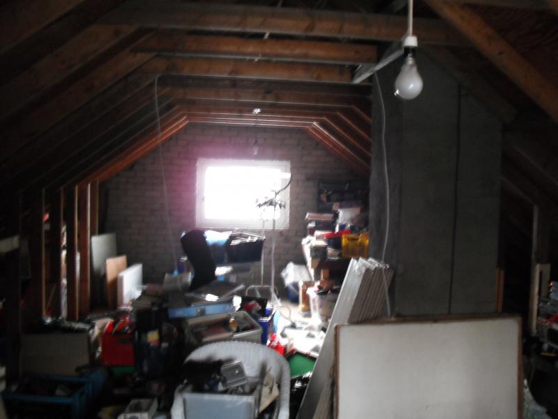

looking at making the loft a bit nicer, hoping it can be a diy job, but trying to find out.
I had a look around planning portal, but i live in scotland, so i looked at my local council planning site and i can't really find anything about lofts so i came to ask you guys.
The main area of the loft is all ready floored, about 1/2 the width, then 1/4 at each side insulated but not floored. Theres a chimney roughly in the middle and the hatch to one side of it, down a ladder into the upstairs hallway.
The plan is to floor the unfloored areas and use these as storage, then insulate everywhere and plasterboard the floored area into a large room, then build a partition wall along the chimney to split the attic into two rooms.

the floor is made up of 150mm x 50mm joists. Is that suitable for living on? what size should they be?

Depends on the unsupported span and spacing of said joists. What's the length of the joists and how far apart are they?
joists are 5.5M wall to wall, about 550mm spacing, although on one side they are doubled up width wise for about 1.2m
For 150mm x 50mm sized joists you are way over your permitted span there for a domestic floor - so the answer is no the joists are not the right size. They are considerably undersized given your span and centres.
550mm spacing, 5.5m wall to wall........? any chance of a photo of the inside of the loft?
if youve got 150x50 joists with that span with no support along them at all.i wouldnt do any more to the roof.if you want to do what you propose you need to get a SE out to tell you how deep your joists need to be.
The area was all ready floored by whoever built the house.
Is my house going to fall down?
well i wouldnt panic with whats up there at the mo as its still standing but i wouldnt do any more to it with out getting a SE in.
