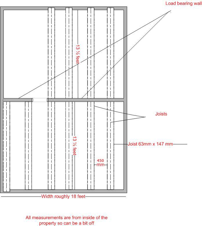

I am considering getting my loft converted and use it as a bedroom. I want to know if I will need to install new floor joists to support the load of the new room.
The size of current ceiling joists are - 147mm x 63 mm - The gap between the joists is 450mm. There is a load bearing wall in the middle of the property. The joists span across this wall for 13 1/2 feet on both sides.

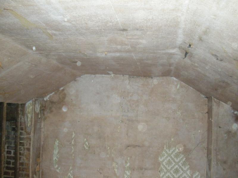

The plaster boards have been taken off. There are also signs of torn wall paper on one wall. This work is at least 10 year old, that’s before we have been living here.

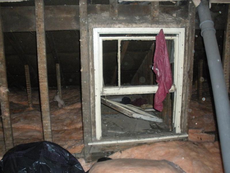

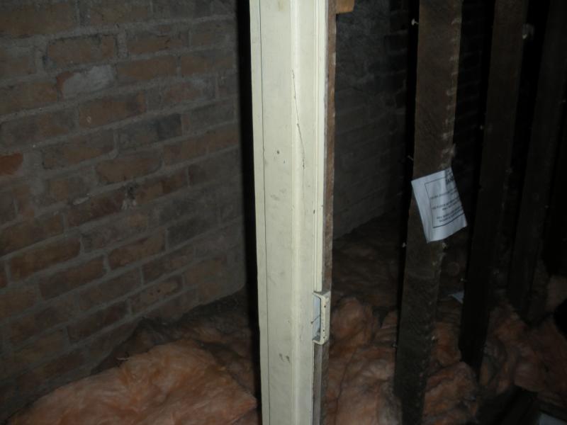

There is also a window frame (there isn't an opening on the roof) and a door frame in the stud work. Can someone look at the attached pictures and maybe date the materials used on the window and door frame.
The window in the loft looks same as the bedroom windows of the first floor bedrooms (now changed to PVC double glazed). The house is a 1950ies mid-terrace.
My main questions are that, will I need to get new joists installed? If so, what size? And would I need steel beams? Could I just use the same size joists to run along the ones already in place.

How large is the floor area going to be?
In summary, you need a new b/regs application and they will determine if the joists and beams (and anything else) are suitable

The useable floor area will be 15 1/2 foot x 11 foot. All of this area has clear head room (with the current joists)
ive just finished a loft conversion and my inspector insisted on 7x2 joists .... was my first time at anything like that before but was quite easy really... helped that i had a good inspector aswell...

Looks odd to me.

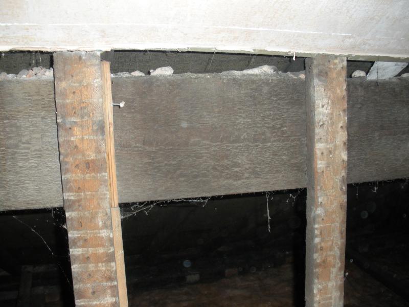

The marks on the timber indicate lath and plaster - very old.
The window looks to be in the wrong place to have ever been used.
The door frame could have been access into the old roof space.
Apart from the window very like the last house my parents had, it had been built with rooms in the loft (for the servants). Was built around 1880.
It is possible that this house was built like that - how old is it?
Yeah it does look quite odd. The colour (determination) of rafters and stud works looks exactly the same.
Well the window does look odd, but other side of the windows is enclosed with timber on sides and top, so it could have been used (only need to remove the roof slates).
The door frame is in perfect place for entry and that's where I would install the staircase. The beams are already cut where the staircase would have been and new much thinner timber is placed and plaster boarded from underneath. On second floor this area is now an ok size cupboard. So I get the feeling a staircase or some means of entry must have been there at some point.
