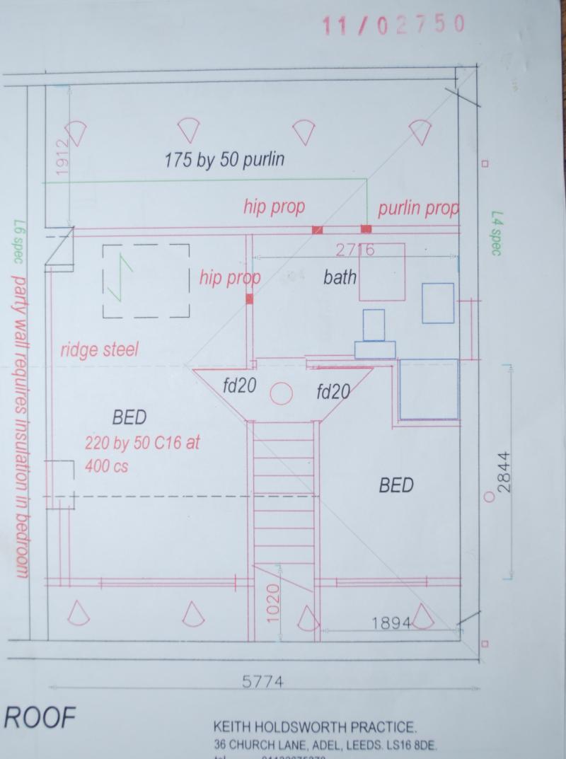

Im doing a loft conversion. I have the steel in but just need to know the minimum joists I can put in. The plans say 9" but is 9" the minimum?

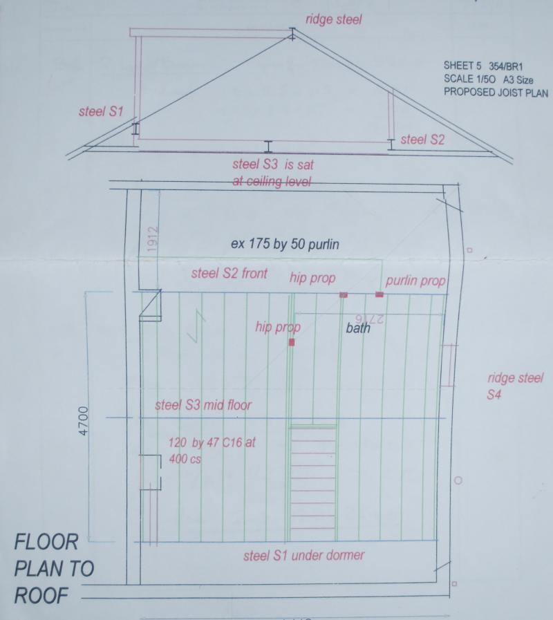

Depends on the span and spacings of the joists. And whether or not any of the joists carry any extra loads from dormer walls and the roof.
Can't say without that information, but as an idea, you'll get about a 4.7m span from 9"x2" C16 joists carrying domestic loft conversion loadings, at 400mm centres.
If you give us some more info, we can give you a better idea of what you need.
In that case, without the middle steel, the span is 4.7m so 9"x2" joists are the minimum if using C16 timber.
Although, if you close up the centres to 350mm and use C24 timber, you will get away with 8"x2" joists. Don't know if that is of any help to you?

If you look at this again.
Why would the architect want me to keep the old hip and purlin and prop them up? I have ripped most of the old roof totaly off.
Presumably that section of the roof is not being altered? If so, they may have decided it's simpler to leave the purlin where it is rather than allow the rafters to span onto the dormer wall and then put extra load onto the new beam.
Although obviously some load should have been allowed in the beam design due to the prop to the hip member and purlin.
If the rafters could span to the dormer wall and be supported by it, then there's no reason not to remove the purlin. The beam will however then be loaded differently and would need to be rechecked for capacity.
