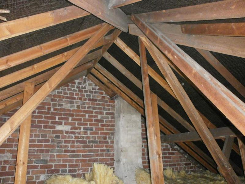

Hi All,
I need to relocate my loft hatch. This will involve cutting one of the ceiling joists. I understand that i will need to double up on the trimmers. Is it ok to do this with the roof that i have:

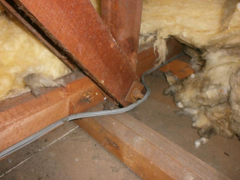

The roof has 2 larger joists in a cross formation accross the loft which go above the ceiling joists:

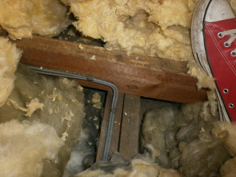

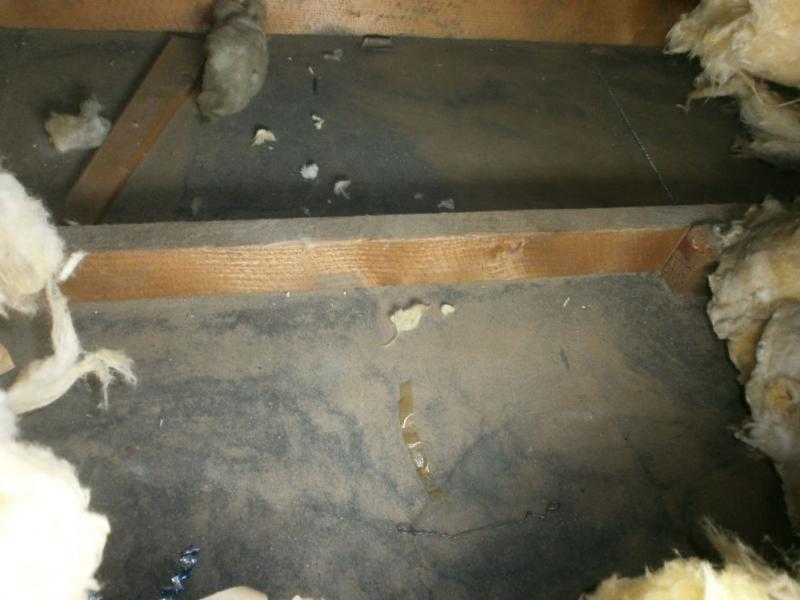

I am wanting to cut the following joist - this is not one of the larger roofing joists but next one up is - which is where the loft hatch will be attached to:
Does that sound ok - or could it cause problems?
You should not have any problems cutting one ceiling joist out. I would screw a piece of 3x2" either side of the opening you intend to cut out before you start to keep things stable until you have your new frame work done.
