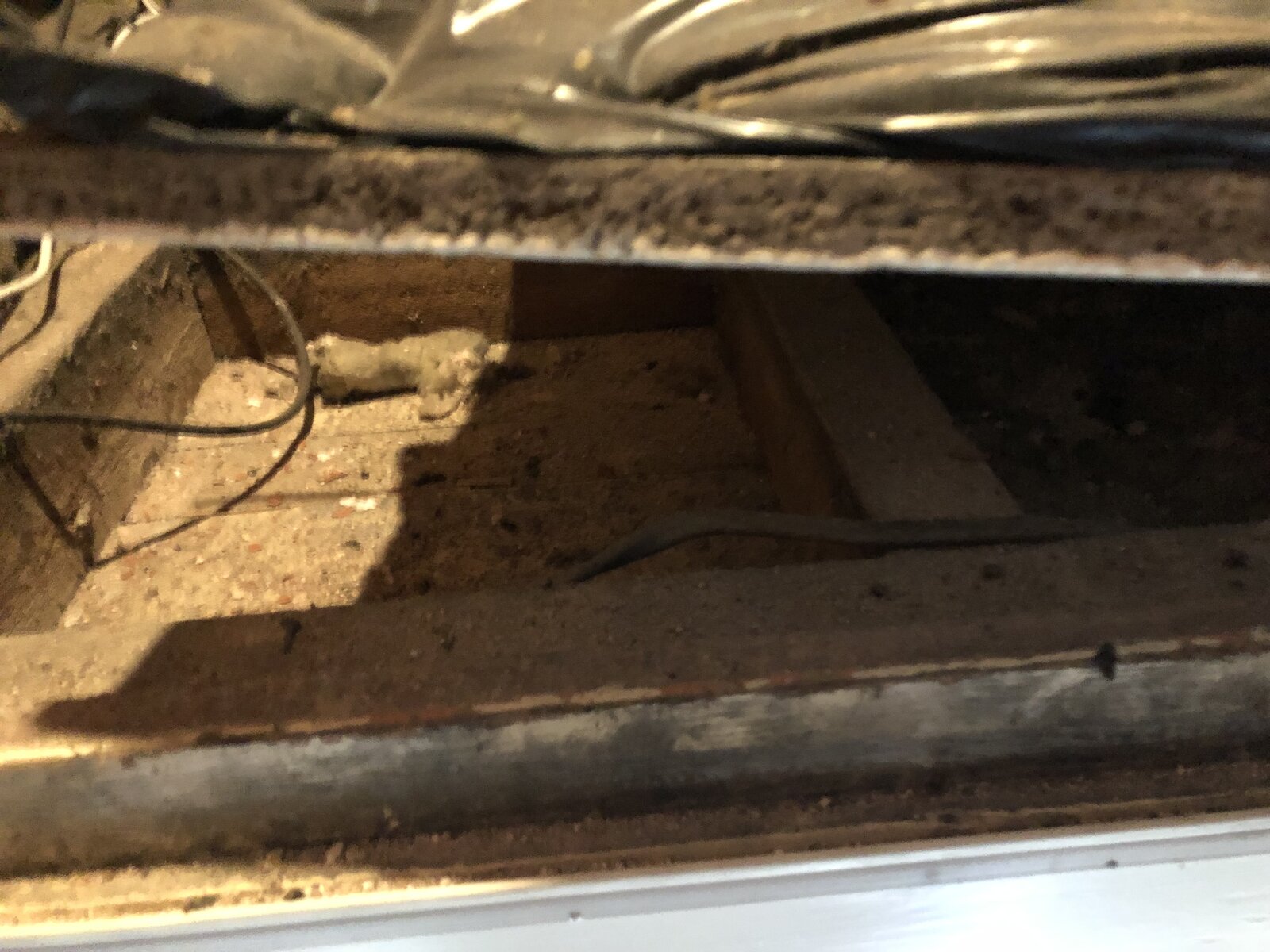

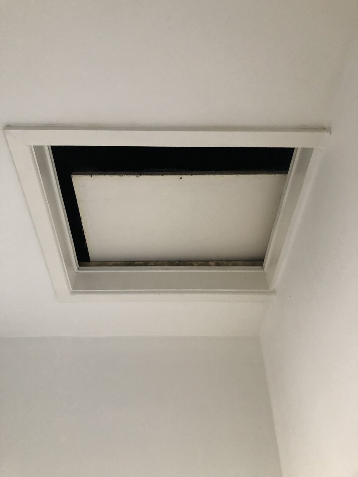

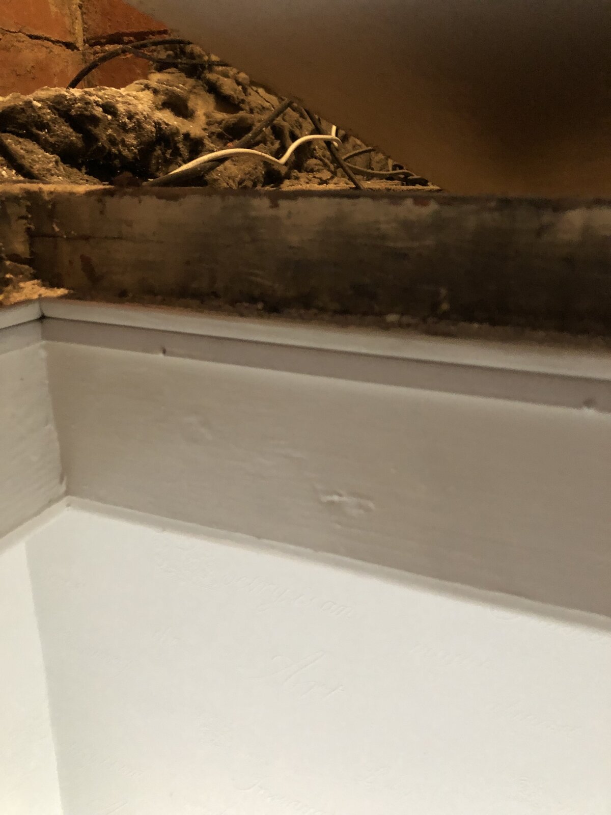

Currently have a loft hatch that is just a lid that you push up and move out of the way which you have to do off some step ladders. I'm wanting to change this to a pull down hatch with ladders if possible to make access easier. The house is 1930's so not sure if my existing loft size is going to be an odd size, I've measure the hatch lid and it is 670mm x 570mm, the floor to ceiling height is 2750mm. I've poked my head into the loft and took some pics (below), the joists are 50mm thick and I have measured the joist distances which are 825mm (outside edges) one way and 725mm (outside edges) the other. Not sure how easy it would be to convert with the hatch currently being up against one wall. I've had a look on screwfix and saw a Manthorpe drop hatch but dimensions are bigger than my cutout, is my hatch an odd size? Can someone give some advise on how to do this please.

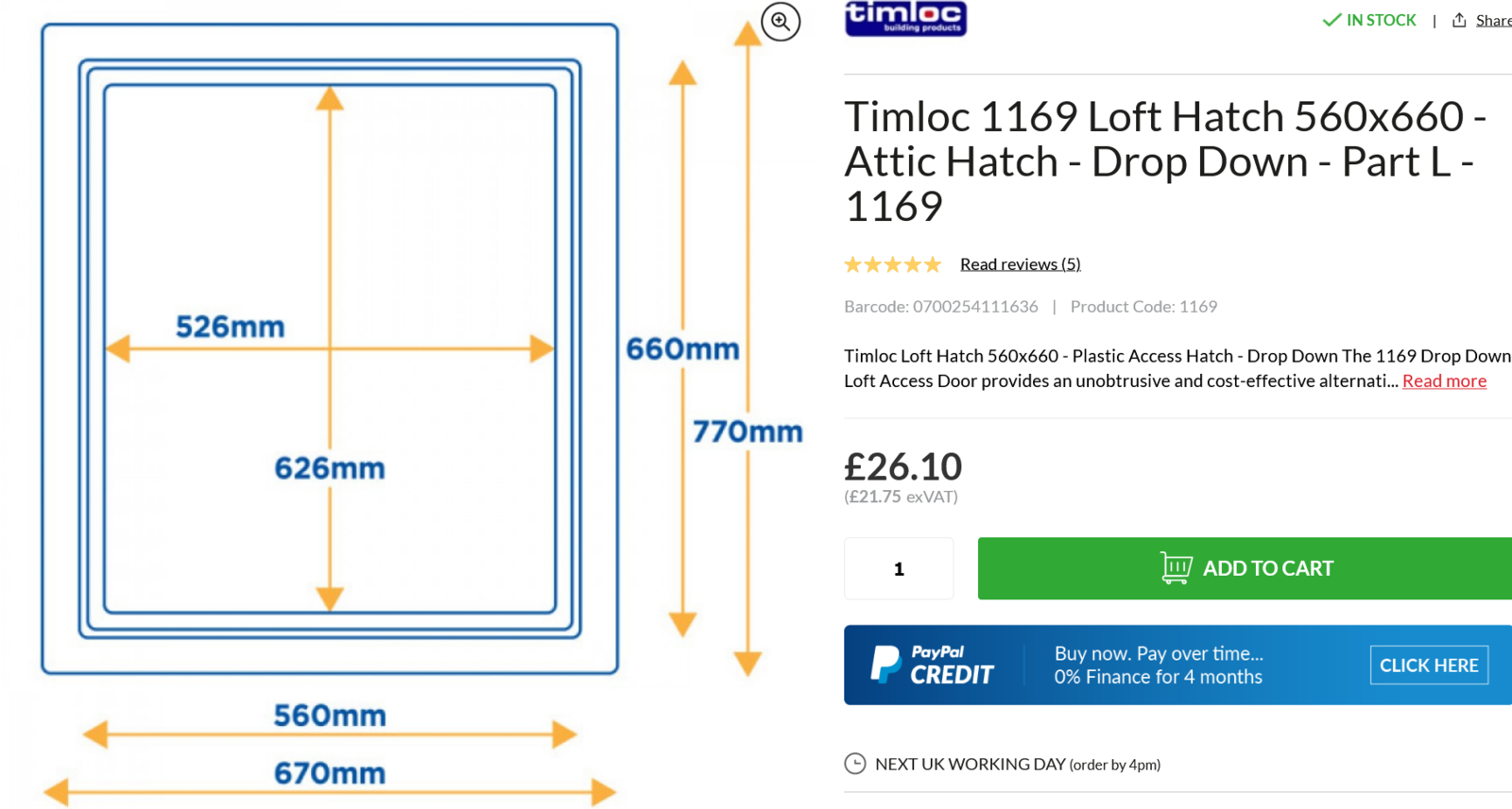

yeah thought it may be a case of having to modify existing joists etc to make hole the right size, was hoping to avoid that. I found a drop down hatch last night on google called "Timloc 1169", the dimensions given look like it would work and all I would have to do is remove the archatrive and fit this. The door is plastic and not capable of having loft ladders attached to it however I've seen loft ladders that can be attached to the joists so you just drop down the hinged door and then pull down the ladders.

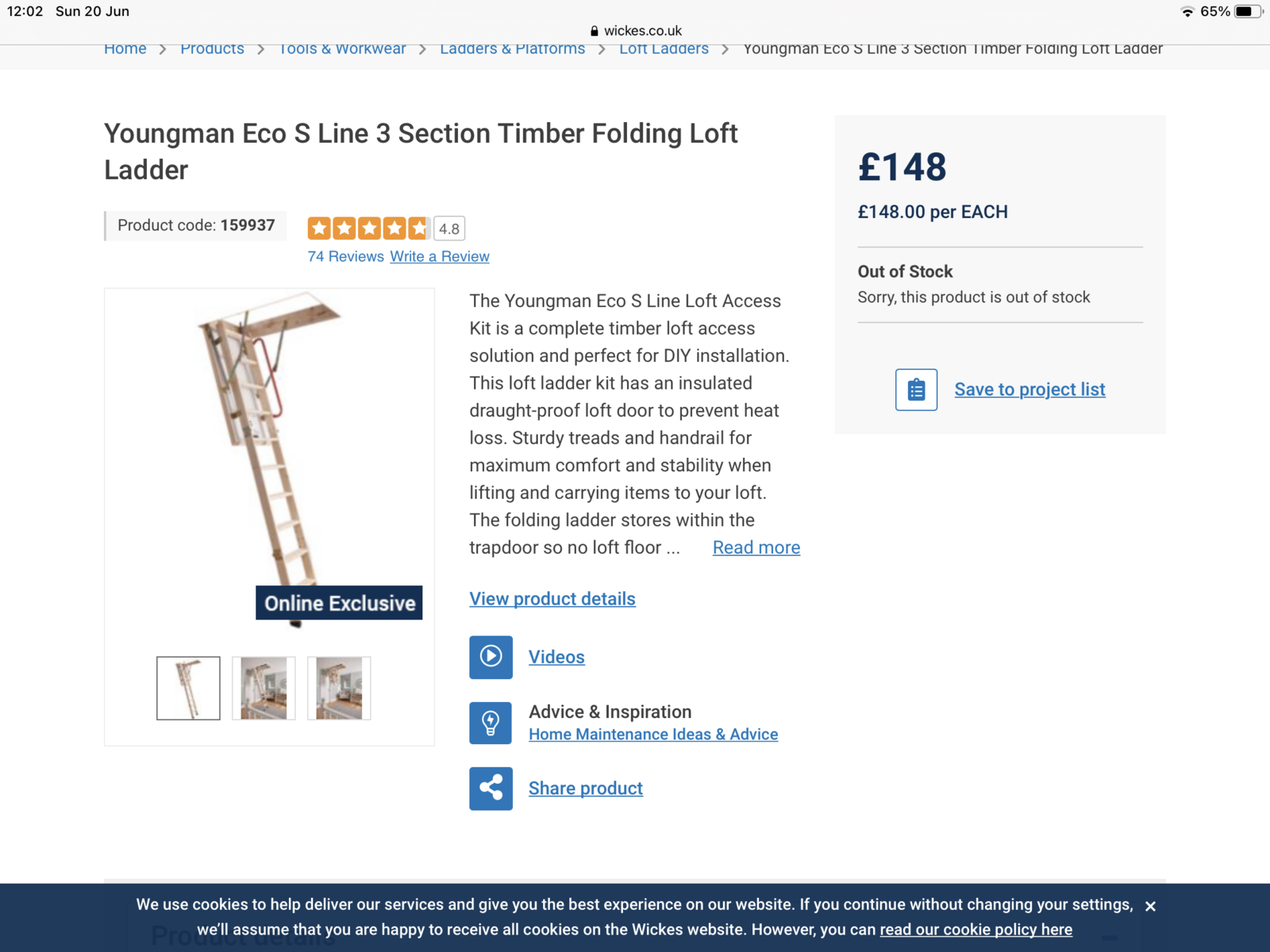

51636D5B-268F-4AEC-8BB3-DDE897169FF0.png I fitted this type in my 1930s house , because the ladders just fold onto the hatch you don’t have to worry about obstructions around the hatch …
